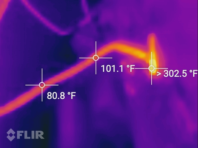

Used to run a 17 on a Lincoln 185. That torch would be near intolerable to hold at the end tail where the hose comes in at times for me at least.
My hands got used to holding it but anyone else is the shop said they couldn't do it. Mind you I was redlining my 185 on nearly every job since it was under powered for what I was doing.
Wasn't too hard to retrofit a water cooler onto my machine though of your interested in going down that route it's actually quite simple with a couple adaptor dinse blocks and what not.
Will try and dig up a flir picture I took of the old torch
