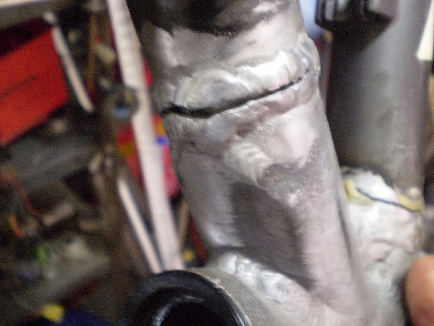

any advice will help , someone weld this and he came to me for cure

Oh boy that looks like some fun you've got there.
Do they expect the repair to look like it never happened or are they okay with a weld bead @ the break?
Also do you have the room once assembled to have a piece of tubing slipped in between the broken bits for strength?
Looks like aluminum filler on magnesium base.

well i say thats had its day.
it looks like a few different repairs by different people on that (there is a nice bead in a place there should not be one).
the metal is probably screwed by now.
it looks like it was a cheap bike going by the cheap repair job done on it. so its more than likely not worth the cost of fixing it properly.
to fix it properly would be to make a whole new front piece machined from scratch and have a backing tube inside the joining tubes.
even then you could not guarantee the tube won't break further along.

just reading up a bit on bike frames and aluminium alloys.
i see bikes frames are often 6061 (requires heat treatment) or 7005 (no heat treating but requires aging).
one of the problems with 7005 (as with all 7 series) is they are somewhat susceptible to "hot short" cracking as shown in the pic.
you need to use the correct filler. 5356 helps with stopping the weld cracking but 4043 (or all 4 series filler) can cause it to crack.
so if someone thinks its 6061 and uses 4043, then i would expect it to crack as the pic shows. downside is it would be very difficult to remove that contaminated aluminium, so the part is basically scrap.

Bin it. Regardless of the repair approach, the integrity of the tubes is shot. The ONLY possible means of a proper repair is to cut the tubes from the seat post and bottom bracket, use a new headstock, and install new tubes. Cheaper to buy a new frame.
Unless that frame is a vintage, high-end model, it will cost many hundreds to repair it properly. A new inexpensive ally frame is under $300 in most places. Or swap to a modern steel frame.
Do that customer a favor and hacksaw that into 20 pieces to save him/you from injury and liability.

i think you missed the point.
if its made from 7005 then Si12 will not work. 5356 will work and more importantly work on both 6061 and 7005.
hardness has nothing to do with it. its all about the alloy make up which makes it prone to cracking.

Hmmmm, repairs like that should not be done at all. The root cause is obviously harsh enough to break it in that spot from new and a repair will be much much much weaker, unless you add more bracing and then its not worth it. Its not so much a matter of how at this point, rather whether you should repair.
That is really only repairable in theory, in reality it is both too expensive (for a bicycle frame) and risky to bother with.

i don't know of any method to work out what grade it is.
however a quick google shows 6061 and 7005 being two common bike frame material. use a filler that works with both.
but the bigger problem is that by the time you cut out all the contaminated material, there is nothing left to weld back together.
cost of machining new parts, plus welding, treatment etc, you could probably buy a whole new bike.

your right on the money, you never really know what it is.
if its a generic brand name bike its probably safe to assume that its made from the standard alloys the industry uses.
i think its simply a case of using a filler that is less sensitive to "hot short" (solidification cracking) which would cover both alloys.
the hard bit is, is it safe to do that repair?
how strong is it going to be if its not heat treated? not aged?
in this case, because someone has clearly used the wrong filler (which is why the weld is cracked through the centre), its contaminated the metal and not worth repairing.

I informed customer today that bike frame cannot be repaired.

tweake wrote: ↑Sat Nov 20, 2021 8:43 pm in this case, because someone has clearly used the wrong filler (which is why the weld is cracked through the centre), its contaminated the metal and not worth repairing.
I’m not sure I would agree with your assessment that the incorrect filler was used which caused the cracking. If that were true, the weld at the headstock should also have cracked. What I believes is far more likely is the “repair” was surface level puddling only, with no penetration into an already weakened stress joint. If the underlying crack was still present, than any type of ally filler will crack through. This is the significant problem with ally repairs- cracking.
Not all ally frames are heat treated afterwards either. Some definitely are, many are not, which tends to create these stress problems. And those that are tend to be in the higher price ranges, made from 6000/7000 alloys.

Definitely will not be repaired , too much the risk the metal is burned and contaminated due to overwork in a form of badly "washed" technique , there is not time for shizz and giggles but you are correct it had no
penetration weld was like decorative rather than it should had been.Metal filler was also an issue .
