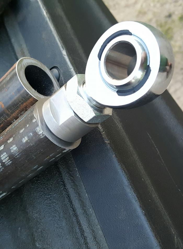

Hey guys got 8 weld up 8 4 link bars to a mild steel bung. The tubing is 1/4 is wall 4130. I am going to put a bevel on the tubing. What preheat would you guys recommend for the chromoly? And should I tack then preheat or am I better off preheating then tacking and welding?

Ya I went and got a 300 temp stick and 400 temp stick so I don't go over interpass temp, cause I will have to do 2 passes. They are 4 link bars, not horribly critical but still want to do it right. My concern about post heated that hot is distorting the threads. I disassembled the Hiem joint so I didn't wreck them with the preheat but still kinda worried about the adopter threads. Think I will find a bolt with the same threads and screw that in during the preheat and weld. I think I will just let them cool on their own.

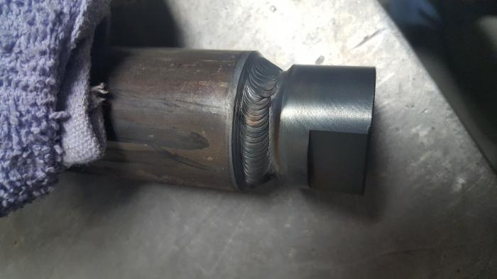

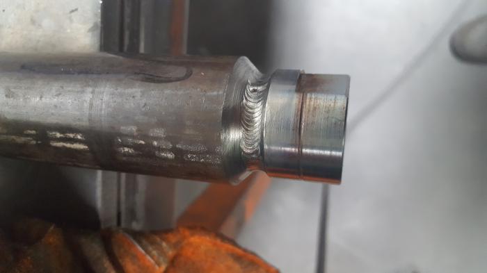

Got them all done tonight. I fitted the adapter with a 1/16 gap, kinda like a socket weld, so there wouldn't be any shrinkage stress cracks. The first one didn't go great at first, the root cracked on me, so I had to grind it out and do it over. I figured out that dipping fast on the root works much better and I got no cracks. At first I tried to space the dips out further and that's when it cracked, think I was getting to much dilution. After the root I did 2 fill passes and then a weave cover. Next time I won't do a 45 degree bevel on the end of the tube it took a lot of fill, mayb like a 20 degree instead. But I think they turned out pretty good for never having welded thick chromoly before. I let the part cool back down under 400 each pass. Took a long time. I think it took like 45 minutes a part. Had a adapter on both ends. Was a lot of fun and hope to get more on this kind of work. Where do you guys find preheat charts?
