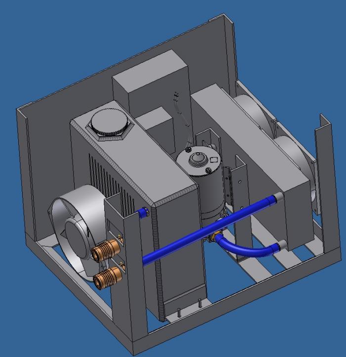

I'm in the process of building my own TIG cooler right now. It will probably look like this:
I am using 12V shurflo membrane pumps, which are designed for continous operation.
To be honest, this will be the second version of my cooler. The fist one runs okay, but my pump is at its absolute limit, pulling 1 Amp obove it's specified limit due to my large radiator (small pipe diameter = high flow resistance) I used. Here's a picture of my first prototype:

Nice design there. What is that type of radiator?
Im gonna add temp guages too

The radiator of my prototype (second image) is one used for PC-watercooling. It's the model MO-RA3 http://watercool.de/en/mo-ra3-0
The problem with this radiator is, that at a certain flowrate the flow resistance becomes very large and therfore a lot of pumps tend to be at their limit. I used this big radiator with the intention to to be able to use low noise fans with low air flow rates. But the problem with the pump being at its limit was severe, therfore in my new design I chose a much smaller radiator with lower flow resistance but increased the air flow rate using bigger fans. Hopefully this will relieve the pump at its given flowrate.
