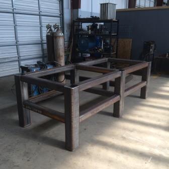

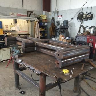

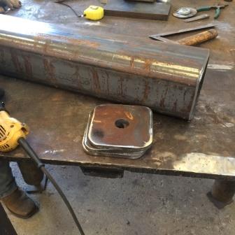

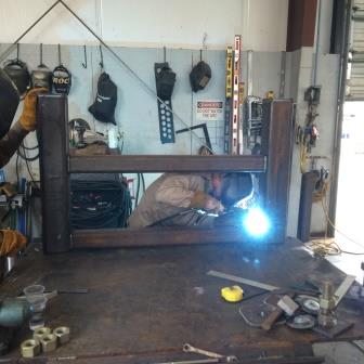

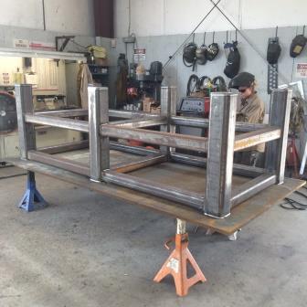

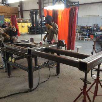

For 8 years we have had a 4ft x 4ft welding fab table that worked out but just wasn't big enough for the new builds we were asked to do for operations, the shop manager cleaned up the yard and 6 loads of scrap later we had the funds to build a new layout/fab table
These are some of the photos of the build we did this week and the final assembly, the top is out of 1in A572 grade 50, (should have went with 2in but $2400 was a little high) legs are 6in x 1/2, braces are 4in x 3/8, welded out with 045, GMAW

Very nice, indeed! The top is thick enough to remain flat even after the welds at the posts.
This is the weakness of our work tables... The one who designed them spec'd 1/2" tops sitting on posts with an angle iron frame, stitch welded both sides of the angle at 6 on 18", so we don't have a flat table in the shop. This is "relatively minor" with the work we do, but for some tasks it's extremely annoying. I've even grabbed a full- or half-sheet of 3/8 plate and set it on the table when I need "very flat", but that takes some shimming across the table to keep the 3/8 from sagging with weight on it. Major PITA!
