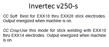

Im using a Lincoln machine at school, training for pipe, uphill and down. I have never used a machine with soft/crisp arc settings before. I have noticed quite a difference when switching between the two. But I am curious to know, when is the best time to use one or the other? For what applications? Under what conditions? Root, filler, cap? Sturctural, sheet, plate? Groove or fillet? Is there even a rule to follow? Advice for my current training would be helpful for now, unless there is some kind of guideline to follow for when to use one or the other...
Thanks,
Jake
Look up the machine's manual at the Lincoln site - it'll tell you how that particular machine is designed to work.
Here's my Invertec v250-s, but others are different.
- invertec crispsoft.GIF (8.29 KiB) Viewed 8001 times

MinnesotaDave wrote:Look up the machine's manual at the Lincoln site - it'll tell you how that particular machine is designed to work.
Thanks! This helps a lot!

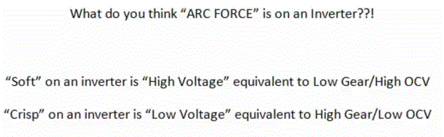

Soft is lower volts higher amps cusp us higher volts lower amps, i prefer really soft settings on cap to reduce chances of undercut.
forrestderp wrote:Soft is lower volts higher amps cusp us higher volts lower amps, i prefer really soft settings on cap to reduce chances of undercut.
Watch this video.
Its kinda different than your explanation...
https://www.youtube.com/watch?v=fvZGxFs0bJQ
DylanWelds
- DylanWelds
Location:Washington
I'm a pipe welder and I've come to like using crisp much more than soft. It just works better for me. I used to use soft with negative arc force for 7018 but I just use crisp with 0 arc force. I can get everything to look much cleaner on crisp, it's like the puddle is just way easier to control for me. But there are a hundred ways to skin a cat, whichever works for you. I'd just get some coupons and screw with your settings until you find out what you like.
DylanWelds
- DylanWelds
Location:Washington
Yeah I believe he got it backwards.AKweldshop wrote:forrestderp wrote:Soft is lower volts higher amps cusp us higher volts lower amps, i prefer really soft settings on cap to reduce chances of undercut.
Watch this video.
DylanWelds wrote:Yeah I believe he got it backwards.AKweldshop wrote:forrestderp wrote:Soft is lower volts higher amps cusp us higher volts lower amps, i prefer really soft settings on cap to reduce chances of undercut.
Watch this video.
From the video by FieldRes:
(inverter compared to SA-200 settings)
- soft and crisp inverter vs sa200.GIF (23.31 KiB) Viewed 6688 times
