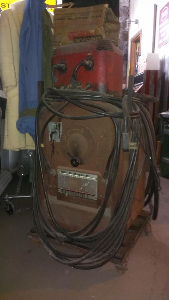

Can anyone help identify this welder. I know it's a Lincoln IdealArc of some sort, but can it do DC?
What is that red box on top? What would it be worth?
I'm not looking for another Buzz Box.

$300.00 If it is setup for TIG with a footpedal and everything works properly.
I found a deal on a 900lb monster, but I wasn't looking for a monster.
The $300 offer will soon be gone, so this is just for a few days.
Yes, I want to be able to TIG with a HF unit as well as stick. i.e. I can't pay $300 for scratch start.

From what I'm seeing, it's the AC model only. I wouldn't waste time on it since you want a full featured, fully functioning welder.mbmalone wrote:Can anyone help identify this welder. I know it's a Lincoln IdealArc of some sort, but can it do DC?

Already has built in high freq, a pedal, the torch, a water cooler, cables.....$300 is a steal for all that and a working welder.
In my opinion

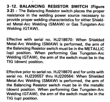

That's called the Balancing Resistor Switch.
- image.jpg (87.51 KiB) Viewed 3168 times
Miller sent me the manual "iom340_ K202691-L230930.pdf" which shows a Miller.
My Serial begins with a "K", but I still don't know if we are the same age.

I appreciate that attachment. It was very confusing considering what I had been reading in the forum. The guy I bought it from never stick welded.
