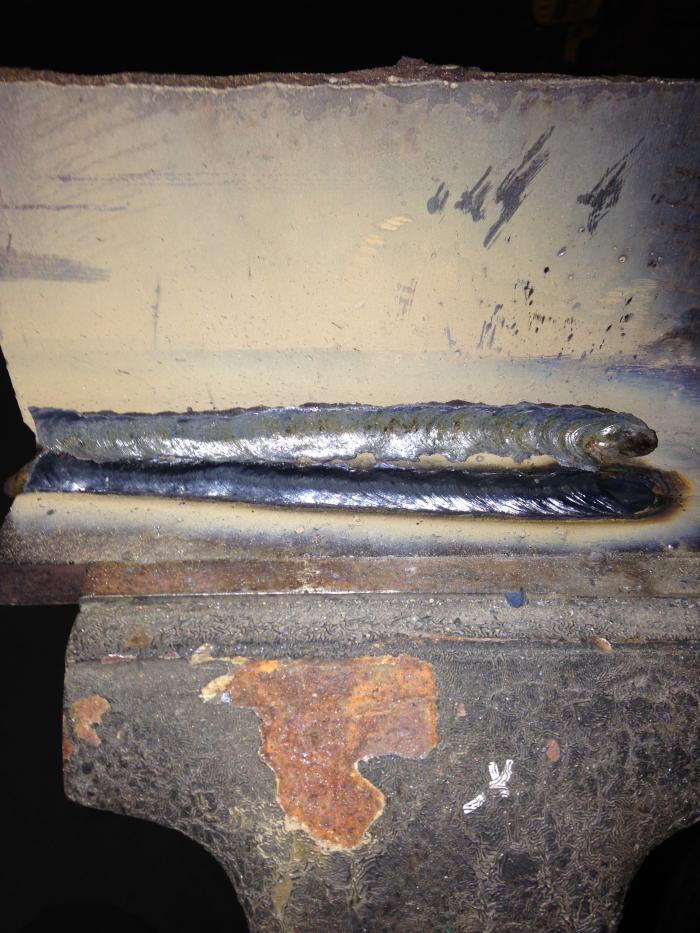

I fired up some second hand 7018s that i bought from a trailer/ hardware joint. They look good, but dont weld well at all. They must have been out in the rain or something, because i have used 7018s that have been out of the oven for ages and had no dramas. (bottom pic)
I got out some 4 mm devil rods and had a go on the same settings. (top pic)
Guess id better put the supposed "angel" rod into the oven for a while.
Mick

Mick, if there's a thin layer of rust under the flux, no amount of oven time will fix them. The flux holds moisture really well. The morning dew is enough to do this if someone left them out at night.
My favorite is discovering 308/309 has been wet. Get about 2" of rod burned, and the trapped moisture boils. The flux "explodes" off the rod like popcorn popping...

You have proved 1 point there Mick....
That you need to buy good rods, and take care of them....
Get some Cigweld Ferroweld 61....

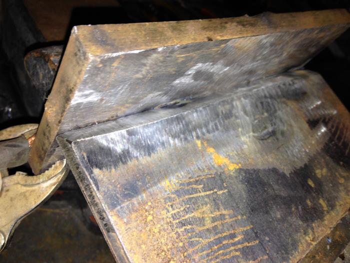

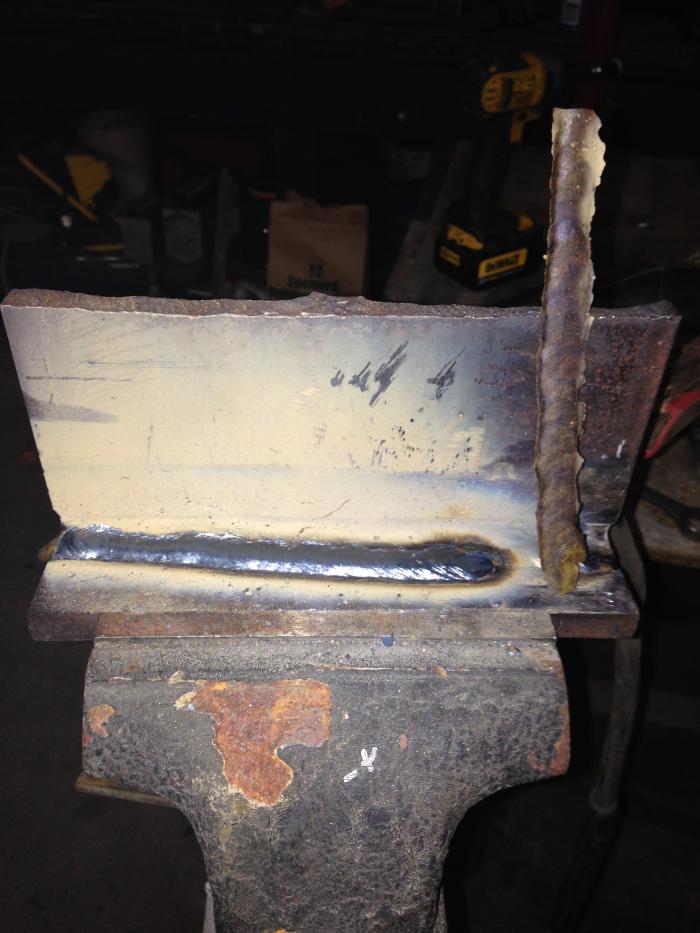

They cost $16 usd for the 11lbs of 1/8 e7018....prolly yrs ago.
I got them for free.
They do awesome 120amps on 1/2 in steel.
I've got pics.
Tomorrow.

Good stuff.
Must be old, $16 for 11lbs....
