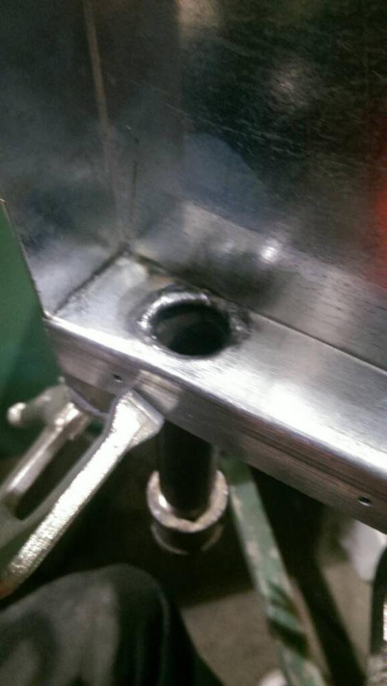

That's actually something that I do after I weld on the drain pipe and finish all the edges. There is a cold galvanizing spray I coat my welds with. I found that the sheet metal is so thing, removing the zinc coating from both sides leaves me with little materi to work with and I don't want to take away from the strength of the pan, have it just fall right out.

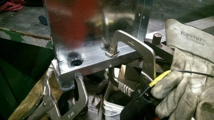

What I found yielded the best results was just putting a wire wheel on a diegrinder and zipping up the area, fit my pipe and put aluminum blocks behind in the corners and blocking off the hole, and a thinner block on top of the pipe to close it in and bessy clamp them together and hit with the wire brush again. I have my gas way to high so I waste a lot but it seems to keep a nice atmosphere around my tip and less pops.

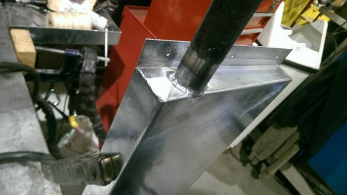

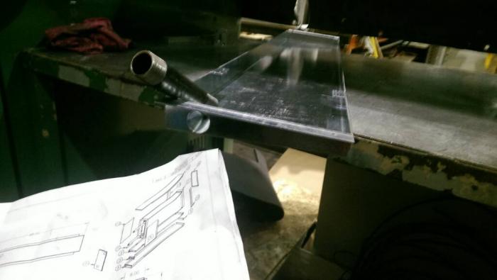

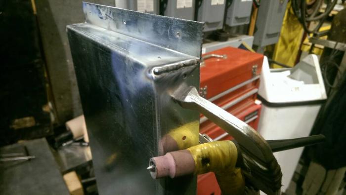

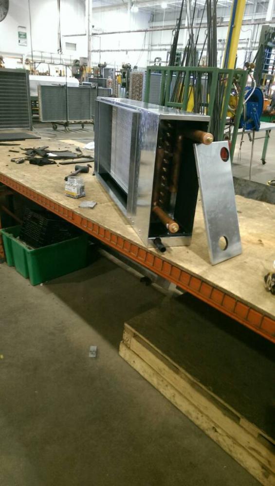

Did up another drain pain for a coil housing. Have a larger ss pan for tomorrow morning and then build the framework, mount the fans and wire it up.[attachment=-1]uploadfromtaptalk1400194257234.jpg[/attachment][attachment=-1]uploadfromtaptalk1400194274330.jpg[/attachment][attachment=-1]uploadfromtaptalk1400194292302.jpg[/attachment][attachment=-1]uploadfromtaptalk1400194310234.jpg[/attachment][attachment=-1]uploadfromtaptalk1400194328659.jpg[/attachment][attachment=-1]uploadfromtaptalk1400194342794.jpg[/attachment][attachment=-1]uploadfromtaptalk1400194357507.jpg[/attachment][attachment=-1]uploadfromtaptalk1400194378400.jpg[/attachment]

Yes it was a success. Cold galvanized the weld and coated the inside with an asphalt spray incase there are any cracks in the bends or joints. I have a respirator and a fan blowing the fumes away, but thanks for the concern. Making up one out of stainless now, will have pics for criticism, so feel free to input.
