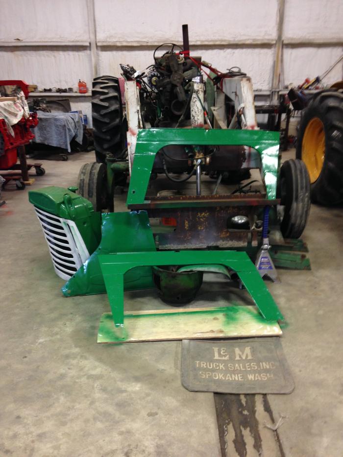

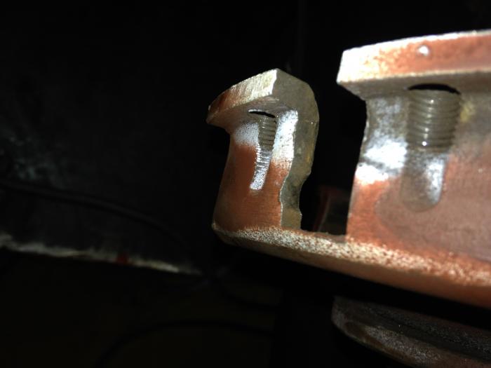

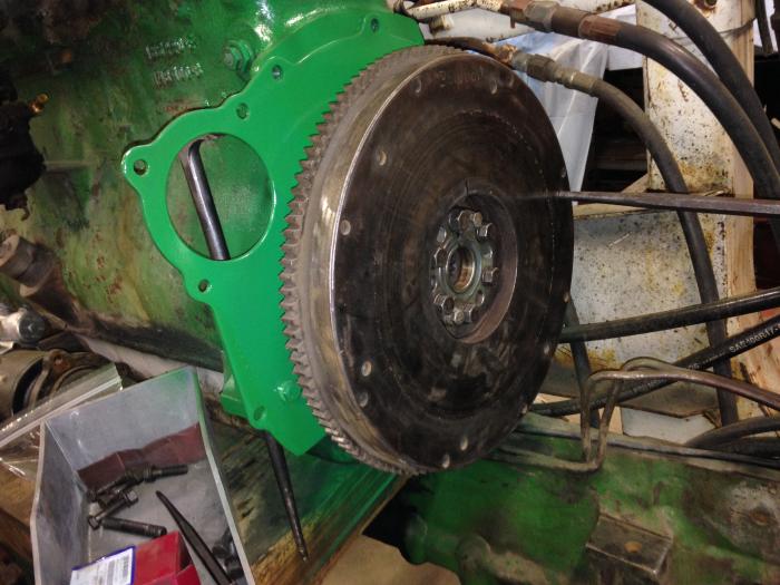

Goes on a Oliver 770 farm tractor.
This clutch system was installed incorrectly by the mechanic before me....
you would push the clutch halfway down and it would disengage, push it to the floor, and it would engage again....
Instated backwards, loose bolts....
A mess, but, should be back and running by the end of the week.

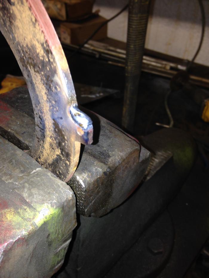

I had to repair a clutch on an old Massey Ferguson 235. I was dragging the pasture and went to down shift before going down a steep hill and when I pushed the clutch pedal down it popped and the pedal went under the tractor and was gone. I shut the tractor down and got to looking and saw that I caught the bracket that holds the pedal to the tractor on a stump and broke it so I had to weld it back on the tractor. That was a fun drive back to the barn without a clutch.

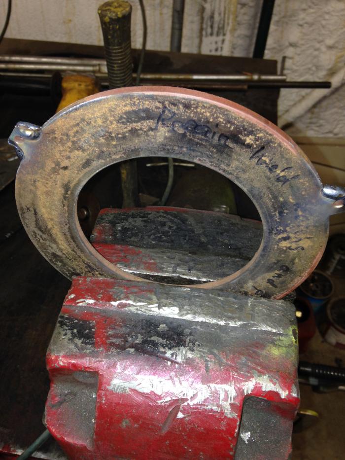

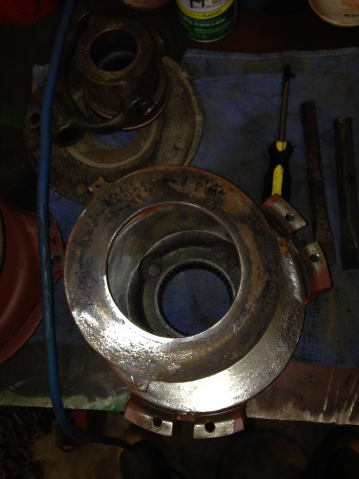

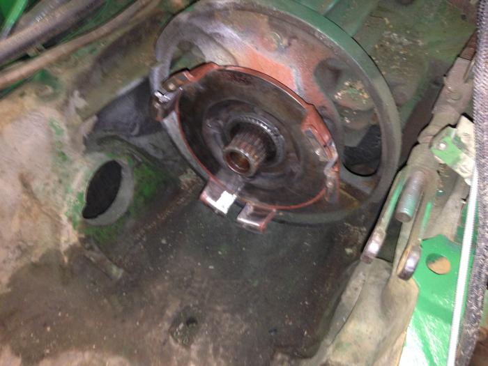

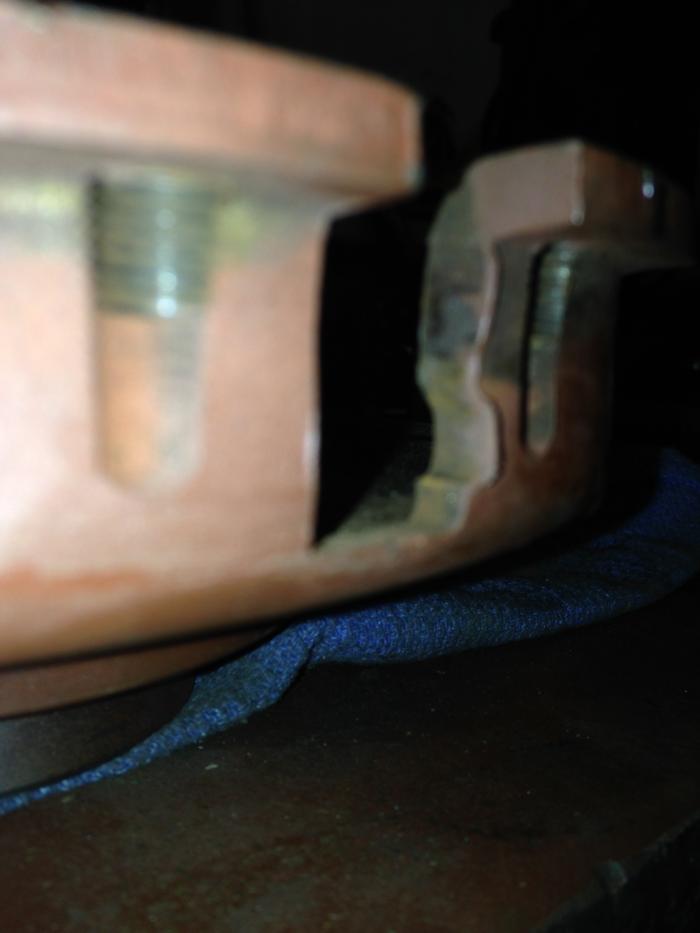

I just can't believe I never finished this thread!!
I did it all in one day, and got pics, but never posted them
I built the ears up with mig....and ground them all down to fit with like .030 tolerance...
And built the groves up on the housing sorta....(Third picture in this post

I wish I had better pics of the finished welds.
Sorry about that.
