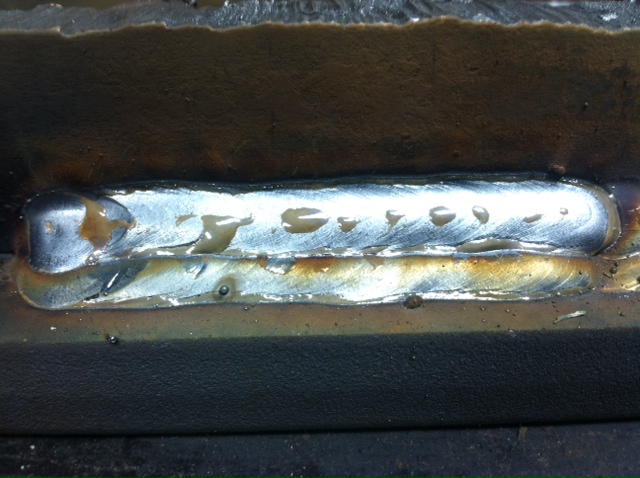

Well I am very embarrassed :oops: :oops: I was thinking of a groove not a fillet. Anyway I beat you John to the pictures :D
This is 3/4" plate I had laying around. Specs 75/25 gas, .035 ER70S-6, 29.5 V, 515 wire. I went with what my MM252 recommended for 1/2" plate just to give you a reference. If you can switch to 90/10 or 95/5 it will be a much smoother arc and a true spray.

For the single pass cover, I would recommend running your root either smaller or hotter to burn it in and get a concave weld. Then for cover run it at your setting you settle on and hold still to fill it all in. I should have done one for you, will have to sneak out to garage again tomorrow.
One thing you didn't mention is what is the fillet size? This will help in recommending settings and how to fill it in.

Technically you would want a 1/2" fillet on 1/2"(12.5mm) plate but I would say 3/8"(9.5mm) would suffice for a test. This is the minimum I would want to put on in a real world situation. Personally I would still push for a 3 pass equaling 12.5mm because this is correct. I guess just do what they ask and move on. The best of luck to you on this test. Keep us posted.
    Wed Oct 23, 2013 3:30 pm
    Palmer AK
Those are lovely welds Jonathan.
That is what I like to see in a filet.
Nice and wet out.
