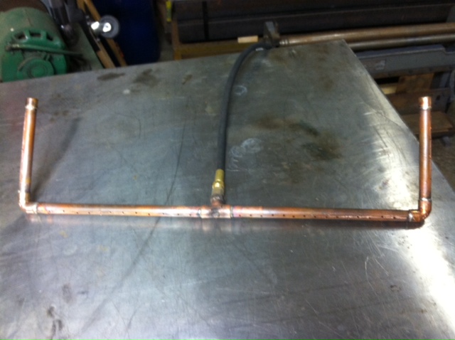

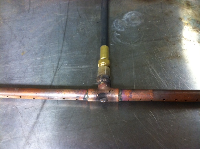

On Jody's video on the tap removal, he mentioned upcoming videos on back purges and how to build them. I thought I would get a thread started in anticipation of those videos. I made this 1/2" copper tubing back purge for a one time custom application. I used Silicon Bronze to braze the brass inert gas fitting to the copper and this back purge worked very well.
Lets see your back purge set ups or purge chambers. I am actually waiting on parts for a purge chamber and will share the pics and progress when I start building it. I also have some 316L that I am planning on using for a back purge set up. I cant wait to see Jody's set up.
I once talked to some friends about back purges and the price gouging involved in units sold (my opinion). I mentioned the idea of marketing some purges at reasonable prices but the drawback is those who would use a purge can make one as easily as I.

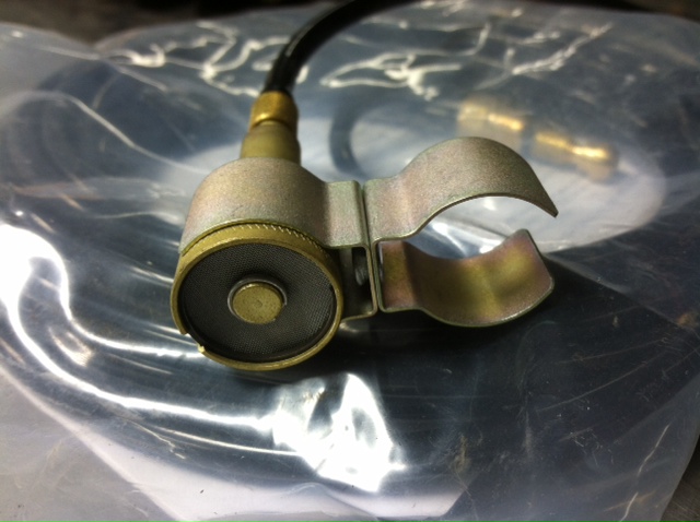

I also have this CK Worldwide TS300 trailing shield that I have not had the opportunity to use. Thought I would throw it out there for those who would need one, as this is very reasonably priced.

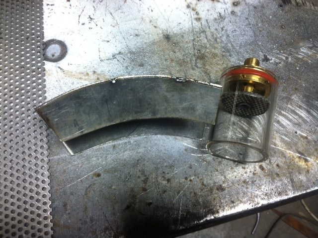

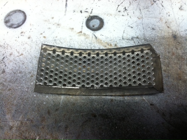

I decided to try my hand at making a trailing shield for my jumbo pyrex gas lens. This is all just scrap SS I have laying around and all hand cut and you can tell. I am waiting on SS wool to come in and have to go get the barb fitting. This is set up for 8" pipe. I do wonder if it would be worth my time to try to market something like this.

Superiorwelding wrote:I decided to try my hand at making a trailing shield for my jumbo pyrex gas lens. This is all just scrap SS I have laying around and all hand cut and you can tell. I am waiting on SS wool to come in and have to go get the barb fitting. This is set up for 8" pipe. I do wonder if it would be worth my time to try to market something like this.
Jonathan,
These look a lot like some of the ones we would make that didn't need heat sinks and used them for backups. We also had some for cups too, that we'd use for titanium sometimes. Nice work
GreinTime,GreinTime wrote:Jonathan,
By saying it's setup for 8" pipe, are you implying that the radius of the 'C', if you will, is the same as the outside radius of an 8" pipe?
Yes it is in fact a 4" radius. I will still have to angle the back side to allow my torch to angle back. Still a work in progress.
A continuous strap with a small bolt to tighten it up.
Or I could try brazing the SS to the Pyrex
