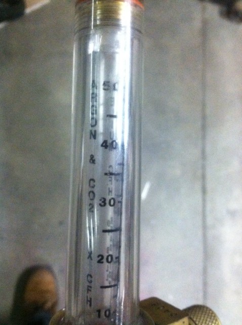

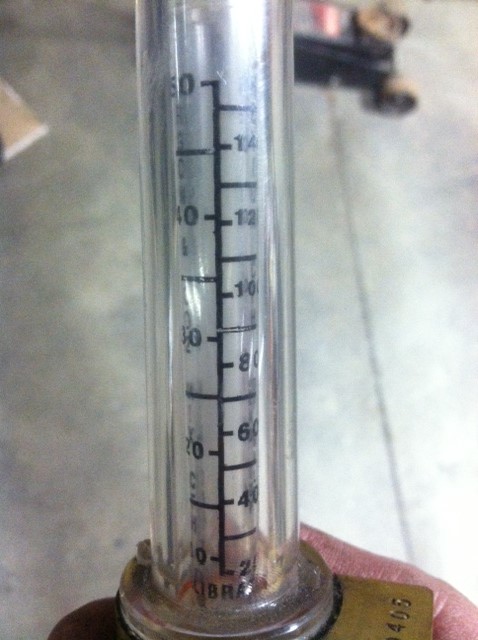

Here are some pictures of a regulator marked for both argon and helium.
- reg 1.JPG (74.16 KiB) Viewed 1957 times
- reg 2.JPG (82.19 KiB) Viewed 1957 times
- reg 3.JPG (84.76 KiB) Viewed 1957 times

A single gas flow meter is the best for any gas because the weight difference between gases can be significant, and Argon and Helium are close to opposite ends of this scale. Argon being much heavier will lift the ball of that size and weight much differently than Helium, so the scale can only be accurate for one or the other on a split scale flowmeter. Luckily for us it's not an exact amount that's required to weld and can be adjusted fairly easy with the turn of a knob.
A split scale flowmeter that's scaled for Argon and CO2 are closer to being accurate for both gases because their weight by volume are similar, Argon being 39.95 lb/mol and CO2 being 44.01 lb/mol in comparison to Helium being 4.0 lb/mol. which effects their gas density, hence their ability to lift the ball.
The worst part is the fact that all this matters little at the end of your of your nozzle because the Helium is inherently trying to rise and the Argon is trying to settle. Plus there's an effect on the arc from these gases that can't be quantified by a number.
