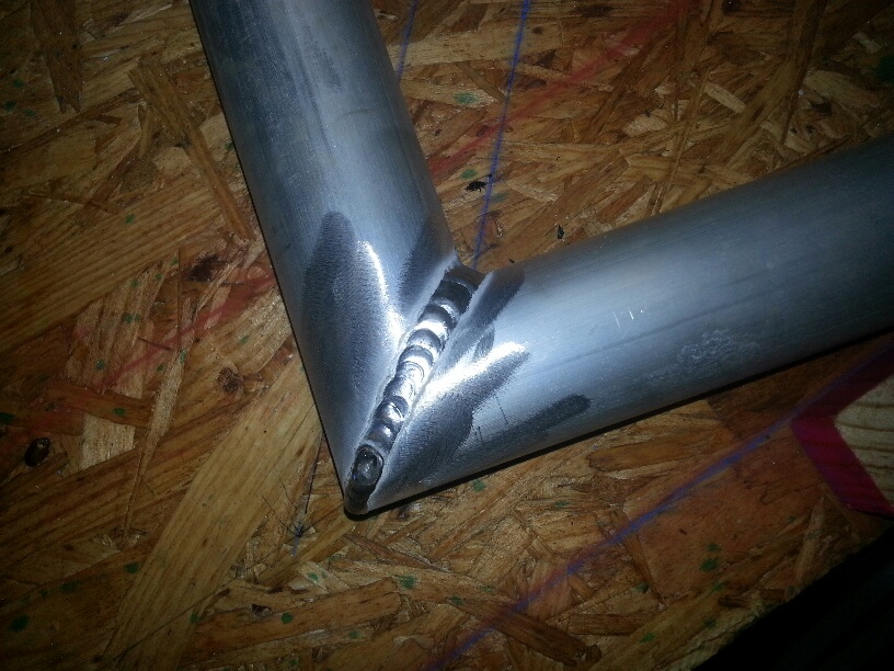

ok guys here the latest try at it what do you guys think? i keep seeing little black dots in the weld after im done .could it be a gas problem or tungsten

Looking good so keep at it. Perhaps you are lifting the cup (too much torch angle?) too far away from the weld puddle. In the last decade, it's been fashionable to work with the tungsten way out of the cup. That's all fine and well if you use lenses, but I don't weld that far out unless I have tight inside corners. I use no more than 1/4" of tungsten exposed unless it needs to be. I don't find lenses to be necessary welding smaller pipe 2" and under. Sometimes a bit of a ballooned gas shield is beneficial in these situations.
I agree with Jeff!
That'd look "pretty good" for many experienced aluminum hands. That looks GREAT for no longer than you've been working with it.
"Pepper" in the welds is not uncommon, when your gas supplier views you as a "hobbyist/home shop" welder. You get the bottle that was mid-transition from 75/25 to straight argon, and the purity isn't up to "code". This isn't really a big deal for most welds, unless you get moisture in the gas...
If a wire-wheel will take it off easily, it's only surface contamination (floaties, I like to call them), and is a non-issue for most things you'll weld.

i try to keep the tungsten stuck out about half the width of the cup which im using a number 8. I did have to extend it out a little to reach behind the 45s though . I do see peppering on the weld buts its not all the time or on the entire weld . I don't know maybe its me and my lack of experience . I did grind a weld out cause I saw what looked like pin holes form in the puddle while welding , but when I ground it out there were no signs of pin holes ,at least not that I could see . i am also getting a large ball on the end of my tungsten is that to much positive or negative . and thanks for the confidence boosting compliments that's only my 5th aluminum pipe weld ever .once again thanks for all the advice and help guys its much needed and appreciated .
For that material you should be able to use balanced AC. Also, make sure the ball is not sagging to one side of the cup blocking the gas flow in different positions. The ball should stay centered. Wonky gas can cause the tungsten to ball erroneously as well. Play with the High Freq settings if your machine is equipped with it. Just about every machine I have used has a different sweet spot.
I wouldn't just rely on grinding or sanding to clean those joints outside of the actual joint prep. I would use a Stainless wire brush on the area outside, if anything, and wipe off the pipe after cleaning it if using abrasives. Sanding sometimes gives the appearance of it being clean when it actually isn't and you may actually embed contaminant into the aluminum. Also, if you 'grain' the pipe in other than the direction of weld travel, the edges of your weld puddles may be drawn into this grain by capillary action, giving the edges an irregularity instead of a crisp line. I typically tack up my parts and then wire brush it
Also, watch the cleaning action when you start your arc. Notice if you see any black residue creep from the weld zone. If it does, wait until it is cooked away from the joint by the cleaning action.
