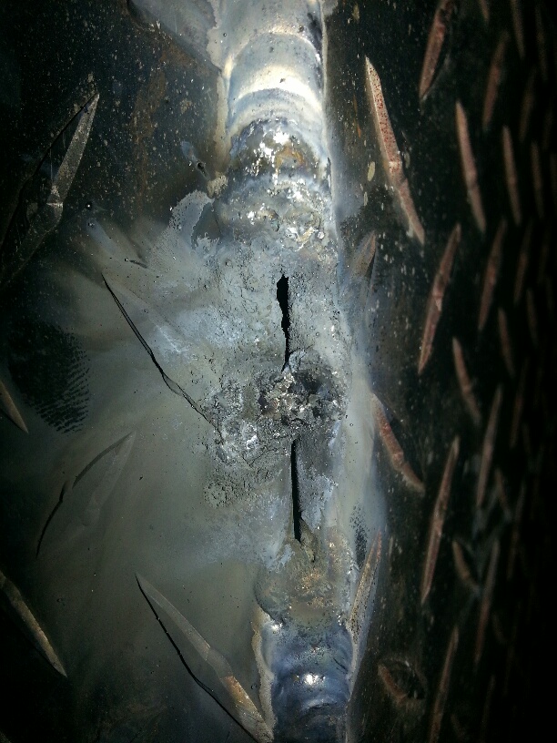

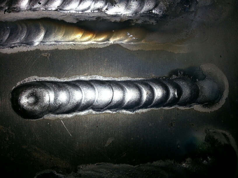

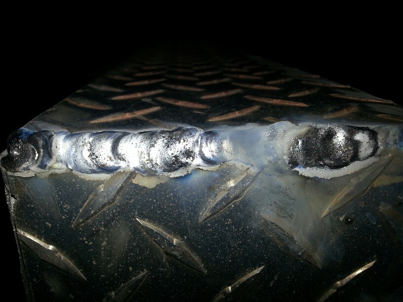

here's what I get when welding guys crappy on the corner weld and some what ok on the same material just in the middle of plate I did find a small leak on my flow meter could that be causing all this or is it operator failure as well once again thanks for your help to everyone who offered their advice

You didn't, by chance, have this corner weld set up where an errant breeze could have hit the backside and blown through the gap against the shield gas? You have good weld right up to the problem, is why I ask. It doesn't take much air movement, when focused by a corner.

L per Sec to CFM conversion is just over 2, so you are right on there. I would try a little more flow. What are you using to cut / clean the ALUM? I have had issues with my lathe coolant causing problems if I don't wash the part after. Do you have access to another Gas cylinder?
Doesn't make much sense to have "crow shit on barbed-wire" in the middle of an otherwise passable weld.
With the "pepper" I see in the other pictures, it does seem like a gas problem... If the system is tight, you may well be dealing with moisture in the gas (poor product from the supplier). If it were the wrong gas (which happens), all welds would fail equally.

the aluminum was cut with a plasma the ground down with a flapper wheel to clean metal I did have a small leak I found im going to get a new bottle of gas on Monday and let everyone know how it turns out thanks again

well to update I think It was bad gas welds are coming out 100% better thanks everyone for the advice. im sure ill need it again
