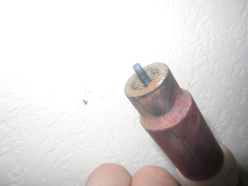

Hello all,
I'm having a unique problem with my electrodes. I've searched forum after forum and I can't find anything. Before I describe the problem, I'll give you a rundown of the setup I am using:
Longevity LC-520D multifunction machine (TIG/Stick/Plasma cutter) hooked up to 220V
Adjustable pedal with max amperage set to 110 amps
3/32" electrode
#6 cup
Argon with regulator set to about 15 SCFH
DCEN
Now, the problem: when I try to start a puddle, the arc is fine for about 2-3 three seconds. Then there is a crackling sound and the arc becomes erratic. I'll let off the pedal and look at my electrode. The electrode will be glowing red hot and it will no longer have a sharp end. It'll be very round. At first, I thought the electrode just too close to the puddle and maybe I dipped it in. However, after sharpening the electrode 4-5 times and being VERY careful about my arc length, I am certain that the electrode was not dipped into the puddle. I'm getting very frustrated with this. I taught myself to MIG weld and I can lay down some gorgeous beads with great penetration, but I can't even begin to learn to TIG because of this.
After I got my machine, I did have to call the company and order a new pedal. The old pedal would only put out 2 or 90 amps, nothing in between. The new pedal seems to work fine, so I don't think that is the issue. I don't have a water trap attached to the Argon tank because the one I had kept leaking. Maybe the problem is moisture in the argon?
Hopefully, this isn't a machine issue. So far, Longevity has given me great customer service and I would hate to have to call them again because something else on my machine is broken. Also, I don't have another $500 or $1,000 to spend on a different machine... I've attached links to pictures of the electrode to give you guys an idea of what I am describing. Does anyone have any idea what I could be doing wrong or what could be wrong with my setup?

Might I ask what you have the A/C balance set to? I think you may find the culprit in that setting.
Sorry if O sound vague, I'm posting this from my phone.
Edit: After hitting submit, I realized "He never mentioned aluminum". Haha. I definitely had a brain fart. Anyway, might I now ask what material you're welding on?

My machine is DC only, so no AC balance here. Today, I was trying to weld on some 1/8" flat stock that I was using to fabricate a motorcycle brake metal mount. After 45 minutes of ruining electrodes, I got fed up and just did it with my MIG.

Do argon and air for the plasma come into the machine on seperate ports? Or the same port?
Have you leak tested all the hose connections, starting at the bottle?
I suspect gas, but there are people far more qualified than I around here and I'd be interested to hear what they have to say.

It looks as though you have the polarity reversed. I see no note of whether you are running electrode neg or electrode pos.

Have you got the tig torch hooked to the negative or the positive terminal?

1 tig gun plugged in but machine was still set to stick
2 reverse polarity. Electrode +
3 someone in my both stood on my agron line.......

The only time I've seen an electrode turn black is when I forgot to turn on the gas. Not saying that's what you're doing but something may be screwing with gas flow, you got the wrong gas, bad gas or like I've done forgot to turn on the gas. When I forgot the gas it wasn't focused and quiet like it should be. The arc flared out alot and there was a hissing sound. Like gas flow hissing but louder.
I hook up my leads backwards the other day (been playing with stick too much). The only result was the electrode was balling up. I was trying to weld copper for the first time and thought there was something going on with the metal cause the arc was very erratic. For troubleshooting purposes I struck an arc on steal. I noticed cleaning action around the arc and that's when it dawned on me. The was no blackening of the tungsten when I did the steal I just saw it ball up and noticed the cleaning action.

Thanks for all the replies. I'll answer your questions in order.
Jay_M: The argon and air for plasma go into the same port. Unfortunately, it is a ribbed nipple, not a threaded port. I had to attach another ribbed nipple to my argon bottle just to be able to connect it. I haven't leak tested any connections yet. I didn't realize that weak argon flow could cause a burned electrode. I'll go through and leak test everything tomorrow.
blaz: Sorry about not listing the polarity. It is DCEN. On my machine, since it is DC only, this is the only way to hook it up. The connectors for the torch and ground clamp aren't reversible (at least, I don't THINK they are).
Mrkil: It looks like blaz's post with the Miller resource sheet and everyone else's response agree with yours. I'm guessing at this point that I have an argon leak somewhere.
I suppose I'll leak check all my connections and make sure there aren't any hose kinks tomorrow. I'll let everyone know what I find. In the mean time, if anyone can think of another cause, let me know! Thanks!

It sounds like an obstruction in the line, very close to (or in) the flowmeter.
The regulator before the flowmeter is set anywhere from 45-75 PSI, and allows pressure to build in the line, despite obstructions. This is why it welds fine for a few seconds... When the gas solenoid opens, it's releasing the pressure in the line to the torch at a good rate. Then the flow drops off.
What style flowmeter are you using? Is it the type with a dial, that looks like a small version of a pressure regulator? It will mislead you, because it IS a pressure regulator, and will always read 15, if you set it for 15, regardless of actual flow. It will give you a line full of gas at the set pressure, for a couple seconds of welding, then die off if there is a problem.
If you have the floating-ball style flowmeter, you should be able to activate the torch and watch the ball for several seconds, even if you have to arc to something behind your back, and look for a change in actual flow.
When we replace supply lines from flowmeter to welder at work, we use 3/8" nylon air-brake tubing and compression fittings. These hold up very well and don't "weep" argon like less rigid lines.
The description in your original post really suggests to me the problem is between the flowmeter and machine, close to the flowmeter, or in the flowmeter itself. That tungsten in the picture is exactly what happens if you weld for a second or two without gas.
I always recommend the floating-ball flowmeter, because it does read actual flow, regardless of conditions.

I do use a floating ball meter. I had a dial meter before on my MIG, but it was a piece of junk. Now I have identical flowmeters on my MIG and TIG. The one on the MIG works fantastic. Maybe there is something wrong with the one I have hooked up to the TIG. I'll take it off this weekend while I replace the line and rebuild it with a parts kit. Below is a link to the flowmeters I have:
http://www.usaweld.com/Welding-Flowmeter-p/12020-f.htm
Otto Nobedder, do you know where I can get a short length of the air-brake tubing you were talking about? Would AutoZone have it, or do I need to go to a specialty automotive shop?
That's a good question... I've never bought any myself... What I use at home is always "salvage". I use it as water line in my camper (even hot water). If autozone doesn't have it (they probably do), find a truck shop nearby. A mechanic might just give you a six-foot length of drop from a roll-end.
Also, since you have this type flowmeter, I'd suggest you try my idea... Arc to some junk behind you and watch the ball... Does it fall after several seconds, despite the arc in progress? This will help diagnose.

Alright guys! The problem has been fixed. I basically took everyone's advice and assumed it was a problem with my shielding gas flow. I diagnosed it by starting at the bottle and working my way toward the torch. After inspecting the flowmeter and it's connection to the hose, everything was fine. I looked at every inch of the hose and found a large slit about a foot from my machine. It looks like someone may have dropped something heavy or sharp on it at some point... Since I'm the only person who works in my garage, I have to assume it was me. In any case, I replaced the whole hose and fired it up. I was laying down horrible beads in no time... Now I just need to practice until I can't see straight and maybe I'll be able to make a decent weld. Thanks for all the help!
Good to hear you've sorted it out!
I'll have to file that one away for future reference... Perhaps the high-pressure flow that occurs when the solenoid opens was able to overcome the leak-rate for a second or two, then most of the gas at the set flow was leaving through the slit...
With it working right, time to turn and burn! Share some pics, when you're comfortable!
