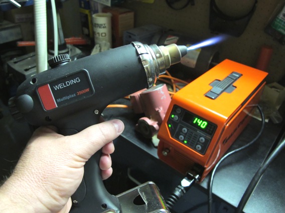

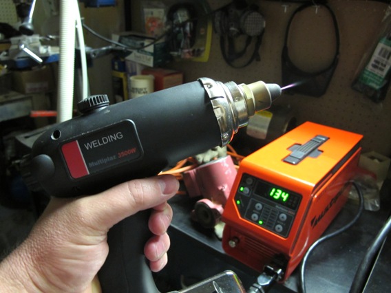

Larry, have you tried using a cutting tip nozzle with the smaller orifice as a welding tip with the 50/50 solution on Mode 1 at the lowest setting? Leave the cathode adjusted as if you were welding not cutting.
I got to thinking about this welder and I was always getting way too much heat for some of the jobs that I was doing, so I wondered what would happen if the nozzle orifice was smaller. This would be the equivalent to selecting the proper sized tip on an oxy/actylene torch. Well, to my surprise I finally got what I was looking for, a torch with plenty of heat but within the heat range for work that I was trying to do. At first, I thought that the smaller orifice would just make more pressure and not work like I expected it to, but by selecting the lower settings, it worked just fine. I kept the voltage under 170volts. (Just for fun, I tried to tame the torch even further by running it on straight water for welding. This cut the heat down even further and allowed me to weld some pretty thin stock.) Photos attached.
The other thing that I noticed was that the nozzle orifice loses its nice round shape from time to time and gets a bit of a buildup inside. I use a pin vise with the appropriate sized drill bit, to ensure that the nozzle orifice is always clean and round. This is most noticeable when the flame starts to form a strange shape. I listen to the sound of the gases coming from the nozzle and when its adjusted properly it suddenly goes quiet. Watch the flame color and make sure that there's no green tint at your setting. (this is copper burning). The gas flame should be a nice blue color, (sometimes white) and the noise level of the gases should be minimal. If the torch is set wrong, it will be as noisy as a Victor gas torch.
I can see having to replace the cathodes when they wear out, but the nozzles can easily be welded over and redrilled to any size that works for the application at hand. This torch is designed to weld copper and the nozzles are made of copper, so why waste copper by replacing nozzles, just recondition them. I plan to experiment with a wide variety of nozzle orifice sizes to see what works best for me.
I already know that as a plasma cutter, this torch is lacking but as a clean burning fusion torch, I'm still very impressed. I haven't tried stainless yet, but now that I've figured out how to control the heat a bit better, I might give it a try. Its all experimental on my side. This is a hobby for me and I'm a very curious person.
I weld in my basement and there aren't any fumes. The smoke detector is within 8ft of my welding area and its never gone off from welding. (I've set it off a few times with some of my electrical experiments.) The torch is clean burning and I like this very much. BTW - There are 6 smoke detectors in my house at strategic locations. I feel much safer using this welder indoors, (compared to anything else) because there are no dangerous high pressure gases being used and I can shutdown the torch with the flip of a switch. When I'm done welding, I turn off the inverter and put the torch nozzle in a glass of water to cool it down. (This is standard procedure from the manufacturer.)

- Cutting nozzle for welding with straight water.JPG (79 KiB) Viewed 2767 times
- Cutting nozzle for welding.JPG (79.49 KiB) Viewed 2774 times
WerkSpace,
Thank you for your comments. I agree that there are improvements that can be made in the operating procedures that are recommended in the Multiplaz-3500 manual. However, for our testing we first test the torches as stated in the manual. My evaluation is also from the perspective of using a machine for commercial or production purposes. Hence, for each set of tests, we put a new cathode and nozzle on to minimize any effect of wear on those parts and to obtain the best results for the evaluation.
For personal use (and perhaps in production, too), one would, as you have said, try to clean up and reuse the consumables as long as possible.
I also agree with you about the advantages of not having to have compressed gas tanks for personal use. This is really the major advantage of the Multiplaz-3500, and for some it outweighs the disadvantages. My intent is to present as much information as I can and let each reader decide.
As for the issue about fumes, I wrote Part 10 of this Evaluation before I read your comment. I think that it gives my perspective on the issue.
