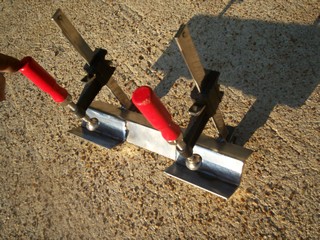

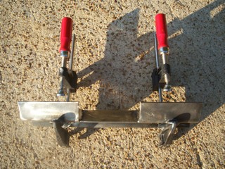

This is a really handy clamp that I made one day. It's just 2 clamps, one long piece of angle iron, and 2 short pieces of angle iron. It allows me to clamp up round or square tube and weld them together on 3 sides, then reposition.
