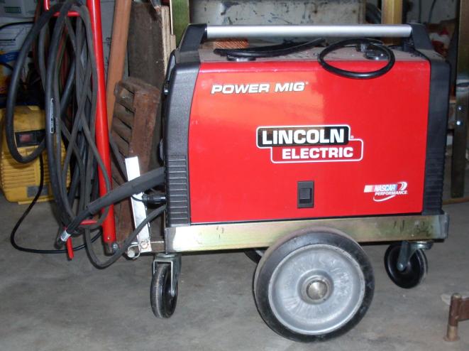

I built a cart for my 180 dual mig machine that I havent seen one similar to. It's big (8") wheels are mounted at the center of the frame that the welder sits in. Not shown is a frame that bolts in to raise the welder (and slightly tilt it), when I roll it around outside on uneven ground (so I dont tip it over!!) I use -so far- only flux core wire so I dont need a gas bottle with it. centered front & rear are caster wheels. 'Cause its pretty much balanced on the big wheels, it dosent need 'super' strong caster wheels, tho these are supposedly rated at 150-175 lbs. The handle (the red riser w/ leads on it) is in the front. It is NOT in the way for the 2 control knobs. I originally intended for the handle to be at the back, but a simple 180 deg rotation of the welder changes that. It "spins on a dime" and with everything at the front, it is so EASY to park. (yes, the side door clears the tire and frame by 1/4" or so)
