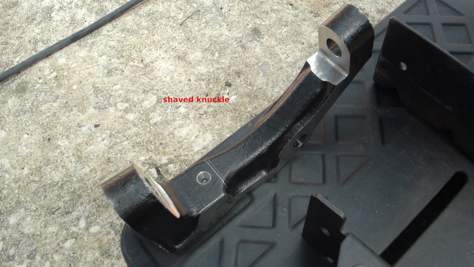

I am trying to build a set of wheel knuckles for a custom double wishbone suspension for Nightwing. I purchased a couple knuckles and shaved off what I did not need and cut it into two pieces. Now I need to weld the pieces to an axle tube(VW). In the pics you see I have them tacked together. The ebay description states the knuckles are made of 1045 hardened steel. Not sure what the axle tube is made of maybe 1045 also?
Does anyone have a suggestion to what method MIG/TIG I should use and what wire? Preheat?..etc

removed material i did not need

I wouldn’t weld that metal under any circumstances given you don’t know the state of it when bought (was it normalized, heat treated, hardened, etc.).

Plus, given its critical nature to your safety, there’s not a chance in hell I’d risk an unknown on a critical part like a vehicle hub.

To be clear, my position is purely based upon safety and liability. Can you weld it? Sure. Will it crack and fail? Chances are >80%. Should you weld it? Not a chance. And the reason I say no is because you don’t know (I’m assuming the product page did not list the post casting treatment completely) what state the metal is in currently.
If you had a spare/sample piece, welded it up in a similar fashion, and kept very close eyes on post-weld cooling, maybe, just maybe, you could increase your confidence.
But because I ride motorcycles (custom and production) I wouldn’t do it. Bikes have too little safety gear already. You don’t want a hub coming loose and sending you doing the triple Lindy at an oncoming car.
There are procedures for just about every scenario (wire type, preheat, post heat, tempering, etc) but you have to know where you are starting with the materials. Keep us posted on your progress!
