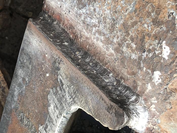

I’ve had7018 that was almost a full 50 lb can that got caught in a rain storm. Filled the can with water. Poured it out, threw out the hand full of rods that crumbled. Left them open in the garage over a mid western winter. Good and dried out but even the iron in the flux rusted. Still weld stuff with them, they light up fine. But I’ve had batches of 7018 the would start to arc hard after they were exposed to 90% + humidity in the summer for only a few hours.

To be honest man... unless your going to be welding on test material or or a joint that is going to be inspected. That 7018 rod will burn just fine man. I’ve used rods that have sat out in shed on some 1” plate fixing the tracks on an excavator an that puppy is still rollin around now problem. Those rods will burn good. Depending how thick the material is your welding run a few beads on there with a 3-4 bead cap.
- EC5565A2-536B-4BEB-A123-CD3EE8064FBD.jpeg (91.4 KiB) Viewed 20585 times

They will pass a bend test because although welds made with improperly stored 7018 rods can have ductility somewhat affected; impact toughness, tensile and yield are not highly affected (per Lincoln).
As a result, 7018 rods deposit quality metal regardless of storage.
The hydrogen assisted cracking isn't even a concern with mild steel in general anyway.
Remember, to get hydrogen cracking it takes 3 things: crack sensitive material, highly restrained joint, presence of hydrogen.
Remove any 1 of 3 and it's not much of a concern.
