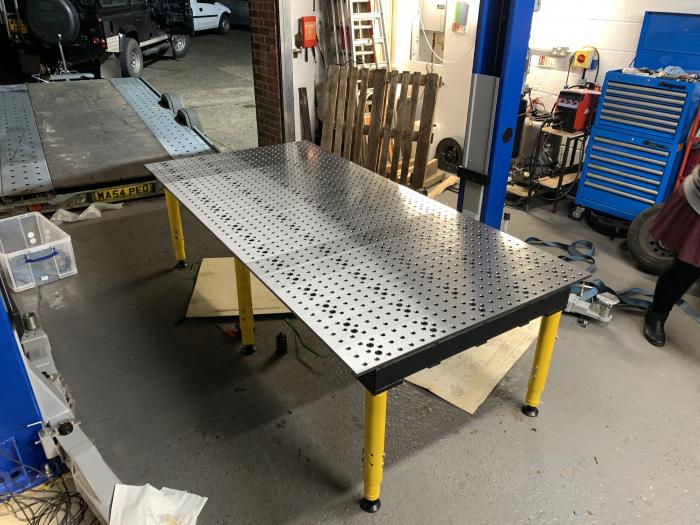

Purchased a Metric version of the BuildPro Max 2550x1250 here in the uk.
While setting up I noticed the surface finish looks more like a belt sander that has chatted across the surface than a precision ground surface...
As I don’t live in the States so I have nothing to compare this too, other than all the videos where the surfaces look like machines surfaces... can someone put my mind to rest this is normal quality of buildpro?
There are burn marks where it looks like they tried to take too much off too quick, but the chatter marks look terrible.
My other red flag is that the paperwork was all Chinese with the surface measurements for calibration not in English, makes me wonder if this is same table that is for USA market...
Can you help me put my mind to rest?

I wonder if the panels that are darker in colour have had more heat put through them.

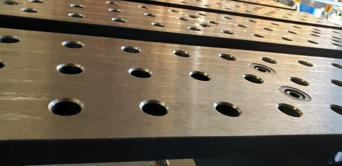

Compared to our buildpro table here at the shop that does seem rough. Our finish is coarse, but no chatter or skipping.
It's definitely not very flat compared to decent surface grinding as shown by the shiny high spots after stoning.. but our table definitely seemed adequately flat for a welding fixture surface.
Keeping a routine of cleaning surface rust and stoning away the high spots is a really good idea as it will get dinged up, especially in my shop where I'm not the only one who uses it.

Pics for comparison;
-dudley
- 20201019_170723.jpg (77.24 KiB) Viewed 4083 times
- 20201019_171530.jpg (71.06 KiB) Viewed 4083 times

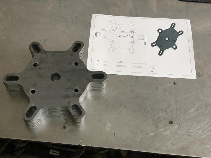

I had to purchased castors separately, didn’t have any plates so knocked a quick drawing up for my laser cutters..
Will weld a nut in the middle and then some m20 thread bar locked into that which will go up into the legs... the plan is to level the table I can use my feet to turn the castor plate while the wheel stays still and it will higher or lower the table.
Hopefully that shows my intentions. Welded nut down to plate then lock nut on top to hold thread from spinning. Then will have another lock nut on table leg to nip it down once perfect height.
- 1B0561B6-EDAB-4D77-B114-9538193913AA.jpeg (37.51 KiB) Viewed 3784 times
- 8C470B75-DA67-4CA8-8271-4BE86C5DC996.jpeg (52.07 KiB) Viewed 3784 times
- EBCA1438-6A25-403C-AB8C-BBB1A70216DB.jpeg (15.69 KiB) Viewed 3784 times

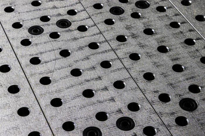

Here are some more images of the surface, I've tried to edit the photos so that you can see the marks a little better.
After measuring the table, all the centres are high, going to have to shim the ends up by 0.005 min, and measuring the ups and down (the marks you can see) measure about 0.02mm.
You can see w3here I've taken a surface stone that has been surface ground to the top of each run, its rubbed the high point off and as you can see its not sorted, but you can see where the top points are now.
The joke of all this is the table I made years ago is more accurate then this, just this has holes in it. Bars do not sit flat on the table, they rock and pivot at the moment, the other issue is the thinkness of some of the plates is too thin, defo out of specs so they sit low.. I've ordered some shim stock to add under the pads and see if I can make it good.

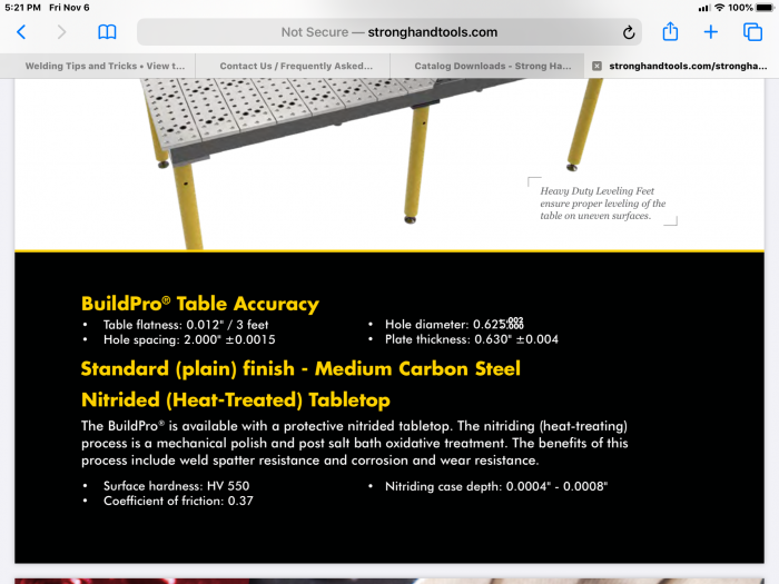

I think if you look at the manufacturer site, they indicate the flatness tolerance across a given length. 0.005 across 36” would be pretty good, across 12” not terrific. But as a welding table, it is probably inconsequential.superclarkey wrote:Here are some more images of the surface, I've tried to edit the photos so that you can see the marks a little better.

If the slats aren't bowed or twisted more than, say .005" in each, would it be worth inquiring if you could have them
Blanchard ground as a bulk lot ?

I looked at their website. They cite 0.012 in 36” so it’s likely well within spec.kiwi2wheels wrote:If the slats aren't bowed or twisted more than, say .005" in each, would it be worth inquiring if you could have them
