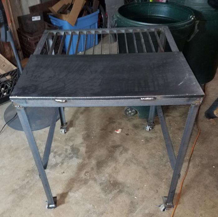

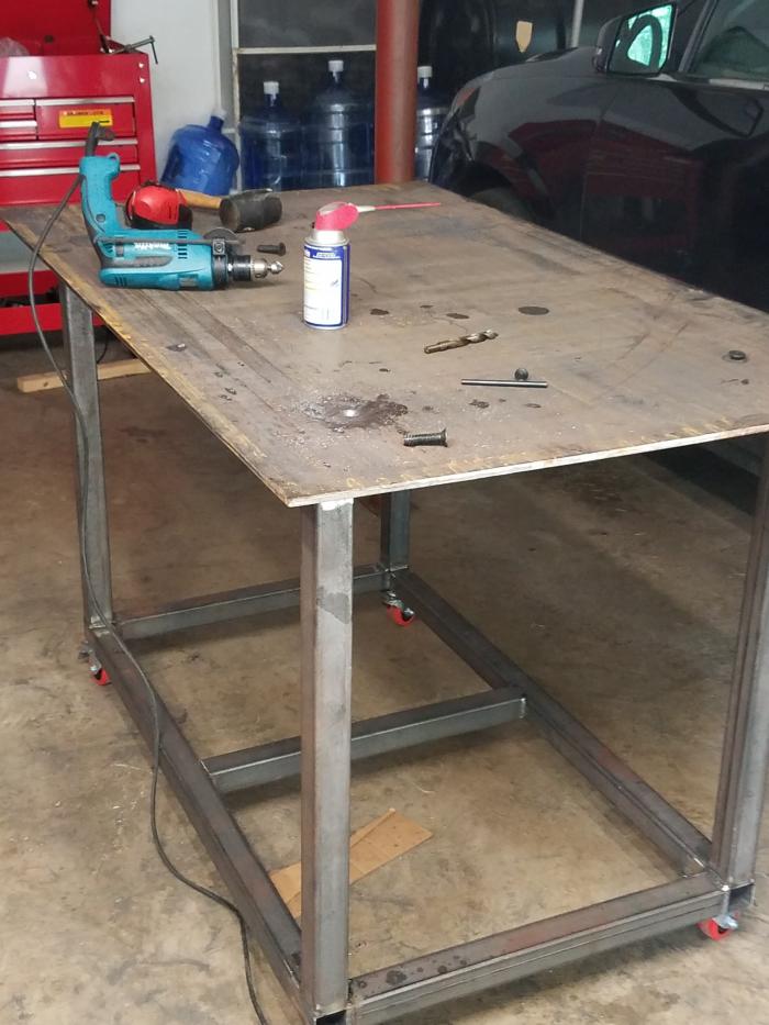

You should really make your first table IMHO, it will teach you a lot about fabrication. Here are the first two tables I built. One is a low boy designed for welding while sitting down, it is a 30 inch by 30 inch surface. The second one is for standing work. It is a 3 foot by 5 foot top, 3/8ths inch thick with 2 inch, .120 wall square tube for the frame.
- small table.jpg (58.28 KiB) Viewed 1818 times
- table1.jpg (78.42 KiB) Viewed 1818 times

How did you make the tables square without a table?
Your tables have no openings in them. Would you do it that way again? People seem pretty excited about holes and slats.

Well I watched the video CJ737 posted before I made my table. That and I bought a couple of fireball welding squares.How did you make the tables square without a table?
Correct, no openings. My table has a 6 inch overhang on all sides. I just clamp to the table on a side or on a corner. I haven't made anything yet where that wasn't sufficient for my purposes. Yes I would do it that way again.Your tables have no openings in them. Would you do it that way again?
Yeah, people seem to get excited about a lot of stuff that don't really seem to matter. To each his own I guess. If I find I need the slats and holes I will probably just go buy a stronghand tools fixture table. But until I find I need it, I am not going to.People seem pretty excited about holes and slats.
