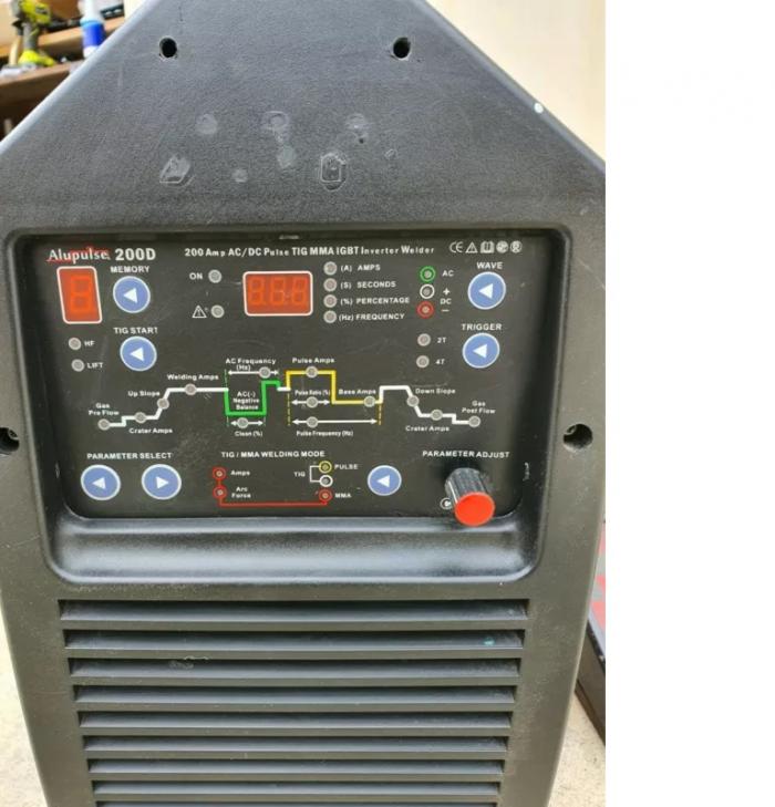

xland
    Tue Dec 15, 2020 5:36 pm
HI ACE,
Nice thread on scope and nice beads.
Was wondering where you connected onto welder as I need to do this to continue my repair on my 200AMP ac/dc/PULSE Digital TIG.
alupulse 200D.jpg (61.55 KiB) Viewed 52861 times
2 IGBTs let go and a gate resistor ,also both bridge rectifiers.
Got it going did a bit of welding (DC SS 80 amp pulse)all good.
Next time I switch unit on circuit breaker blows..............
My forum intro link is here
https://forum.weldingtipsandtricks.com/ ... 27&t=15923
Would like to start a thread on repairing/testing inverter welders, also your input would be valuable.
I can make the thread public or PM you for advice if thats OK
regards
X
