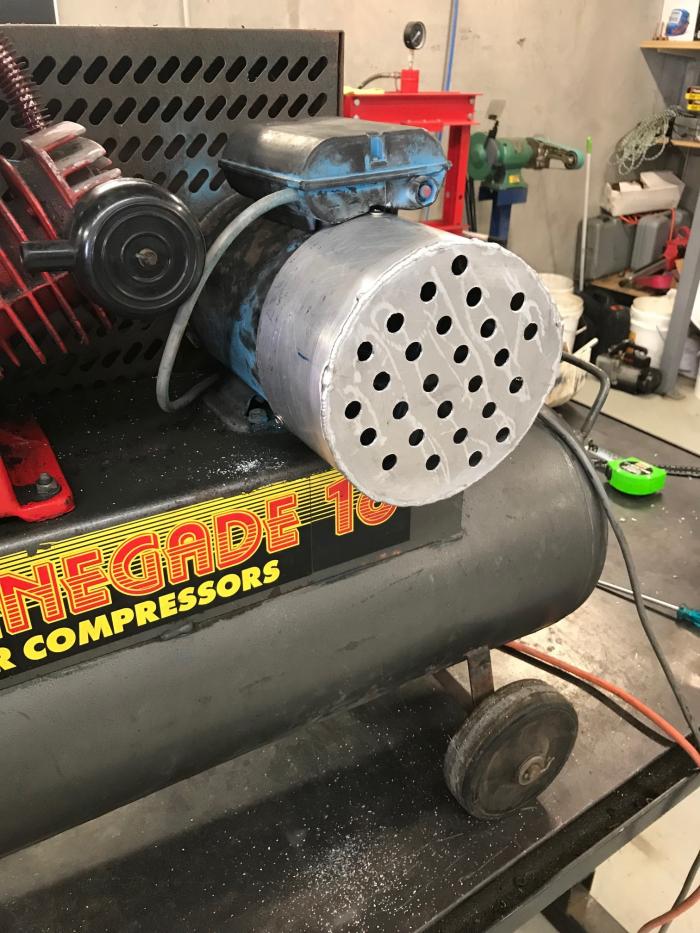

A customer was about to dump a 3 cylinder air compressor that got condemned by OHS because motor terminal box was ripped from bracket and motor fan cowl missing. I offered to take it away for free. They accepted my kind offer.
Repaired the terminal box with internal clamping - now solid.

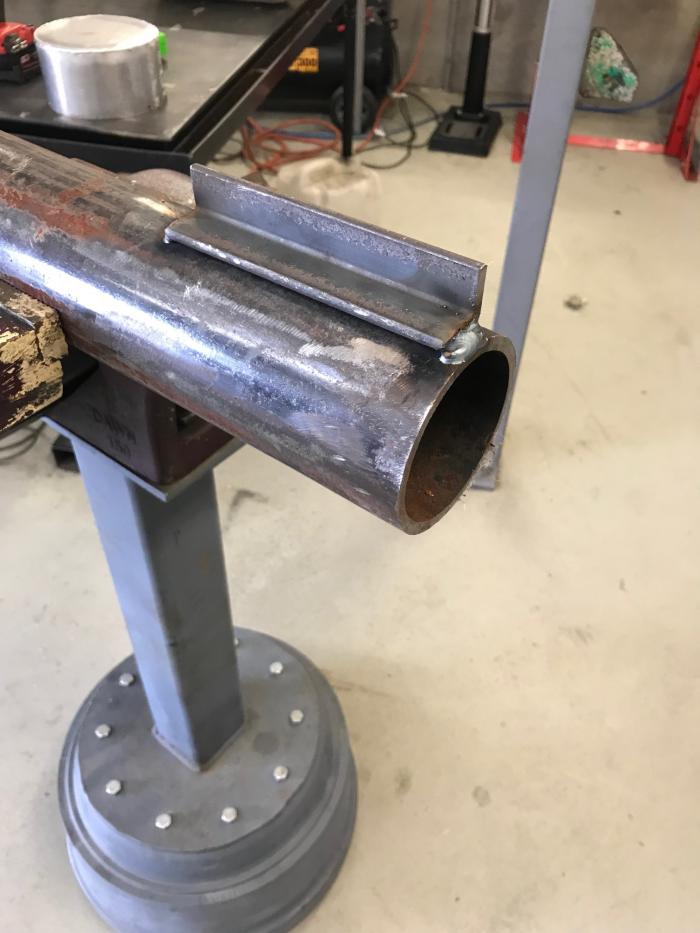

Made a new fan cowl out of scrap aluminium sheet. Don't have slip rollers so had to improvise. Made up up this widget on some pipe, slide a 100mm (4") strap through a little at a time hammering all the way until I got the diameter I needed, weld it up, drill some holes and bingo job done. Runs very well and quiet too.
My aluminium welding is very rusty but I wasn't going for looks.
