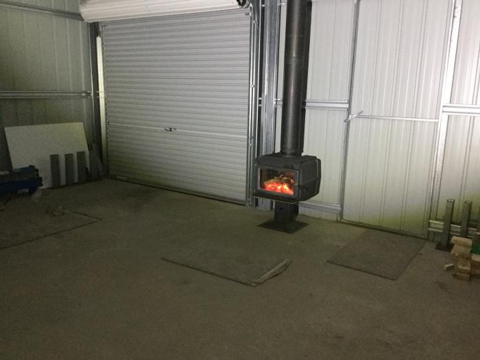

Still a week or two off the electrical going in, toilet ll framed up, plumber just after the electrical, i got my fire in today!!! Good ole gumtree!!!!rahtreelimbs wrote:Please post pics when completed.

- tungstendipper
That stove looks toasty! You're going into your Winter. We are sweltering in 95+ heat. I'll trade you.

I actually like the cooler months the older i get!!!! Our winters aren’t too bad, 10 hours of daylight and minus 3 on average the worst, last winter we had a few minus 8c that hurt........tungstendipper wrote:That stove looks toasty! You're going into your Winter. We are sweltering in 95+ heat. I'll trade you.

good old steel shed.Darrin wrote:Still a week or two off the electrical going in, toilet ll framed up, plumber just after the electrical, i got my fire in today!!! Good ole gumtree!!!!rahtreelimbs wrote:Please post pics when completed.
no building paper or wrap? for me thats a must on the smaller sheds. otherwise to much condensation.
you can get polystyrene insulation that will fit in that wall. then ply over the top.
Yeah foil board insulation will be going in once all the plumbing /electrical is done. As much for the sound deadening properties as for the thermal properties.tweake wrote:good old steel shed.Darrin wrote:Still a week or two off the electrical going in, toilet ll framed up, plumber just after the electrical, i got my fire in today!!! Good ole gumtree!!!!rahtreelimbs wrote:Please post pics when completed.
