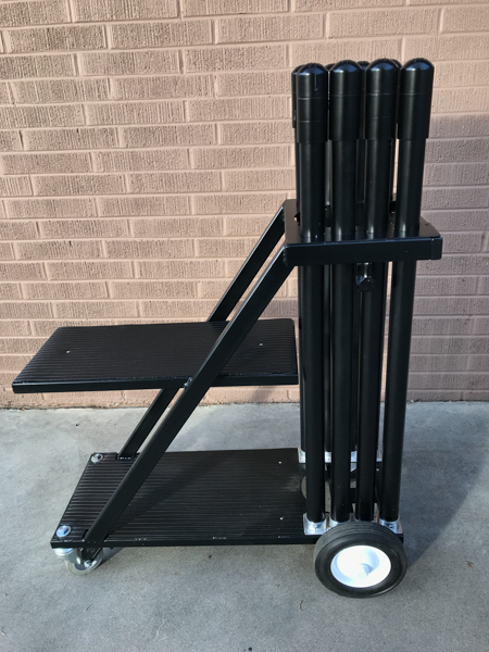

Made for my new tig welder and cooler

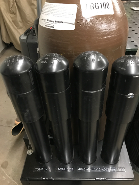

- How my filler wire is labeled

- Here it's all loaded with a new stainless drawer for my gas lenses and shorter filler wire

Would like to see some details on your axles and/or how you mounted that bottle on there.
I have a 125cfm tank I will mount to my cart.
My cart will be 12" x 28", with the upper frame being 20", so 12" W x 8" D for the tank/filler-storage.
For extra credit, did you make those filler canister/holders or buy them? I need some storage for that, I was thinking to just buy the ones at my LWS, they sell them for about $15/ea, I only need a couple. I like how they have a rubber to seal them. I only have one for my electrodes right now. I don't want to clutter your thread up with my rough plan, I will probably start another thread. But certainly would like to hear more about your cart.

The cart (frame) btm frame 12 1/4" X 31 3/4", upper frame (15" above btm frame) 10 3/8" X 23" total height 35 1/4"
The filler rod tubes are nothing more than 1 1/2" thin wall PVC pipe with caps
BTW.... This was my first TIG project too!

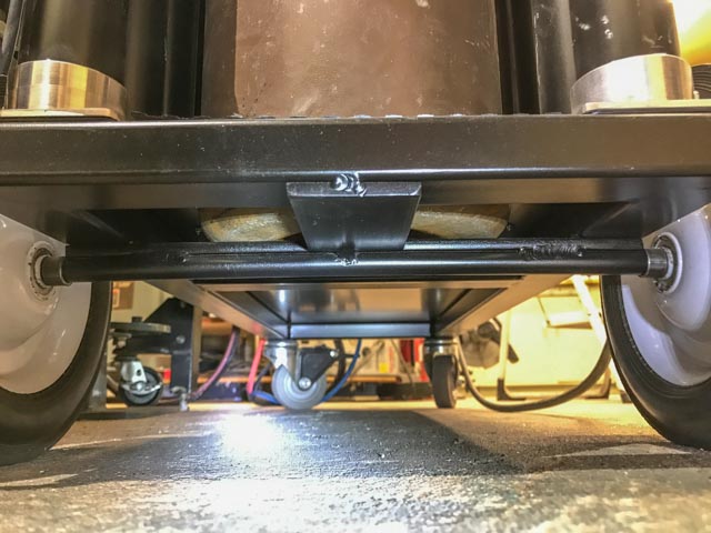

- Axle was welded on top of a 1/4" X 2" strap to bring them to the same height as my front casters. This strap is also the main support for the tank. Now is even stronger with the axle welded to it. The axle was welded flush with the back of the strap to maintain squareness. My wheels are held on with pressed on caps with 1/2" spacers behind the wheels

- This is how I attached the tank to the cart. They are 1/4-20 feet; but they are self adjusting to what ever they rest against. Theses feet are attached to a 1 1/2" X 2" tubing that is held in place by 2 screws.

td,
It's amazing how similar the carts are, I had seen a few carts, but I just started drawing this on paper and what I came up with. Yours is very similar size, single bottle, it's very close to what I came up with. I had thought of welding the axle on in a very similar fashion, or even just stubs welded into the frame, hadn't fully decided yet.
I see how those pads work on the gas bottle, is that easy enough to adjust when you refill the bottle? Have you refilled your bottle yet? Was just curious. Looks simple and secure.

- tungstendipper
A single axles keeps the wheels parallel.aland wrote:td,
Thanks for the extra pics, they help!
Alan
I never have to adjustment the pads; the cylinder diameter is always the same.
