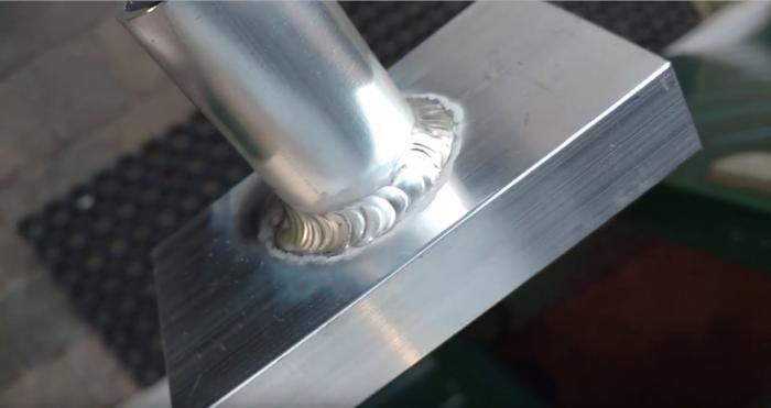

https://www.youtube.com/watch?v=HY30i_t1Da8
Here's a very helpful video that Jody made about welding AL box tube. He doesn't bother to restrain his tubing for tacking or welding other than third hands. No warping, no lifting, nothing other than aluminum behaving pretty nicely.

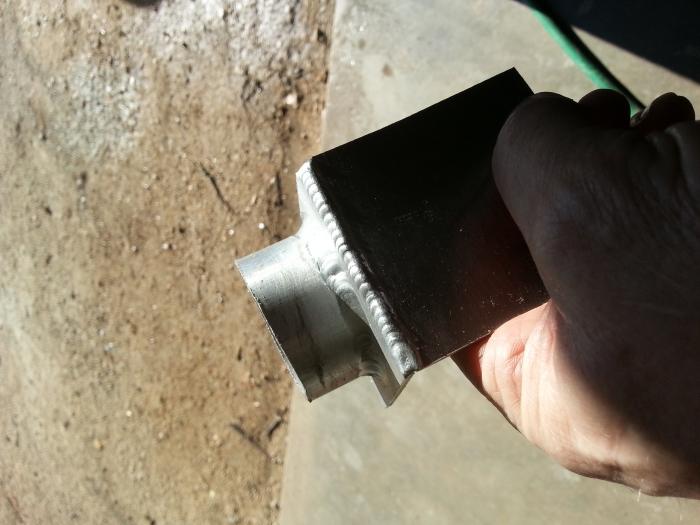

That is beautiful! Three weeks??? WOW! If you drill your bars into the box tube so that you're not relying on welds then you'll be fine. Most in-the-know welders won't make treestands or ladders out of AL because of the liability. Even ladder manufacturers use mechanical fasteners on their rungs or they bore and crimp them to eliminate the weak link, which is a weld. Unless you have 400 lb. kids I wouldn't worryBramR wrote:Thanks for the replies guys!
That is excellent advice, eliminates the single point of failure of the weld.

Pretty damn nice welds for doing ally for only 3 weeks! Nice job! Just make sure youre getting the weld bead down into the joint and penetrating. I only say this because I have made this mistake when I first started on ally and tried to weld pipe. It looked great on the surface, but when I cut it in half, there was a lack of penetration in the root of the joint. Kinda like it bridged over, and not down.
I would do as other have suggested though. Drill holes in the box tube and insert the crossbars. will be much stronger, and make life a bunch easier when youre jigging it up.

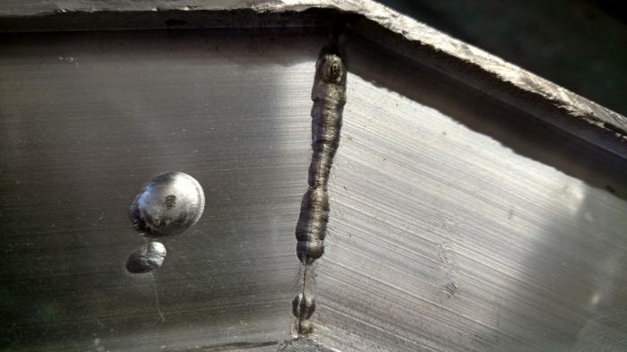

I sliced a box section in halve to check the weld. As you look close there is a line in the bead. Is this the residue of the oxide that floated on the penetration?
This is the inside of the tube.
This is the same weld from the outside. I think I started to cold, that is were there is lack of penetration.
(The black blob on the right tube is were I ran out of gas

Opps...we've all run out of gas.BramR wrote:I sliced a box section in halve to check the weld. As you look close there is a line in the bead. Is this the residue of the oxide that floated on the penetration?
1493399734973403799610.jpgThis is the inside of the tube.
1493399805033758253074.jpgThis is the same weld from the outside. I think I started to cold, that is were there is lack of penetration.
(The black blob on the right tube is were I ran out of gas)
Pictures make it hard, but are you sure that is not a crack running up the bead, that is what it looks like to me? Crank the heat up and burn it in...
Like others if I was building this Id drill holes, run fillets on the inside and button weld the outside if your go all the way through with the bars. Drilling as long as you can drill straight (LOL) will make alignment much easier.
That sure does look like a crack on the bottom of that weld. Even though it looks like you got great penetration, that bulging metal is your base metal that is sagging down and never fused together. Make a small gap between your pieces so when you weld, you will melt in on both sides and that will make a little keyhole that you will dip into. What you did was the same as welding over the top of a crack. Your welds sure look nice though.
Sure does and crack kills, so be careful with that. Before hanging anybody or anything on any item I build, I tend to put it to the ultimate retard test to make sure its all good.exnailpounder wrote:That sure does look like a crack on the bottom of that weld. Even though it looks like you got great penetration, that bulging metal is your base metal that is sagging down and never fused together. Make a small gap between your pieces so when you weld, you will melt in on both sides and that will make a little keyhole that you will dip into. What you did was the same as welding over the top of a crack. Your welds sure look nice though.
That's blistering on the back of the weld, from too much heat. It should look like the start of the weld where it was colder and you just see the original joint between the two pieces of material. Excess heat is also what causes the longitudinal cracking along the weld. I'd try moving a bit faster and/or reducing the current.BramR wrote:As you look close there is a line in the bead. Is this the residue of the oxide that floated on the penetration?

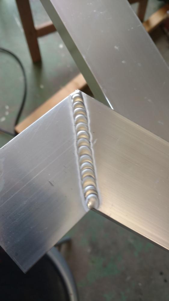

Guys, it's finished.
The good news is the welds are fine. The bad news is I probably should have used a bigger box profile. For the girls it's fine, for me it's a bit to flexible.
Could be that I'll make another one.
What a learner!!! There are some peppery joints. Mostly I think from my filler rod that got to far from the puddle. Or me trying to fill com a wrong angle.
Had a lot of fun & learned a lot.
- IMG_20170429_202528055.jpg (58.61 KiB) Viewed 2440 times
- IMG_20170429_203229282.jpg (62.47 KiB) Viewed 2440 times
I would have buttressed that angle with some 1/4 plate. Don't have my trig table out but hang 100 lb on it and the forces at that weld are likely over 1000 lb.
