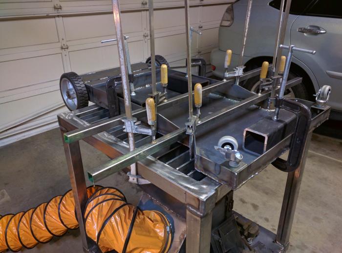

Built a welding cart in the ZT Fab style with a 12 gauge sheet 2'x4', left over 18 gauge 1" square tubing from a store display, and various lengths of 2", 3", and 4" .125 flat bar. I wanted the cart to hold two or more welders and two tanks. I found a barely used Lincoln 210mp on craigslist and had a lot of fun practicing mig. I used a plasma cutter to cut up the sheet metal parts.
I was so caught up on trying to make a good mig weld, I forgot about how much parts can and will warp. Really warped the sheet metal base when I fully welded (nonstop!) outside corner joints.
I ended up trying to correct the 1/2" bow by clamping the base upside down to my downdraft table then fully welding the inside corner joints.
Now the base only kicks up about a 1/4" overall.
I had fun bending the 4" x 1/8" flat stock with a small sledge-hammer and a wood vise.
I bolted down 210mp via the factory holes inside the cabinet and made a little hook out angle iron to catch the lip of the Everlast 160STH.
The cart turned out bigger than I hoped but it's nice to have the control panel buttons a little higher than my last cart. Just want to say thank you to all the members, most posts are educational and often entertaining at the same time.
