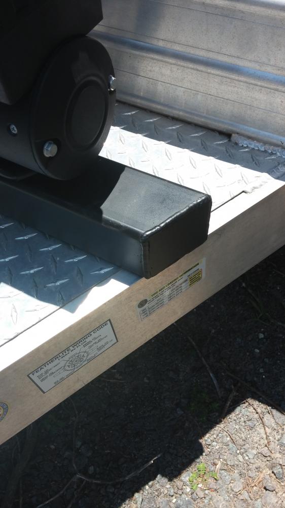

Put a wench out front....they wanted a steel mount. Bolts welded inside tubing and capped off. Quick and clean.

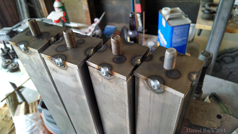

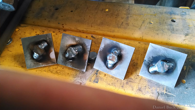

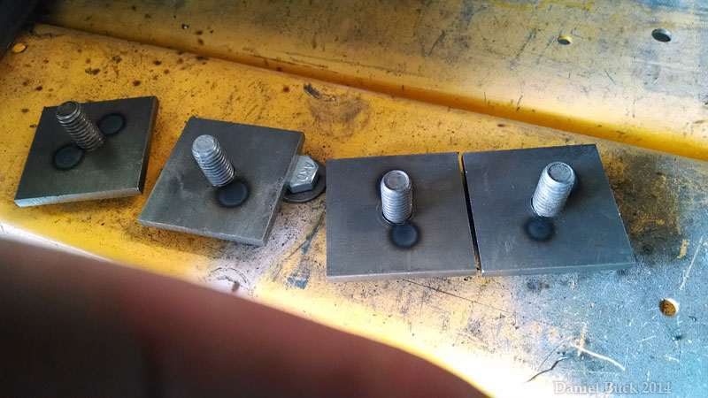

pretty simple stuff, just some table leg extensions to raise some tables up to standing height at work.
Just tacked these up for a test fit, they are good, so I'll make a bunch more.
push-in rubber/plastic feet will cap the other side of the tubing. I'll probably weld up the plates all the way around, just so they look better (and any welding practice I can get, I'll do!)
Looking good - if I may make a suggestion to help you get a better looking weld without a bunch of grinding - when you cut the cap pieces cut them smaller by just under twice the wall thickness of the box so you get an open corner weld & the cap will just sit on the tube without falling in - it's easier to follow especially if the eyes are getting old & as Mig tends to create a fair build up it will easily fill the open corner leaving a minimal amount of grinding - also taking the corners off helps.
First time mig'n in years.
A little dirty. Turns out my gas was turned all the way up. Lol
Went from 499 lbs in the tank, to none, in about 2.5 hours worth of welding, with breaks in between.
Gonna bring a wire wheel tomorrow.

Thanks for the tip! I'll have to try thatnoddybrian wrote:Looking good - if I may make a suggestion to help you get a better looking weld without a bunch of grinding - when you cut the cap pieces cut them smaller by just under twice the wall thickness of the box so you get an open corner weld & the cap will just sit on the tube without falling in - it's easier to follow especially if the eyes are getting old & as Mig tends to create a fair build up it will easily fill the open corner leaving a minimal amount of grinding - also taking the corners off helps.
Also had a question on a good way to hold the mig gun?
With stick I just wrap the lead around my arm so it isn't dragging me down/making me shake.
These mig guns we are using are like a bag of bricks. Lol
The only way I've found to take the load off is to create a prop for the lead a few feet ahead of, behind, or above where I'm working. A c-clamp or vise-grip, ot even a pipestand, to hold a chunk of the weight for me. When you set this up, do a dry run down the intended bead to make sure you won't have binding or slipping that will screw up your bead.79jasper wrote:Also had a question on a good way to hold the mig gun?
I believe Abcor Binzel has a belt clip for mig guns, will look it up a few.

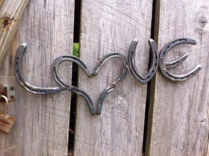

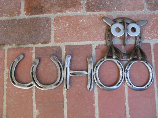

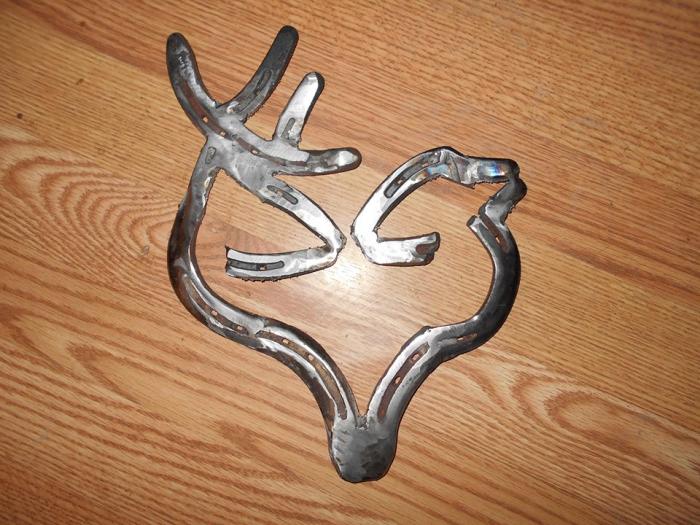

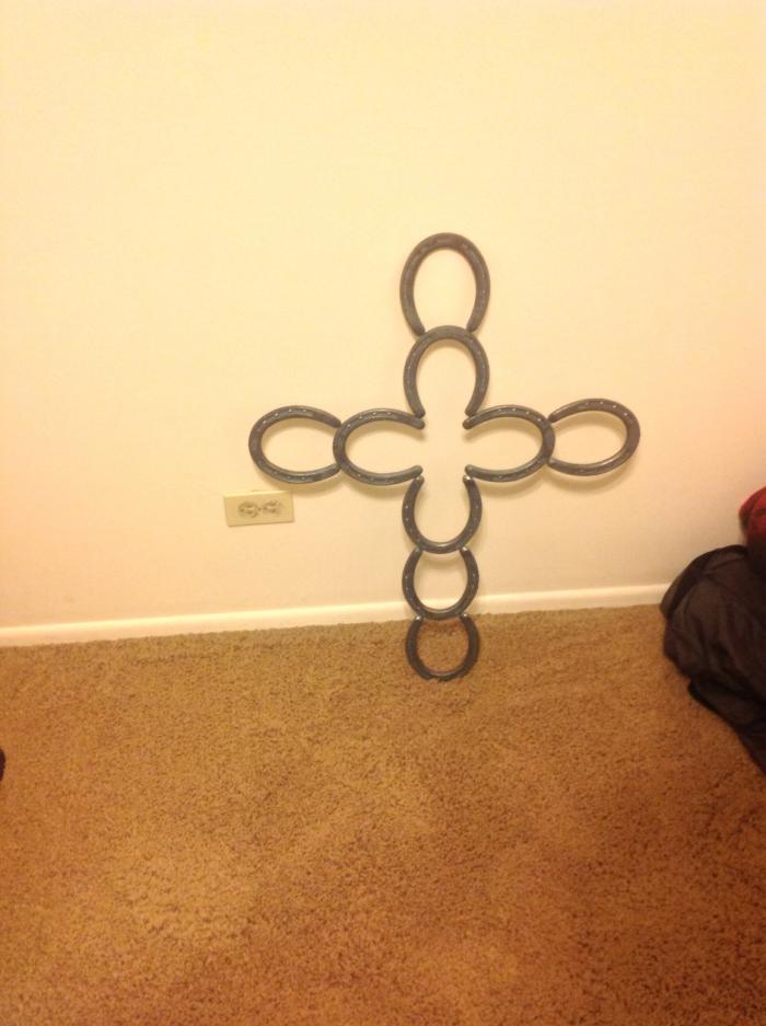

We make everything imaginable out of horseshoes. We have been making horseshoe art for over 2 years now and since February we have been making hand cut plasma art.

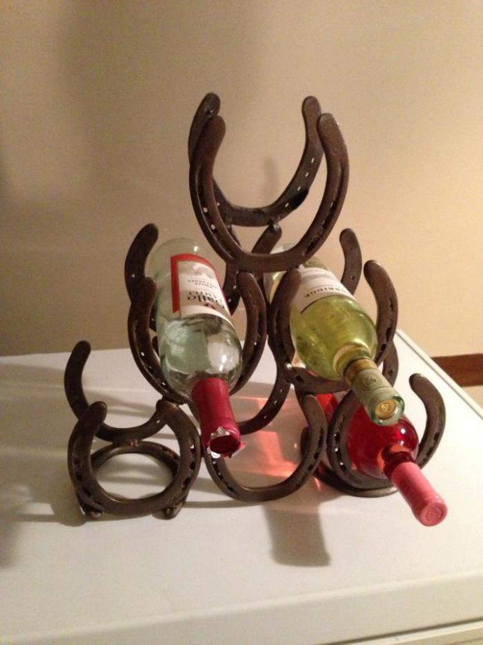

We don't put an offset on in it. The neck of the bottle rest on the one side and the base on the other and they offset themselves. We try to set our prices as if we are using all brand new shoes from the most expensive place. Our most expensive shoes are about $2 a shoe so we double that and add some for handling and we price our work as $5 a shoe. If it takes 5 shoes, $25.

Also with some, you want it to lean forwards.JDIGGS82 wrote:What'd you do to offset the wine rack just a shim in the middle back horse shoe I assume? How do you set your prices mark il n such?
Looks good.
Gonna have to try my hand at it sometime.
If anyone wants any to use any of our designs feel free to shoot me a message asking for some pictures. I don't mind sharing. Some people get all paranoid and afraid that people are going to put them out of business. Just ask

You are seriously undervaluing yourself. The thought and design has value, too.mcoe wrote:We don't put an offset on in it. The neck of the bottle rest on the one side and the base on the other and they offset themselves. We try to set our prices as if we are using all brand new shoes from the most expensive place. Our most expensive shoes are about $2 a shoe so we double that and add some for handling and we price our work as $5 a shoe. If it takes 5 shoes, $25.
I understand keeping prices down while establishing a reputation, but, in your case, I'd have to paraphrase Edison at this point, once you estimate a value, double it and add 10%.
Of course, you can't double your prices overnight, but if you pursue the right markets, you can gradually and constantly increase your asking price until you're in a market where your art makes you financially comfortable on it's own.
