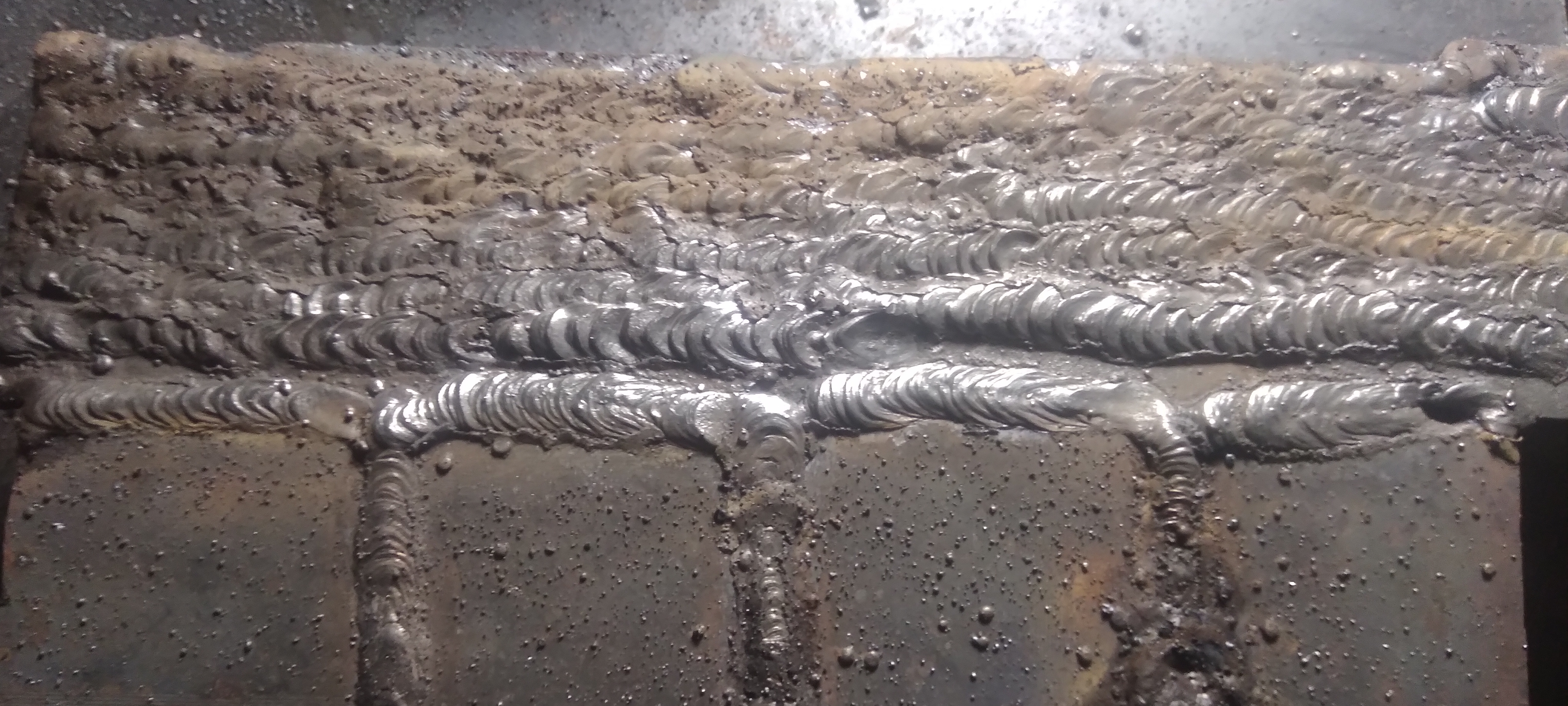

My goodness I am having a whale of a time trying to get a consistent stack-o-dimes bead. This shit is hard! I am noticing my positioning is shit, I always feel akward at the end of the rod. And its quite hard to fix for some reason... possibly retardation.

:lol: stack of dimes with a stick?
Anyways sounds like you may need whip it a bit in the direction of the weld may help, you know lay some weld move forward a bit and smoothly whip it back on itself and so on. 6010s would not be choice for that. 7016s or 14s would do that nicely. If you can find some 24s then they would work neatly but only downhand or fillet.

I respectfully disagree. With about 4-6 rods of 6010 (or 6011) I can dial in my brain and the machine semi-decently to get stacks.

Yup, you can stack dimes with a 6010 very well, In fact I used to think the whole stack of dimes thing came from an expertly stick welded 6010 bead rather than tig, and I still wonder if the term might have originated there. I wish I still had my Invertec 275 to run some Lincoln 5+ and really stack some. But, as always, how well 6010 if at all will run on your machine and what kind of 6010 you're running makes a huge difference.

Yeah my biggest problem is the gap between each 'dime' or whatever is not the same, and often times I seem to have them spaced too far apart.
There was some sort of moment happening on the last 20 or so rods I used, where I was super concentrating on the puddle, and not much on where exactly I was whipping to, so that it was easier to come back to the correct spot after the puddle cooled. That seemed to help.
I was welding on like 30mm x 5mm flat bar, where I had 6 or so lengths in parallel. When welding those together I put like a wee 1/8 gap and tacked the ends. No bevel or anything ( did not want to wake neighbours up from grinder at midnight ), but it was really cool how it behaved in gaps. The first few the weld kinda only went half way through, but after trying different things it went all the way through to the other side. Not super pretty, but it poked out the other side. Was quite fun! :)

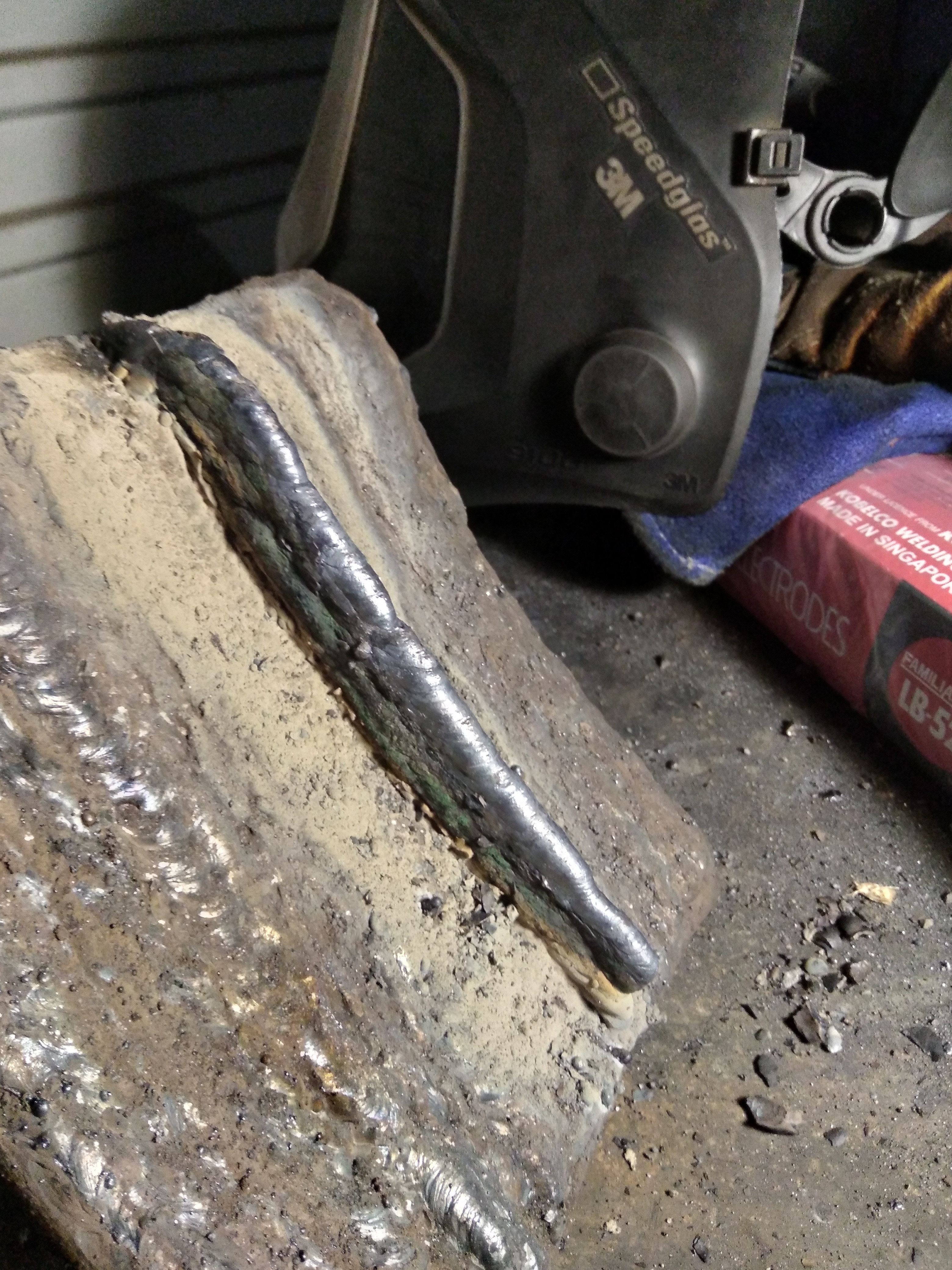

Wowzers, I was playing on an over welded practice plate, and thought, 'fuck it, I feel like Trump, I'm going to make a wall''. And I started trying to lay a bead on top of the same bead, over and over... and I am not sure if its bad or not, I was using 7016 at the time, but I found that 'whipping' it slowly forward, and then slowly and deliberately back, really really made it easy to build up the blob of metal to exactly where it needed to be.. it seemed to 'push' or shape the molten metal somehow, it's kind of hard to describe. This was on vertical up.
I dunno, it might seem really boring to you guys but it really felt good somehow, it suddenly felt like I had fine control of the metal build up for some reason :) The arc could sort of 'blow' or 'push' the molten puddle into position, but it did not feel hurried, it was 'yep, thats good' and cruise on to the next build up cycle. Really quite satisfying :D
If I can get it to an inch I will take a photo :)

Not quite an inch (that's what she said) but it was fun :)
