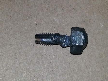

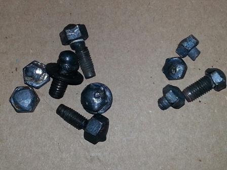

Lately most of my welding is removing broken bolts or taps. Welding is also one of the easiest ways to remove valve seats from a cylinder head. I must say that I would not have attempted the bolts before viewing Jody's video, and the tap would have been sent to the EDM shop. Although, I have been removing seats this way for years. In the old days before I had a tig welder we would do it with stick arc.
- valve seat
- sear.jpg (54.09 KiB) Viewed 3242 times
- broken tap
- tap.jpg (62.03 KiB) Viewed 3242 times
- bolts
- weld.jpg (61.93 KiB) Viewed 3242 times

Sometimes the tap my not come out, but you gotta try. And the small ones, smaller then 6-32 are a real PITAAlumike wrote:Lately most of my welding is removing broken bolts or taps. Welding is also one of the easiest ways to remove valve seats from a cylinder head. I must say that I would not have attempted the bolts before viewing Jody's video, and the tap would have been sent to the EDM shop. Although, I have been removing seats this way for years. In the old days before I had a tig welder we would do it with stick arc.

In my former life as a heavy equipment field mechanic I often had broken bolts in caterpillar undercarriages and the like. I usually used 3/32 LH90 to remove them. If they were broken much below flush, I would put a small piece of tubing in the hole and weld inside that. On larger and particularly stubborn ones, I would drill in the center if possible then weld the hole in. This will shrink the bolt. It was my good fortune never to break any small taps.
Cheers.
Eldon

At work we use a welding rod especially made for removing broken bolts/studs. We buy them from Lawson, it really saves our bacon with the Sterling trucks, they break exhaust manifold studs like crazy. And almost never flush or proud, always break below surface ugghh!

Thanks gentlemen, that gives a good range of options.xwrench wrote:In my former life as a heavy equipment field mechanic I often had broken bolts in caterpillar undercarriages and the like. I usually used 3/32 LH90 to remove them. If they were broken much below flush, I would put a small piece of tubing in the hole and weld inside that. On larger and particularly stubborn ones, I would drill in the center if possible then weld the hole in. This will shrink the bolt. It was my good fortune never to break any small taps.
Cheers.
Eldon
