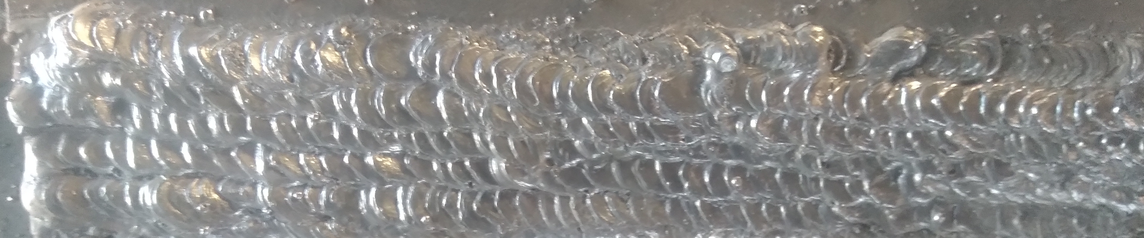

Pulse with 6010 is interesting. The top 4 or 5 wonky rows of beads is using 1.2 Hz, 50% balance, 2.5mm 6010, 60 Amps average, and 10 bourbons;
Only just started dicking with it, but pretty much I waited for it to go 'booop' with the high current part, then moved slightly to the edge of the puddle, and waited for it to go boop again.

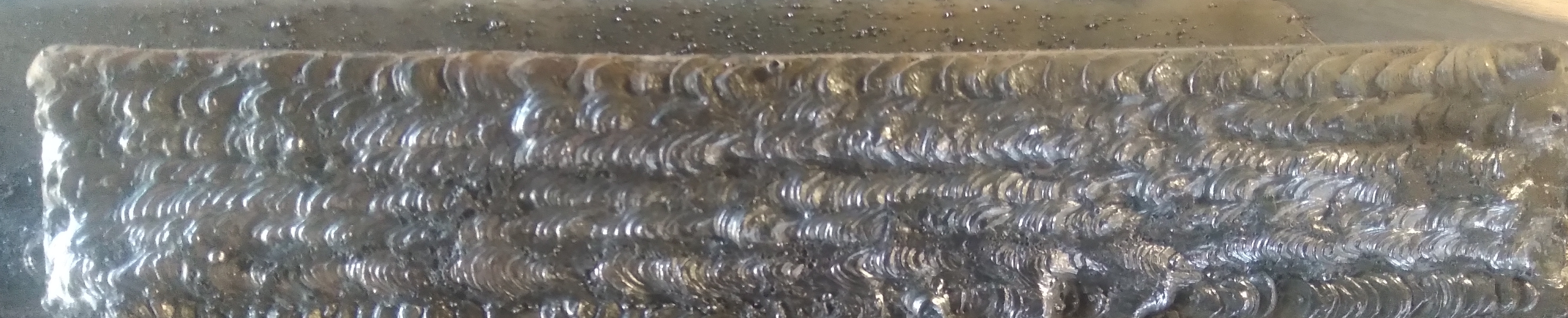

Here is two runs where I was _trying_ to ramain at a constant travel speed; The top one is 1.2 Hz, the bottom is 2 Hz.
Its actually kind of hard to remain constant when it pulses, because It feels like you should whip forward for some reason. Perhaps more bourbons are required.

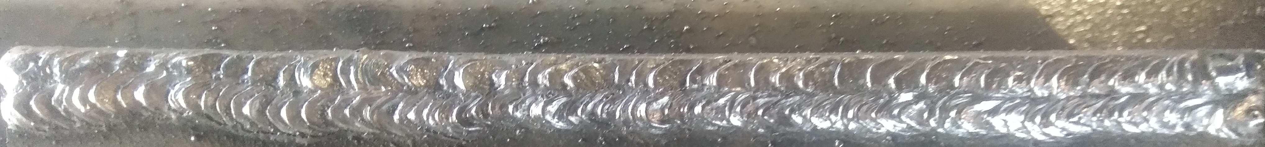

the next 4 are at 2.5, 3, 4, and 5 hz.
I know what you are thinking; you are all jealous of my amazingly straight beads and super consistent travel speed. I thought I would post them anyway, just as some sort of idea of what the pulsy thing does when used by a monkey.
