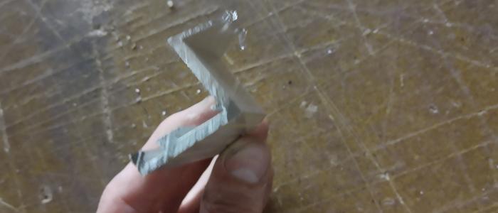

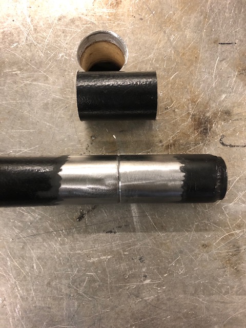

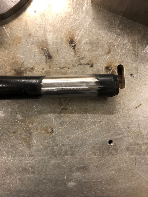

2" reduction on some threaded control arms that were incorrect lengths. Just a handful to do. The parts are much bigger than what is pictured, and quite clumsy, so a bit of a chore.
And I did fill that little crater at the end...woops.
Thanks for the kind words. Get you some razor blades to practice on as you're learning. IMO, it's the ultimate way to try and master heat control, and all other aspects of laying down a good TIG bead. It forces you to either do it well or destroy the part...not a lot of in between. Great practice tool.DavidR8 wrote:Just wanted to say that as a newbie, seeing all your good work is inspiring and also daunting!

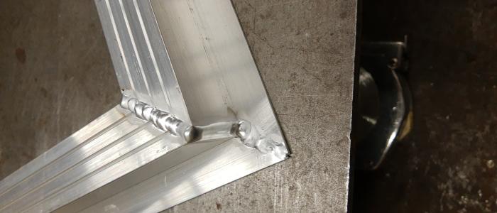

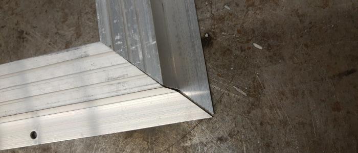

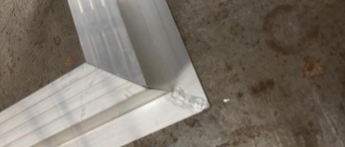

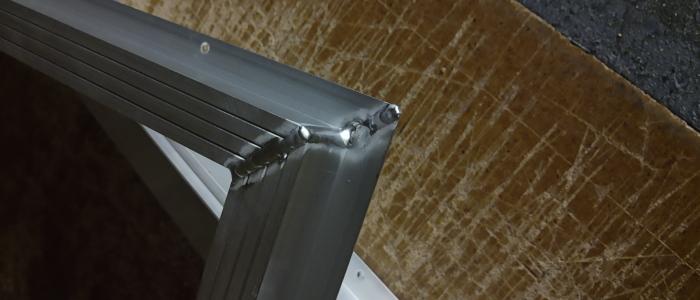

Just for fun I took some pics today of some window frames I was welding up. These are particularly difficult because of all the variation in thickness. Most of you will laugh at what they look like because they are not Instagram level weld. Just trust me when I tell you this is not as easy as it looks. The number of thickness changes, the requirement to not burn the edges away, and the amount of heat you have to apply to a part that goes thick and thin in a matter of 1/8 of an inch, I'm telling you it is tricky.
And you should see it when there is aluminum mesh in the frame, pressed in place and sinking all the heat out like nothing you have ever seen sink heat from a part.
You start on a 16 gauge aluminum Corner that has an opening between the two parts. You can't burn away the corner. Then you have to weld the main framework using filler rod and then do a Fusion weld on the corner. All of that has to blend together. You use three different settings on the welder for the three areas. Anywhere from 70 amps on the 16 gauge flange up to 155 amps full pedal on the face. The fusion weld outside corner is easy all except for where you have to blend into the 16 gauge flange.
The 16 gauge part must be done in two steps because you have to start in the center and work toward the point at the outside, then you go back and work the other direction toward the thicker Fusion outside corner. Otherwise you can melt the corner away or burn holes through which is no good.
- IMG_20200623_164942362.jpg (24.69 KiB) Viewed 4614 times
- IMG_20200623_164350249.jpg (28.06 KiB) Viewed 4614 times
- IMG_20200623_163859077.jpg (18.67 KiB) Viewed 4614 times
- IMG_20200623_161834481.jpg (30.5 KiB) Viewed 4614 times
When I post from my phone the pictures post in reverse order so that's not so great. The last picture or I guess the first picture in the list, that shows the view from the inside where you are not welding. You can see that the thickness varies by 300% multiple times as you go across the surface. That's over a course of one inch and don't think that you can just gloss that over. Here is a picture of the cross section that you are welding. Minus the corner clip of course.
- IMG_20200623_165307077.jpg (19.73 KiB) Viewed 4611 times
- IMG_20200623_165103875.jpg (26.25 KiB) Viewed 4611 times

nice work buggy. Have you given any thought to some type of backing plate. I know the shape of the extrusion is difficult to fit, but, anything might be of help. Just tossing a thought
Backing for where? I do the .0625" part laying flat on the steel welding table. That's all the heat-sink I get. The other parts are pretty well immune to burning through, and the fact is, I'm actually short on heat in areas, not over heat. It takes a good bit of pedal variation to get a consistent looking weld, and even then, 'consistent' is relative to 'awful'BillE.Dee wrote:nice work buggy. Have you given any thought to some type of backing plate. I know the shape of the extrusion is difficult to fit, but, anything might be of help. Just tossing a thought
That top part for instance, I run that from the inside corner to the outside corner. Set to 155A, you start off lighting up on the inside corner, and that area is actually fairly thin, so it forms a puddle pretty quick and you're on your way. It's so thin there you have to be careful about the hot-start undercutting the corner. You're only running about 1/3 pedal. Then you no sooner dab one time and 1/8" later you're foot is to the floor and you almost require more than 155A to continue because of that thicker material underneath sinking the heat away. It even has 'fins' if you look at it, so it's not just thicker, it's got additional surface area carrying away heat, then that ends and you're back to a thinner part, then back to thicker again, then tapering off for the outside corner. All in a 1" span...

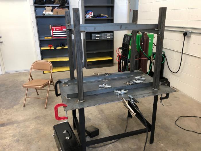

A little Sunday welding for myself. Smallish welding/utility table to add to the shop made completely out of scrap, which is a very satisfying price tag. Quicky job for sure, so nothing pretty or fancy. Top is 1/4" thick steel plate (48"x32"), and legs are 1/4" thick, 2" angle iron. Legs welded directly to the top with stringers on three sides and an angle iron stiffener welded lengthwise across the bottom of the top along the center for a bit more rigidity. The legs were quite rusty, so they got a coat of paint. It was actually A LOT more grinding prep than it was cutting or welding
She weighed in at 170 lbs when done.

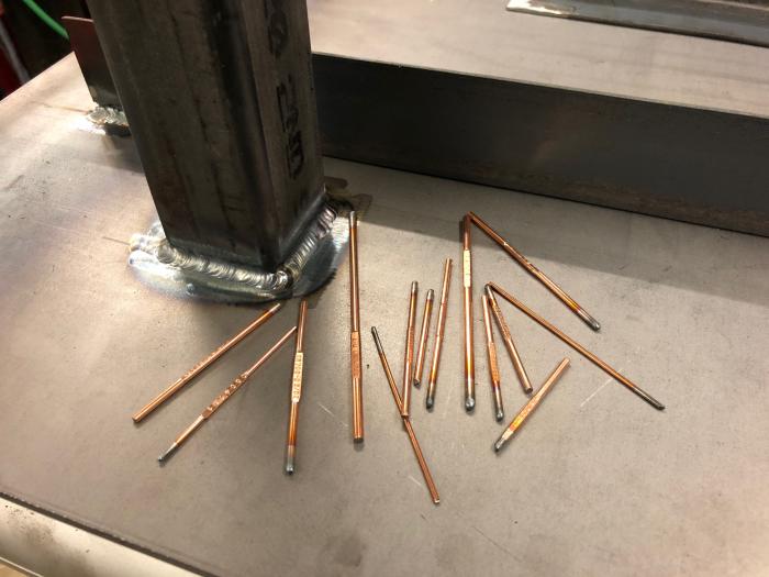

I just burned some 3/32 excalibur stubs for restart practice I was given in class to take home. When I ran out I burned some Hobart 7018 to fill up the rest of the plate. Edit: Absolutely no idea why it insists on flipping the picture, the original is right side up and I've even tried cropping it.

sbaker, you are closing in ,,, be patient and pay attention to the way you're moving. do some practice by moving the amps, just a bit and run beads side by side so you can "see" the difference.

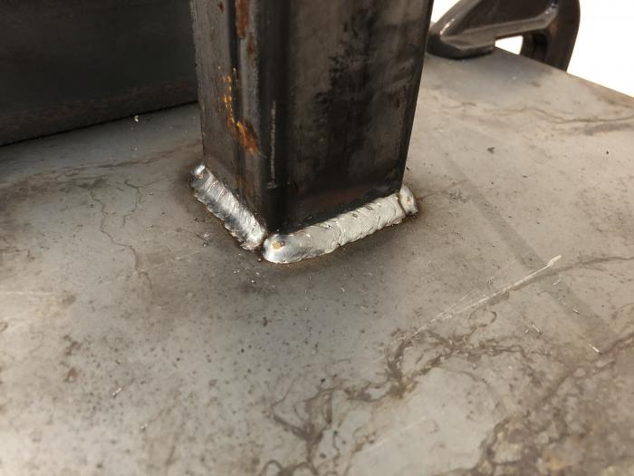

Another small parts welding table. My MIG hand is coming back. Slowly. Been years. But it's 4x faster than TIG by my watch. This was one where I did not clean the mill scale. I started cleaning the mill scale... wasn't too happy with how those toes were whetting in

That means it's possible that it's 40x faster than MY tig.Spartan wrote:But it's 4x faster than TIG by my watch.
Looks good, I'm no expert but it does seem you could turn the amps up a tad to wet into the base plate.

Completely agree. Turned up the voltage a bit for the other run in the pic which is on the left, better whetting, but still not great. Lesson learned: Grind the mill scale first. I did that for the table I made after that one and it all went much better, but didn't take any pics. That one is still sitting half-done on that same reference table, so I'll try to get some pics of that one when I'm back in the shop sometime this weekend.TraditionalToolworks wrote:That means it's possible that it's 40x faster than MY tig.Spartan wrote:But it's 4x faster than TIG by my watch.![]()

I think you have your answer on the mill scale right there. It is the way you would do it for yourself.Spartan wrote:Grind the mill scale first.
Teach those guys working for you to properly clean the mill scale and that will save you time and grief in the end, IMO.
