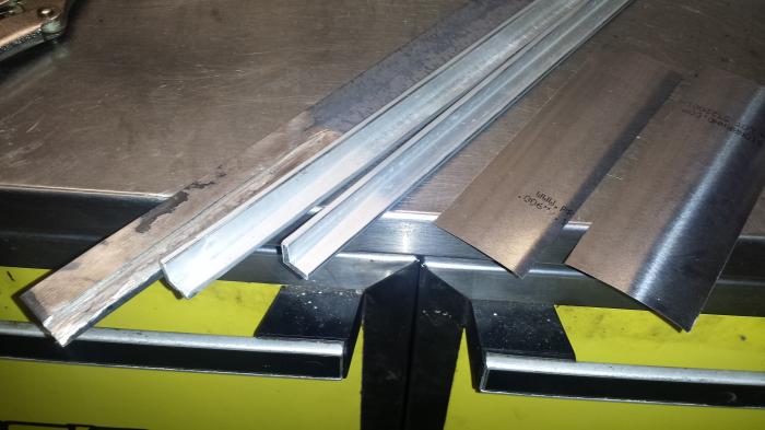

Mr. Tig on YouTube welded aluminum foil together. The way he done it is the way you would have to do this. Clamp the material intended to be welded where only a fraction of the material is showing. Then when you make your weld, the exposed thin material would be welded in a controlled manner.
To do this, you would probably have to get precision pieces made just to clamp the thin material and act as a heat soak.

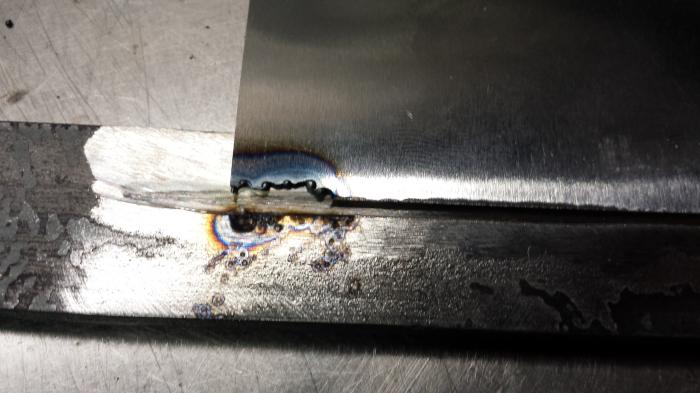

Im going to try some welds to see if this is even possible with tig, I found some .006 steel that I will try welding together and try welding it to some thicker material to simulate the flange. Hope to try it tonight on the way home.

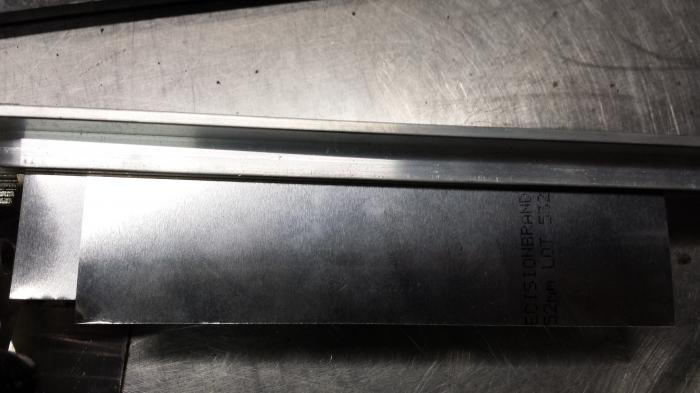

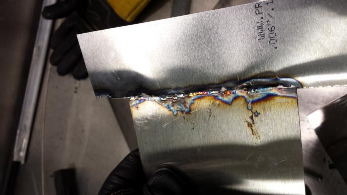

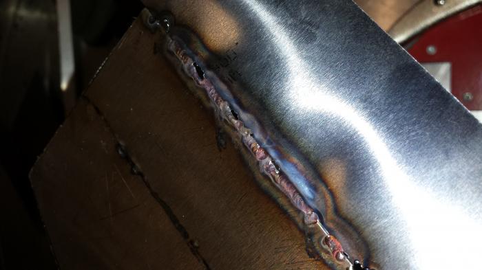

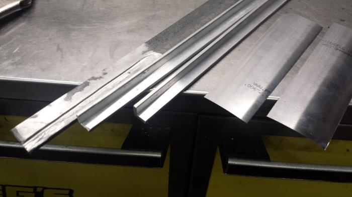

......and the results are in! This was definitely a challenge, but I don't know if I proved it possible or not since I didn't make the welds as good as I was hoping.

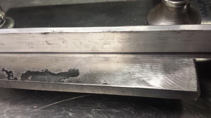

First I tried grinding a ledge into a piece of 1/4" flat stock. What I found was it took so much heat to try to puddle the steel, as soon as I got close to the .006 steel, it melted away before I could make any weld.
I had some 20ga stainless so I tried again with that, this time I was able to make welds. I actually tried twice because the first wasn't anywhere near what i was hoping for. Surely after the first attempt I could make a solid weld.
Well the second attempt was more controlled but like the first, several spots were blown away. At least one hole because of accidently hitting the foot pedal.

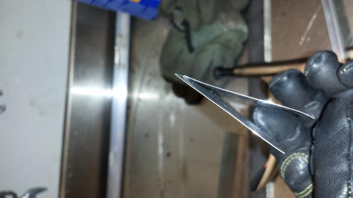

Then on to welding the two thin pieces together. I already knew how I wanted to attempt this, the same way Mr. Tig welded aluminum foil together. I sandwiched two pieces of .006 between aluminum and had 1-2mm sticking out. It left a messy edge but the two pieces are securely welded together.

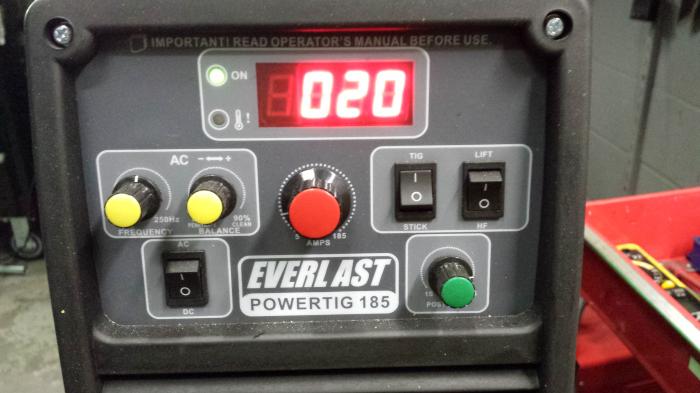

What were your settings? I haven't been able to locate anything at work yet except my feeler gauges. Lol I want to give it a shot as well. I'm thinking I could get some pulse settings right to make it work just need some scrap.
I just did some .012" spring steel at 13 amps, I did basket with a piece of bronze

Something to know at these power levels, the HF start may be higher than the welding amps, so it's easy to blow a hole right off the bat.
When fusing wire frame using 0.045 wire, I found that pulsing helped a ton on the thin stuff, and I was working in the 7-amp range. But I also discovered my Everlast 210EXT was set to like 35A for the HF arc start - it was adjustable, but in a hidden menu.
