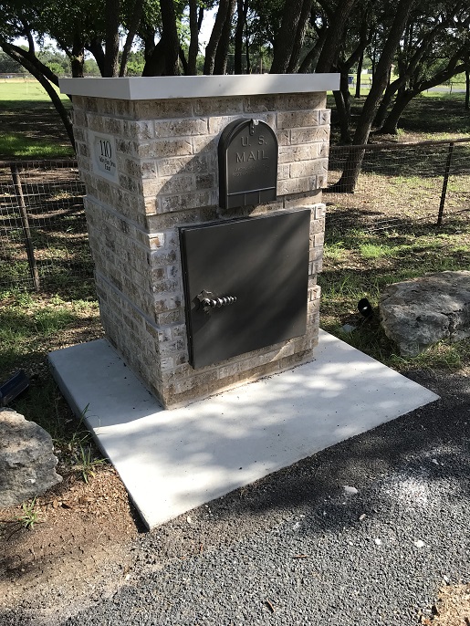

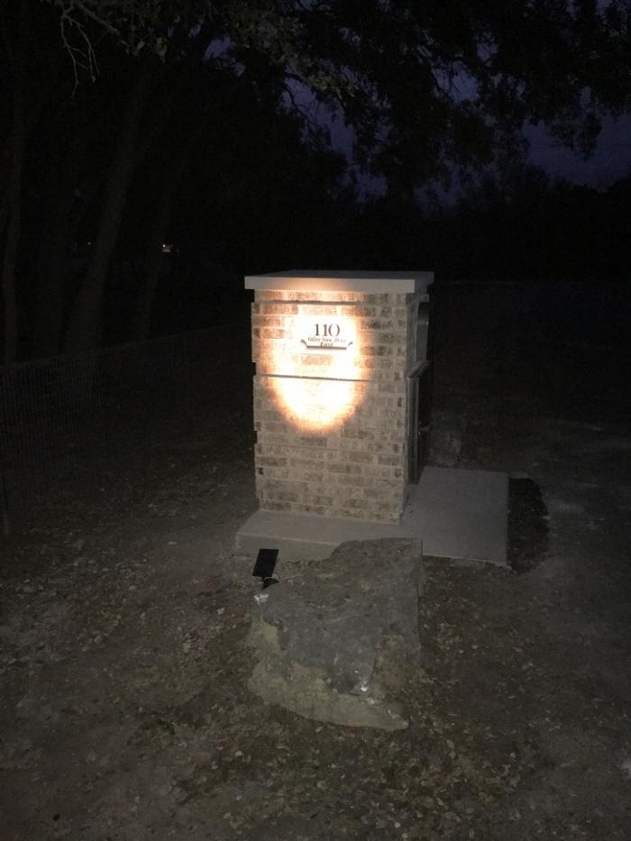

TraditionalToolworks wrote:Curious about your mail drop and how you designed it. I've pondered about that and what I would do after I build a gate. I don't want no stinkin' delivery trucks up my driveway.
I agree. I also never liked the idea of whoever being able to pull into my driveway, be it a delivery outfit or otherwise. Installing a fence and a big-time gate fixed that issue straight away, 'lemme tell ya. Good stuff. Regarding the "mail center", I chose to purchase the "big boy" variant of the standard mailbox that anyone can purchase off of Amazon. I did that but needed to modify the "I have outgoing mail" flag a bit. So I ended up putting that onto a drawer slider so that it could disappear into the brick if/when not needed, which is most of the time. Otherwise there would be no means to "retract" the flag as it were. So that is for the USPS regular postal service only. Fine. Now for deliveries (to include USPS) I built a 28" x 28" x 40" box. It was comprised of 16ga sheet and 1/2" x 1/2" 16ga steel tubing for support. The door was built from the same sheet and tubing, along with "decorative steel" pieces from that type of metal supplier in Dallas. If I had it to do again though, I would go with thicker sheet and 86th the support bracing. The 16ga needed it though, so in that context it was understandable. And address plates on the sides dontchaknow. Prior to installing the fence I had a couple-to-a-few people pull into my driveway, in the dark of the night, asking if this was "10 valley", when it is "110 valley". They claimed to be purchasing something from Craigslist. I wouldn't have done that personally and didn't like it being done on my property. I mean it's pitch dark save the few house lights, we're on acreage, there is no sidewalk, there are no street lights, it's a rural area and this IS TEXAS after all, where folk have guns on-hand for home defense and that's beyond normal. Anyway I grew tired of that crap quickly. After I learned of those jewelry thieves who would show up at your house in response to a Craigslist ad, then rob you at gunpoint, sometimes killing the home occupants, well things changed. The fence went in as soon as the budget would allow and I discontinued selling anything on CL from the house. Met folk at store's parking lot somewhere, in full view of CCTV cameras and lots of people milling around. I digress.
Anyway a few pictures. This was during the build:
build 1.jpg (73.62 KiB) Viewed 9106 times
The result:
overall result.jpg (229.41 KiB) Viewed 9106 times
And some solar-powered lights for night ops:
at night.jpg (61.41 KiB) Viewed 9106 times

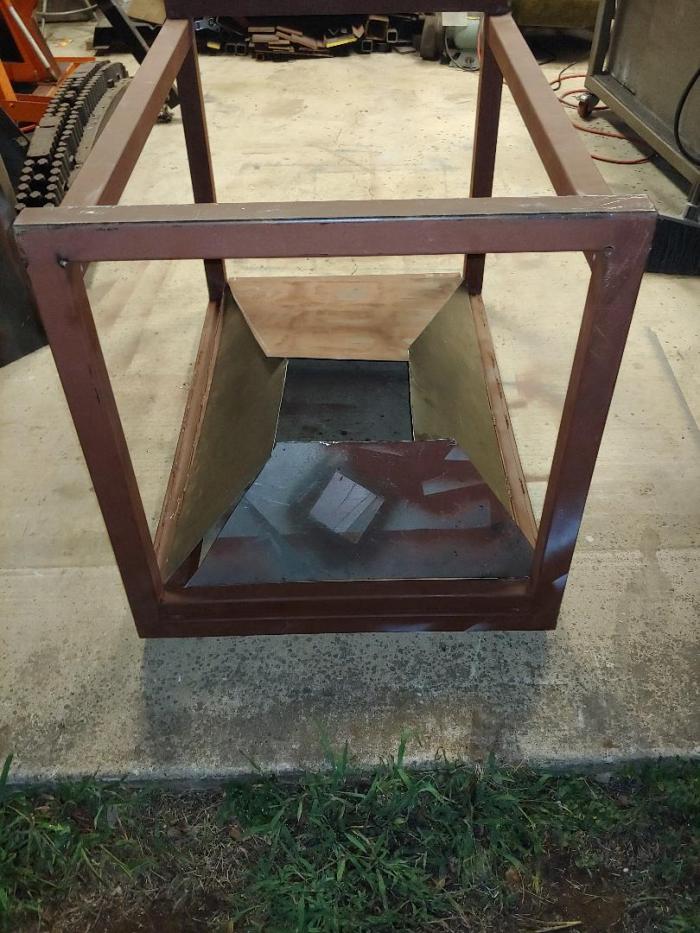

And here are the pictures of the no-hands test fit:
collector 2.jpg (54.96 KiB) Viewed 9092 times
collector 3.jpg (103.59 KiB) Viewed 9092 times
Then it was time to clean, lock up the outbuilding and get inside to help with the lil' un. Hopefully I'll have time tomorrow night after work to weld the collector to the table. TBD.

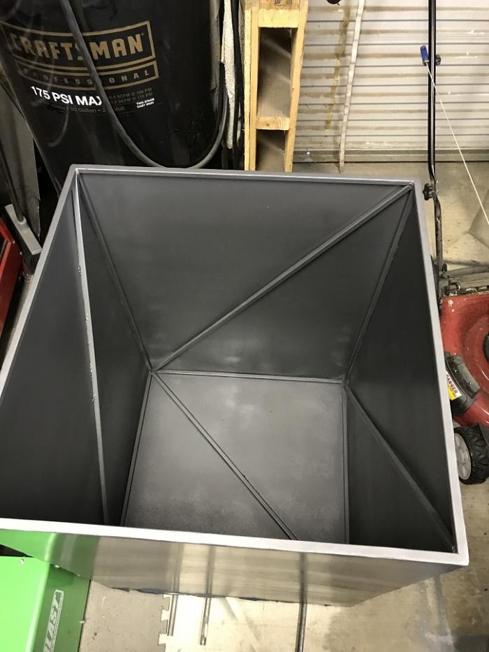

av8or1
As per normal, my available time in the workshop tonight was limited. I did manage to tack the 4 collector panels into place and apply rusty metal primer. They still need a little touch-up but are for the most part ready to go.
collector 4.jpg (75.49 KiB) Viewed 9047 times
collector 5.jpg (206.25 KiB) Viewed 9047 times
The plasma itself is supposed to arrive tomorrow. The air dryer that I ordered for it is also supposed to arrive tomorrow. If that is the case, I may use the plasma to cut the diamond plate for the table floor. Why not? :)

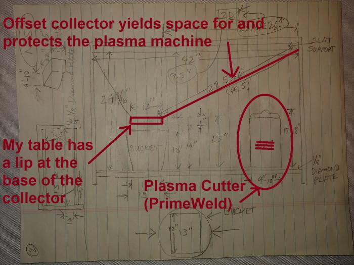

Jerry,
Looking good. I've seen the chute offset like that in the past, what's the purpose of offsetting it rather than centering it?
Collector of old Iron!
Alan
av8or1
TraditionalToolworks wrote:Jerry,
Hi Alan,
Yeah it is an offset design. The purpose is merely to make room for the plasma cutting machine to live underneath the table and on top of the lower shelf. I factored this into my design from the outset:
collector 6.jpg (54.7 KiB) Viewed 9035 times
Though I'm hardly the first to employ this design. Here is a snapshot of a similar build that was done by a guy in Europe somewhere:
europe guys table.jpg (41.82 KiB) Viewed 9035 times
His offset is a little more extreme than mine (referring to the angle). Not by much I suppose. The bucket he uses is taller, which is the reason for the steeper angle. My bucket will just be the one I picked up from a box store a few Christmases ago when we actually had cold weather. I built a fire in the fireplace that year, which was the first and still-only time we've used the thing in the 11 years we've owned the house. :D Furthermore, my design incorporates a 1" lip (for lack of a better term) at the base of the collector whereas his does not. Not a big deal, but I liked the idea of that lip being present to further marshal the crusties and dross into the bucket.

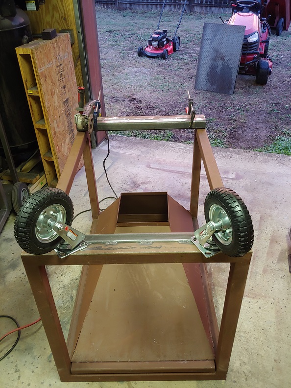

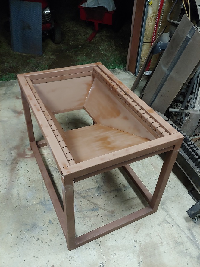

av8or1
So ... the evening began well enough. I had a whole cart full of goodies for the plasma table project:
parts 1.jpg (228.47 KiB) Viewed 9011 times
The sheet metal was extra, granted, but everything else was intended for the table. Given the recent rain and the need to shuffle stuff in-and-out of the outbuilding, my priority tonight was to get the casters installed. Because this table will need to be used outdoors or at least wheeled around outdoors, I decided that the first set of wheels would need to be pneumatic. And so I went with a set of 8" casters:
wheels 1.jpg (62.43 KiB) Viewed 9011 times
That decision would represent a compromise that in the end I wasn't all that happy with, but more on that in a minute.

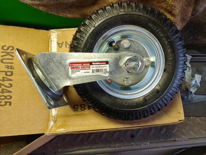

av8or1
WRT the building of a work table of any sort, these are huge. The wheel itself is 8" and the overall height is 9.5":
wheels 2.jpg (66.66 KiB) Viewed 9009 times
This, as mentioned, is the compromise that I need to make. At least for the time being. I've simply exhausted the available space in my outbuilding. For that reason, this table will likely need to live outside the majority of the time. And that means moving around on unpaved surfaces, usually plain-ol' grass-n-dirt. I'll pull it inside to use it when needed. In that use case scenario, to install thin, small casters is futile. We are on the hunt for a new-to-us property with a larger workshop, but until then I have what I have. Perhaps at that point I can modify the table to have more suitable casters. In the meantime, it is what it is. And what it is is entirely TOO TALL. I'm only 6'2" and it comes to just a smidge above my belly button. With "shop casters" however it would be the proper work height.
As with most any project, it's all about tradeoffs. And however ugly this one is, I'm willing to live with it for a while. So with that in mind, it was time to get-on with installing these things. I decided to just minimally weld these onto the bottom of the table, then use a sawz-all to remove them if-n-when that day comes 'round in the future:
wheels 3.jpg (222.88 KiB) Viewed 9009 times
av8or1
Being careful 'course to first grind off the zinc plating:
wheels 4.jpg (137.36 KiB) Viewed 9008 times
And wear a respirator just to be sure. Then drink milk afterwards. :D Ok so they were done in no time and I spritzed them with a dose of rusty metal primer:
wheels 5.jpg (211.86 KiB) Viewed 9008 times
av8or1

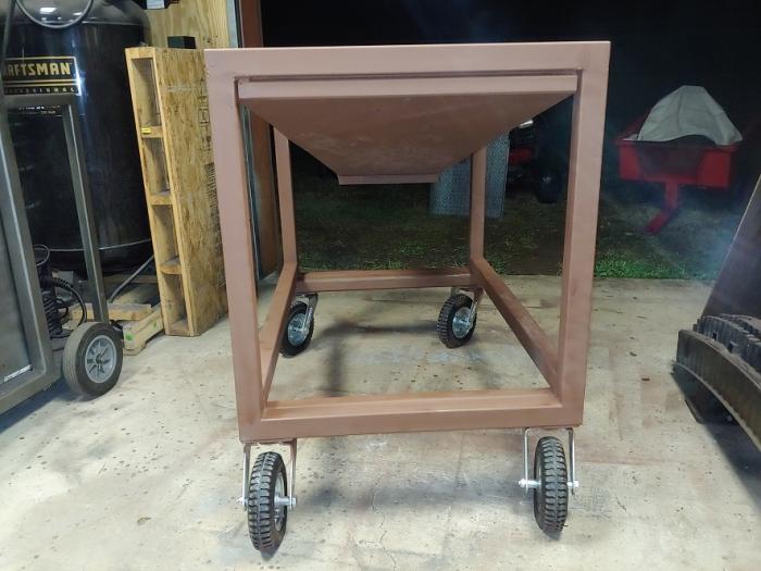

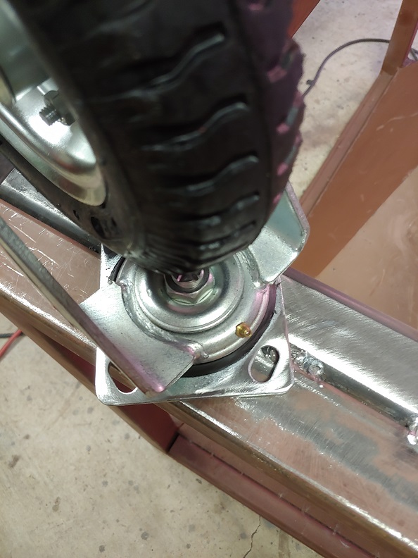

It indeed sits a bit proud:
wheels 6.jpg (50.73 KiB) Viewed 9008 times
Other than that however the mobility endeavor came together well-enough. I coated everything including the slats with a good spritz of rusty metal primer since it'll need to be outside for a while:
wheels 7.jpg (203.47 KiB) Viewed 9008 times

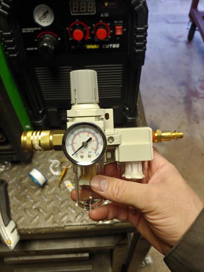

av8or1
I found an air dryer composite online that had good reviews:
dryer 1.jpg (46.63 KiB) Viewed 9007 times
So the plan is to build a bracket and mount it to the side of the table such that it will rest just above the plasma cutter's control panel. I'll need some short air hose too; unfortunately all that I can find at the local box stores is 25' or longer, so I may have to source that online too. Sigh. Anyway the box's contents:
dryer 2.jpg (239.5 KiB) Viewed 9007 times
The plan is to have this finished off by the end of the weekend for certain. However given that it is a holiday weekend and that we're supposed to receive even more of the wet stuff ... we'll see.

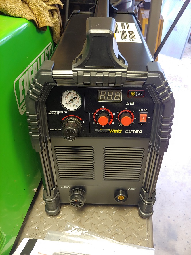

av8or1
Alright so we had family stuff to do for the majority of the day. Daddy grilled steaks in light of the holiday weekend and all was well. :D Afterwards I was able to make it to the workshop. The goal for tonight was to unpack the CUT60 and put it to work. Its first task would be to cut the 1/8" diamond plate that will serve as the bottom shelf. And so here we go...
The box arrived yesterday (Friday) and was well prepared for shipment:
plasma 1.jpg (63.69 KiB) Viewed 8978 times
Internally packed well too, with the machine being fully covered in Styrofoam and boxes that fit snugly within the outer box:
plasma 2.jpg (60.67 KiB) Viewed 8978 times
Thus first impressions were good.

av8or1

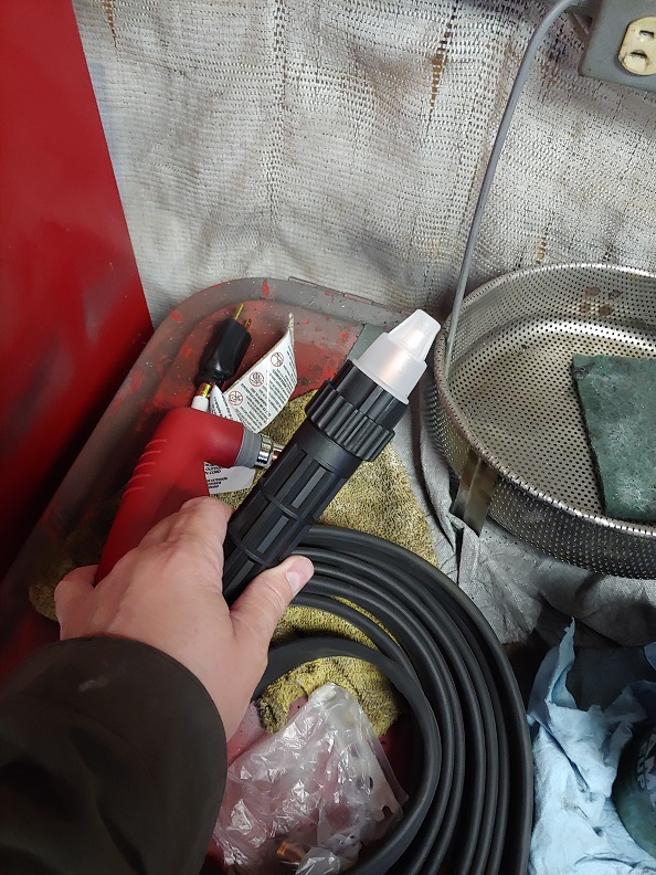

The torch is a pilot arc (PT60 blowback):
plasma 10.jpg (57.27 KiB) Viewed 8988 times
And it came pre-assembled:
plasma 11.jpg (48.53 KiB) Viewed 8988 times
Which was cool, but I took it apart to verify that everything was present. It was, so thumbs up.

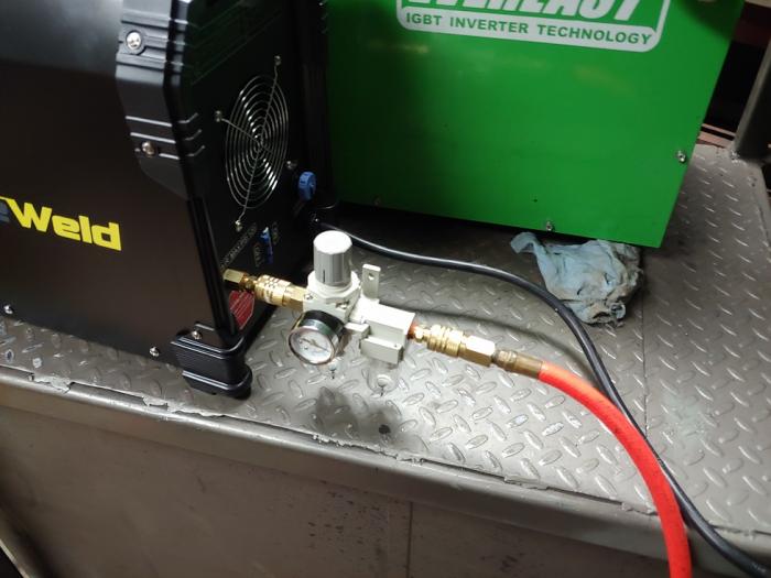

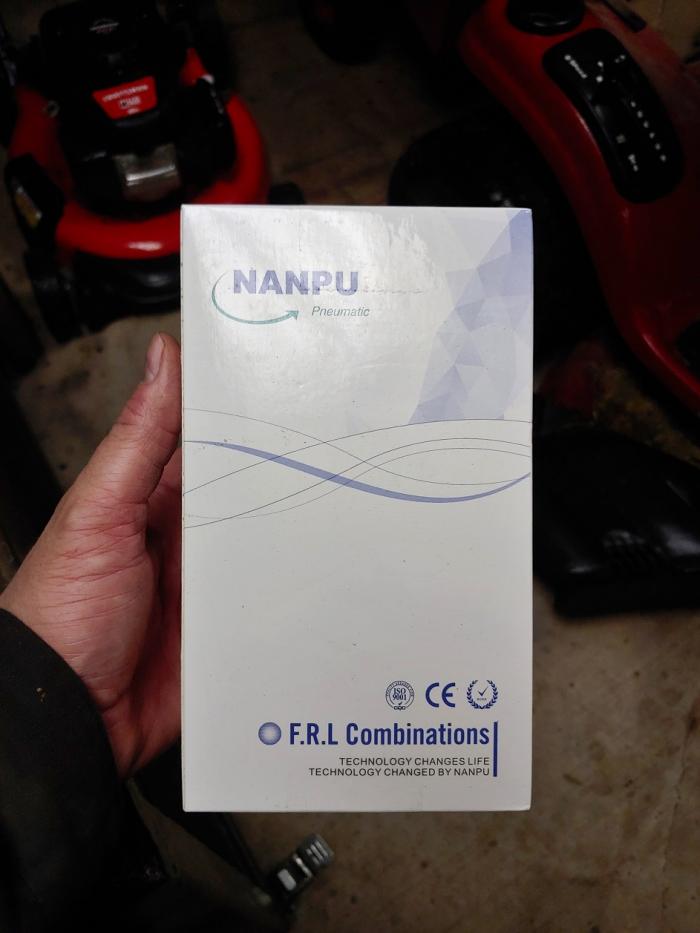

I then revisited the air dryer assembly and threaded-in the male and female fittings that came in the box. These were plastic and they felt a bit cheap. The problem with them however was that the female end would not hold the male fitting; I keep a few spares of 1/4" and 3/8" on hand. The fitting that arrived with the dryer were simply of a different shape:
plasma 14.jpg (60.83 KiB) Viewed 8985 times
And so I ripped that crap out and replaced it with the vanilla stuff that anyone can pick up at their local box store:
plasma 15.jpg (69.06 KiB) Viewed 8985 times
These of course were NOT plastic, and even though the dryer housing was plastic, I felt ok with threading these right in. I then connected the air hose to that:
plasma 16.jpg (44.88 KiB) Viewed 8985 times
Meh, kinda bleech. I don't really like this configuration, but seeing as how I wanted to continue making progress on the table, which meant cutting the diamond plate, I elected to go with it for tonight. It would work like this, of course, just isn't the best of configurations. So I need to come up with something else. TBD.
av8or1

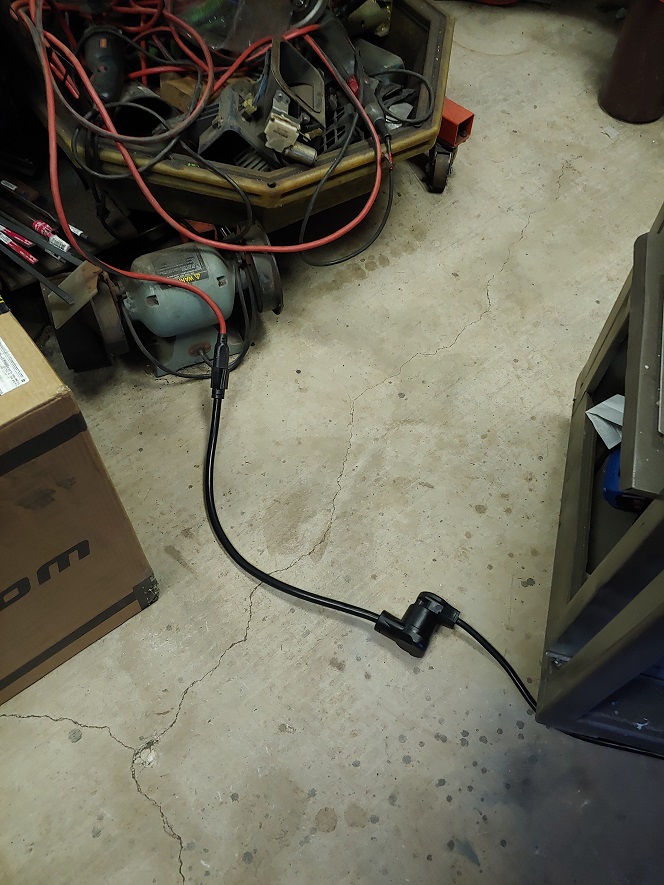

I decided that I wanted to try it on both 110V and 220V. So I connected the adapter and plugged it in:
plasma 17.jpg (211.76 KiB) Viewed 8985 times

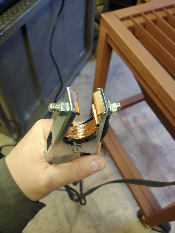

The workpiece clamp is of above-average quality too, what with the copper insert 'n all:
plasma 18.jpg (56.28 KiB) Viewed 8985 times
av8or1
I then aligned the first of what I hope will be many successful cuts:
plasma 19.jpg (196 KiB) Viewed 8984 times
My speed varied a bit and so the cut didn't come out perfectly straight. However it was close:
plasma 20.jpg (194.13 KiB) Viewed 8984 times
With a little more practice I'll get the hang of it.
What I discovered was that my instinct was correct. I didn't think that on 110V it would cut the 1/8" diamond plate cleanly. And it didn't. So I switched over to 220V and it made it through with ease. "Like budda". :D I liked that the 220V plug used on this box is the standard Nema 6-50 plug that is used in many welding applications. I already had that on-hand for the 275p and so it was just plug-n-play. Thumbs up for that PrimeWeld!

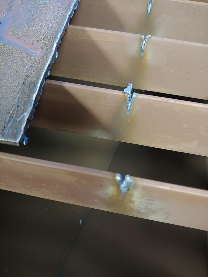

And this is why you need to make those slats removable Alan:
plasma 21.jpg (50.83 KiB) Viewed 8980 times

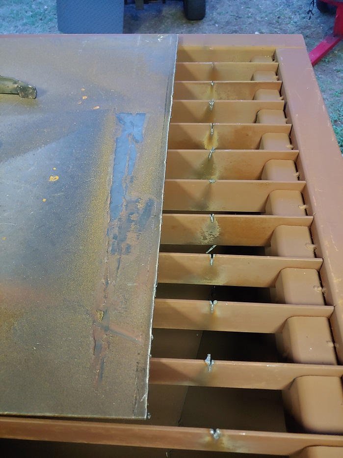

Even after only one usage they are chewed into. However that's their job, so it's normal. Seems to me that you kinda need to consider these slats as "consumables" as the phrase goes. :D
Anyway, I managed to cut the remaining panel and weld on another piece of diamond plate so that it was the full width of the longitudinal members. I applied rusty metal primer and plopped them into place:
plasma 22.jpg (54.15 KiB) Viewed 8980 times
I considered tacking them into place, but I dunno. I think I'll leave both panels as two separate, free floating panels. With that choice I can remove them as needed with relative ease.

Nice work. Consider putting a small desiccant dryer after the water-separator/before the plasma. Can't hurt, and they're only $8-10.
