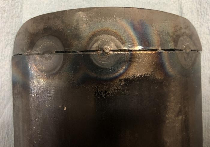

The first picture is the typical "okay" fit up that I get. I did not have to add a "plug" tonight. I think a plug is when you have to add material to close a gap in fit up.

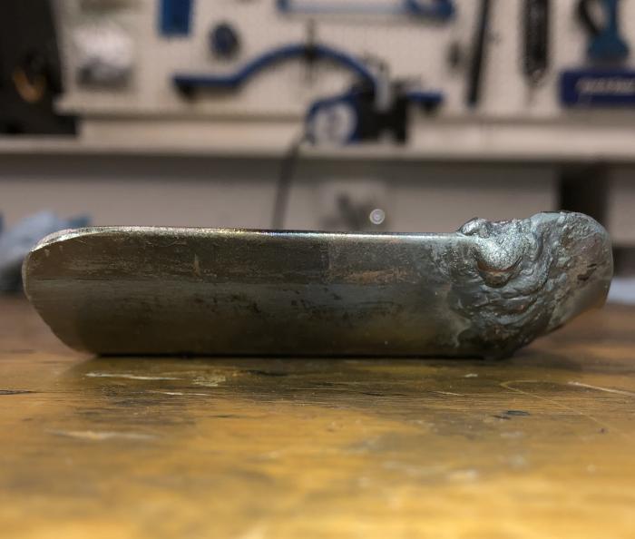

Like I said, it is imperative that I get an appreciable angle on the overhang. This is about what I am looking for.

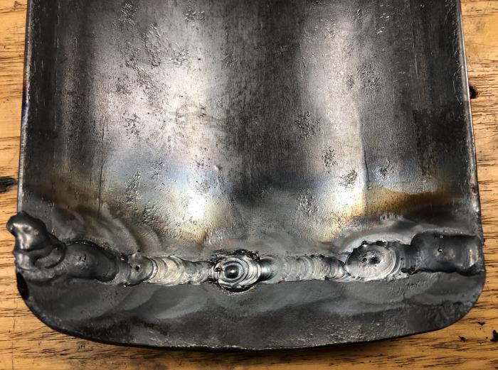

To start off with, I started to weld the center tack believing that the gas was on. The gas was not on. I don't have the best vision, and I misread the Open/Close markings on the cylinder. I turned on the gas. I used 13cfh.
The center of the bead needed to be washed once I was finished with the weld, probably due to this initial "lack of shielding gas" mayhem.
- IMG_4599.JPG (70.87 KiB) Viewed 3900 times

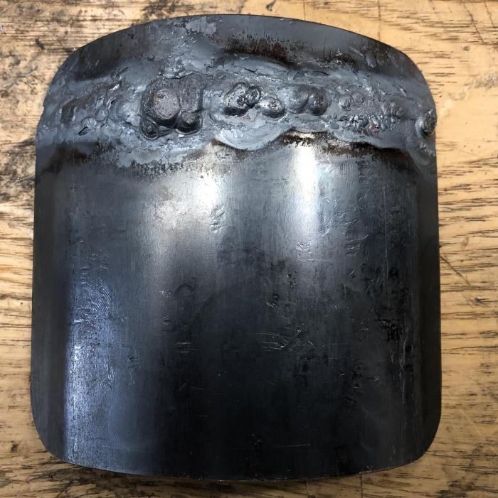

So here she is ready for grinding. Of the 16 plates that I have made so far, this is the best so far.
- IMG_4638.JPG (38.54 KiB) Viewed 3933 times

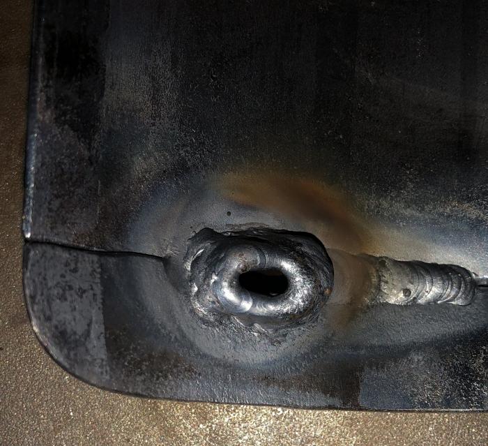

I had the max Amps set to 85. I thought I was doing fine, and then I burned a hole:
- IMG_4672.JPG (78.95 KiB) Viewed 3877 times

When I went to bicycle frame building school, they touched on how to fix a hole. I have not been officially trained on how to fix a hole, but here is my repair part way through.
- IMG_4681.JPG (82.69 KiB) Viewed 3876 times

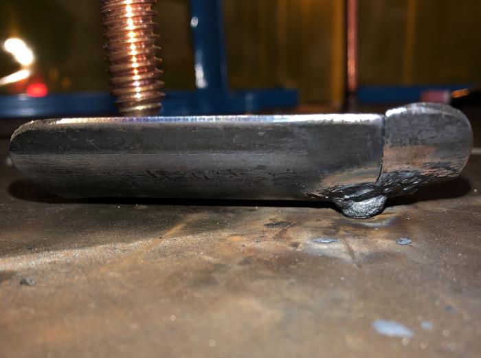

I took the part to the workbench and checked for warpage. It wasn't too bad, but I made some adjustments with the 4 1/2" pipe that I use to curve the plate, in a vise with a sledgehammer.
Here is the part after I was done welding it:
- IMG_4705.JPG (75.32 KiB) Viewed 3995 times

All your pictures show a lack of clean metal to start with. I can see where you did some grinding of the mill scale, but you want bright, shiny, metal to TIG. Also clean the edges after cutting them.
I’ll renew my statement earlier about penetration: I can not see the requirement for 100% penetration on these parts. You do want solid penetration, but clear through to the backside, I don’t see that needed. If you butt the pieces together with a square cut, the filler is not likely to fill all the way thru unless you really hammer it with the heat, and that requires more experience than you currently have.
You have 2 choices as I see it; 1. Bevel the edges of the part so there is a V groove that you fill on one side only. You shuold be able to do that with 1/16 filler if you add enough and gently work the torch left-to-right. Or, 2. Make sure there’s a small gap (larger than you currently have) at fit-up to create the needed space for filler to reach through as you weld one side. Both of these techniques create 100% solid metal between the two parts.
To prevent yourself from burning through, weld 1/2 of the length of the part. Stop, reverse the part and weld the remaining 1/2 from the end to the center. That will give you just enough time to let the metal cool down, since at this point your experience is not letting you see the puddle about to erupt. (This comes with time and experience under the hood).
Don’t be disillusioned, you’re making progress. This stuff is not easy to do self-taught, alone in the shop. Until you can do it with someone experienced, looking over their shoulder and yours, bending this curve will take some time. Just don’t lose heart, you’ll continue to make progress.
