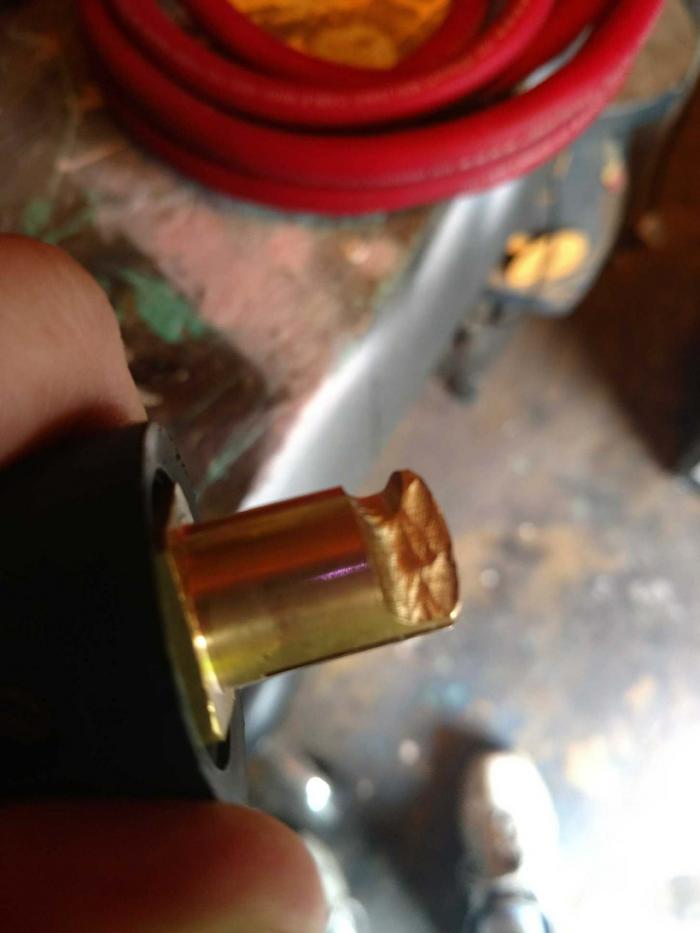

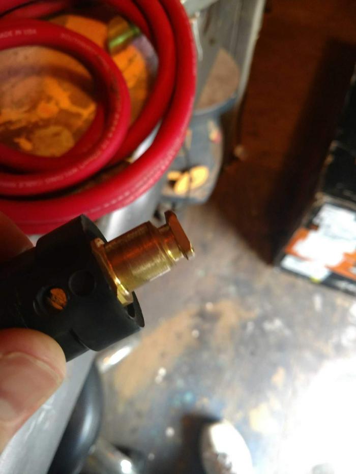

Well powder my ass and call me Judy. The lady from Cyberweld sent a picture of another cable. It looks the same. LOL. I mean, it looks chipped off to me. Oh well, they say it’s supposed to be that way. So be it.
There's no way that's how that connector should be. Only way that is from Miller is if they completely skipped their QC and allowed a batch of CNC mess-ups out the door.

That is what I was saying. NOW, the ones I have on my Bobcat cables, DO look kind of like that. BUT, they had clean edges. Like they were made that way. The Suitcase one though, looks like it was broken off.
Miller said it should look that way. I mean, I don't know what to do. haha
The one I got, the Tweco one, the other side, with the part off, still has the same curves and lip that it does on the other side.
The only thing I can think to do, is ask Miller to give me a place that they have that fixes their machines. I can bring it there and have them look at it.

Uh, they're right on the connector end. It's not a dinse type with a tang,it's tweco/lenco type. It is grooved at the end, with a flat cut out to key into the female socket, with a twist when it sockets in. Yea, the cut off looks a bit (a little bit) rough, but it should work fine if you have the same on your other stuff.
I think thats the bigger #4, like what comes on the 12vs suitcases, my aead welder had the smaller #2 size, and since I already had made up cables for that connector, I just changed the connector on my 8vs to match everything else, I dont use nor need 4/0 cables like the #4 size you have is made for.
The gun handle on the other hand, aint right, but if it was a good price, I would just put it back together right, and use it.

Here are new picture I took, to send to Miller and Cyberweld. Now, look at these and tell me the thing isn't broken. There is no way this will work.

Yea, from that view...looks pretty bad. My connectors look like pic 4. Wonder how they let them out like that.
Is the suitcase itself in good order?

haha, well, inside, the gun was broken. The thing did hold tight inside of another piece. So, I will just keep it.
It does not look right to me. But, if it fits, it fits.
