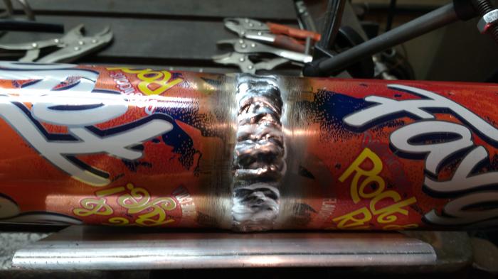

So I had a little blow through and thought, maybe I can fill it.
It got a little out of hand. over 12 feet of 3/32 4043 filler.

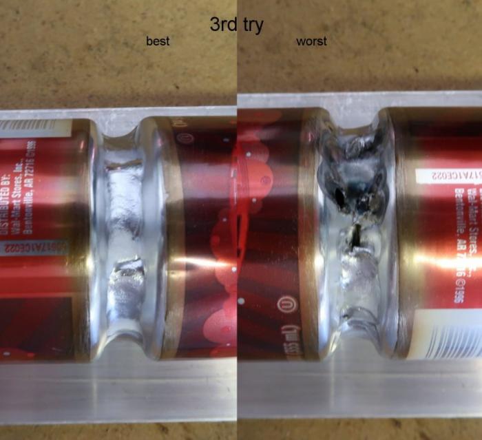

Hey Richard your best attempt #3 is awesome. It's not as easy as one would think. I thought after Steve posted his weld porn pic the other day he was going to come along and make us all look like monkeys
Maker putting a cap on his welds was pretty awesome.

That cap was taking EX's advice to the extreme. I established an arc on the filler then moved the filler and torch in unison back and forth across the cans. I had the machine set at 40 amps 1/16 2% lanth and 15 cfh with 3/32 4043 filler. Once the puddle was established I ran the peddle about half throttle. Around most of the can there is actually an air gap between the original weld and the cap. Just kind of demonstrating the unconventional method that works on the cans. Could probably 3d print with those settings.

Hey maker...did you try thinner filler wire or did you use 3/32" from the get-go? I used 1/16" on my first try but I had tomaker of things wrote:That cap was taking EX's advice to the extreme. I established an arc on the filler then moved the filler and torch in unison back and forth across the cans. I had the machine set at 40 amps 1/16 2% lanth and 15 cfh with 3/32 4043 filler. Once the puddle was established I ran the peddle about half throttle. Around most of the can there is actually an air gap between the original weld and the cap. Just kind of demonstrating the unconventional method that works on the cans. Could probably 3d print with those settings.
jam filler in the puddle to keep up. I switched to thicker filler and it seemed easier. I just got some new coupons to play with so I am going to try it again....when my hangover goes away
- maker of things
exnailpounder wrote: I just got some new coupons to play with so I am going to try it again....when my hangover goes away
Mt very first attempt was with .040 2% lanth and 1/16 4043 filler at 15-20 amps. Friggin arc would go anywhere but the joint, I even turned the freq up to 450hz with no improvement. I didn't really give it another shot till you posted up here. I think I did one try with 1/16 but as you noted hard to keep up with pushing the filler in (another person who does not have the skill to feed filler, just hold it) was thinking about giving 1/8 a go. It's a heck of a thing when the filler sticks to the cans and I end up picking up the cans when I try to reposition the filler. Guessing I'm not alone with that.
I have been using painter's tape to hold the cans on a piece of 3x3x1/4 aluminum angle then making a tack on the near side and starting the weld opposite. That first tack really draws that other side apart still. Have been contemplating punching holes in the bottom of the cans and putting some threaded rod through with washers and nuts on both sides to hold the cans together.

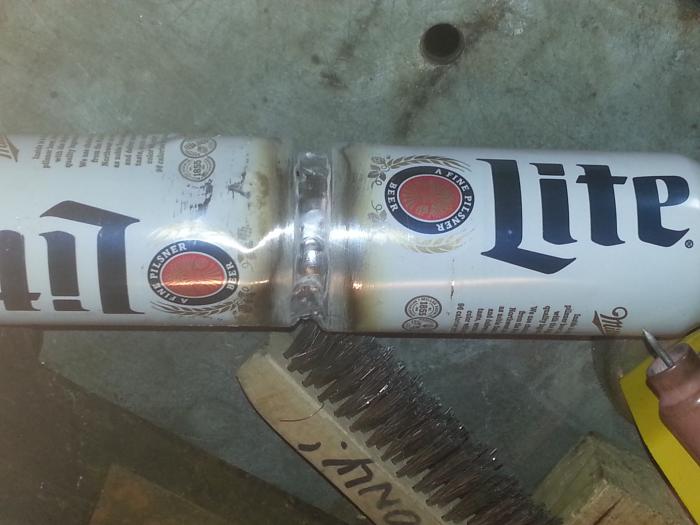

My second attempt. 3/32" 2% lanthanated, 3/32" 4043, 50 amps, 18cfh. I am going to try for the stack o dimes next.
- maker of things
Are you going to do a "root pass" then dime it, or try to dime the cans from the start?
BTW I have been using green scotch brite to sand the anodizing off the cans prior to acetone wipe and weld. haven't had any bad fumes so it must have gotten to bare aluminum.

I tried to move/pause to get the dimes and it doesn't work too well. You need to keep shoving rod in or the cans overheat and blow out. I tried pulsing but you have to crank up the amps so high to melt the rod it blows out the edge of the cans. Diming them after wards is cheatingmaker of things wrote:Are you going to do a "root pass" then dime it, or try to dime the cans from the start?
