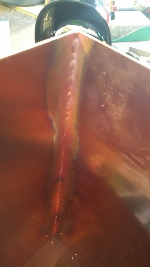

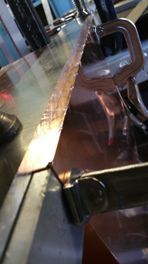

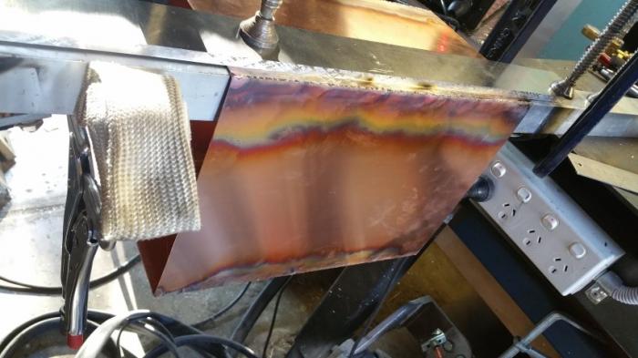

Tig'd up some 20 gauge copper sheet to form a tank for a home made tig cooler. Don't have a folder or guillotine so couldn't do it with laps and solder. Silver brazing and lead solder didn't work so well with butt joints, copper just warped and moved everywhere.
Anyway I welded it up and it doesn't leak which is the main thing. Some of the welds are pretty ugly, actually most of them. Its a mix of fusion welding and some bits where I used filler. After today, were I to do it again would have just used filler on the lot but its good to know its fine without. Fairly ductile so it doesn't crack if you don't use the filler.
Brazed in some nipples. One for the pump supply, one for the bypass return line, one for the return from the radiator and a big one on top that will be plugged once tank is filled.
Its rather ironic that the one thing that would have made this easier is a smaller water cooled torch like the CK 250A I have sitting in a box rather than the giant air cooled Binzel one I had to use. Not so good on delicate work, and it along with everything else like the clamps and aluminium etc got smoking hot. Not the tig finger clamped on where I was propping my elbow. Hopefully have this project done soon so I can start using the new torch.
Made a suggestion in the Wish List for a video on some light copper tig welding. Not much of it on the Tube at all and what's there isn't that great. Which is a shame. Copper is very versatile especially with respect to brazing, bending, shaping etc. Can see myself using it for a lot of little projects.

Nicely done, Rupes.
I hear you on the pain of the big torch. All my work is smallish stuff ( usually motorcycle related) but the torch that came standard with my machine is a size 26 as big as a claw hammer.

Rupes....welcome to the forum. I have done a little copper welding on some fittings, you had your hands full on that box! Copper in and of itself is no harder to weld than anything else, its the heat conduction that makes it so tricky. I don't do enough to warrant buying deoxegenated copper rods so I just strip wire and use that for filler. Fill us in on the particulars. I am always interested when someone welds something other than steel, SS or aluminum. Hope to see your finished product. Nice work!
