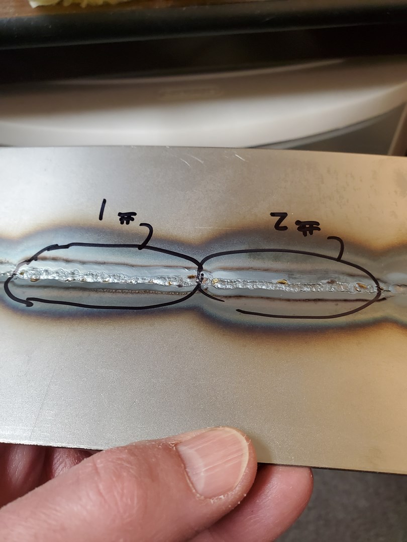

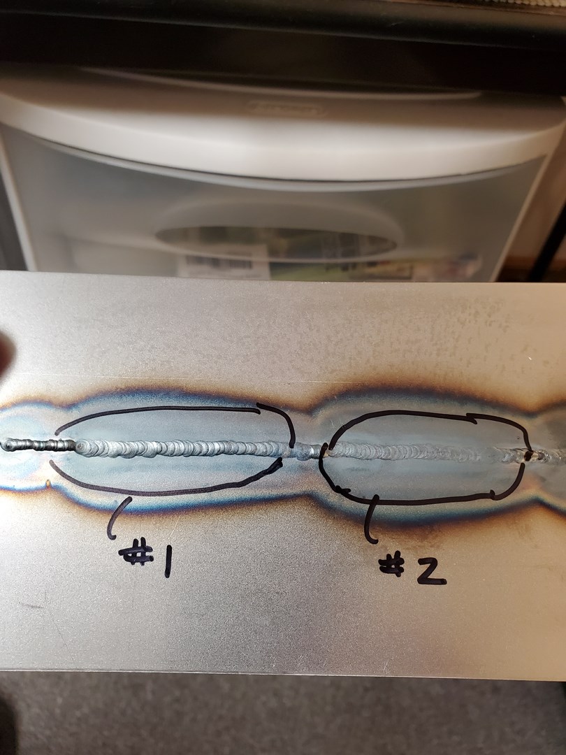

Hi Guys,
I'm still working to be consistent with a bead on 16 Ga.
Two pictures are attached.
The first is a front pic of a two 16 Ga 8" long coupons joined with a butt weld. The #1 circle shows one example. The #2 circle shows a second pass.
The second pic shows the backside of the same two welds.
(The #2 circle, front view, looks a lot hotter in the pic than when I look at the actual coupon. Not that the weld is anywhere close to perfect... just not as hot looking in person.)
From what the backside shows is the weld getting closer to correct?

cj737
    Thu Sep 29, 2016 8:59 am
The backside shows plenty of penetration, which is not always required just because it’s a butt weld (this is more common on thin material). But they’re fine.
The #2 circle, did you weld over the first pass with more filler, or simply walk the arc (“wash the weld”)? I can’t think of a situation where a second pass on 16ga would be expected or called for…?

cj737 wrote: ↑Mon Jan 17, 2022 10:24 am The backside shows plenty of penetration, which is not always required just because it’s a butt weld (this is more common on thin material). But they’re fine.
Thanks for your input.
With #2, it was a virgin weld. I was working with shorter bead runs and alternating ends of the joint, so that I didn't heat the metal up too much. I actually started #2 out too hot and was able to bring it back a little...

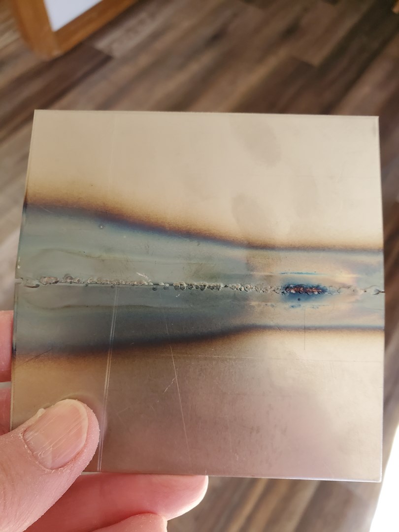

Hey Guys,
Jeff2016 wrote: ↑Tue Jan 11, 2022 3:05 pm Hi Guys,
Can someone tell me what is causing the defect shown on the attached picture? Is it only because of the high heat (yes, I know it is much too hot), or could this also be due to the tungsten being too close to the puddle? (The line in the center of the of the weld is what I am interested in.)
Thanks,
Jeff
This pic is from a previous post. I'm not creating this same defect as often; but, it still happens. I under thanks to GDarc and CJ that it's mainly because of too much heat. I'm not sure if I am falling asleep with the filler rod... but, it's something I'm still trying to correct.
A question... Once that happens the puddle definition disappears and there's a lot more red that I'm seeing through the helmet optics in and to the side of the weld. I get that it's too hot. What is the best way to recover from this during the weld. I've been trying to add filler more quickly, and also back off the pedal a little and pick up my torch speed. Is one of these more helpful, or is better just to terminate that weld and start a new one?
Thanks,
Jeff

cj737
Once the base metal gets too hot, really only dropping the arc will cure it. Stuffing filler helps cool the puddle, but the base material has saturated beyond the puddle.
So to answer you question: chicken or egg? Both. Stuff filler and taper off the pedal. I don’t like to snap off the heat because it can create other problems in the puddle that surface later, or require NDT to identify.
