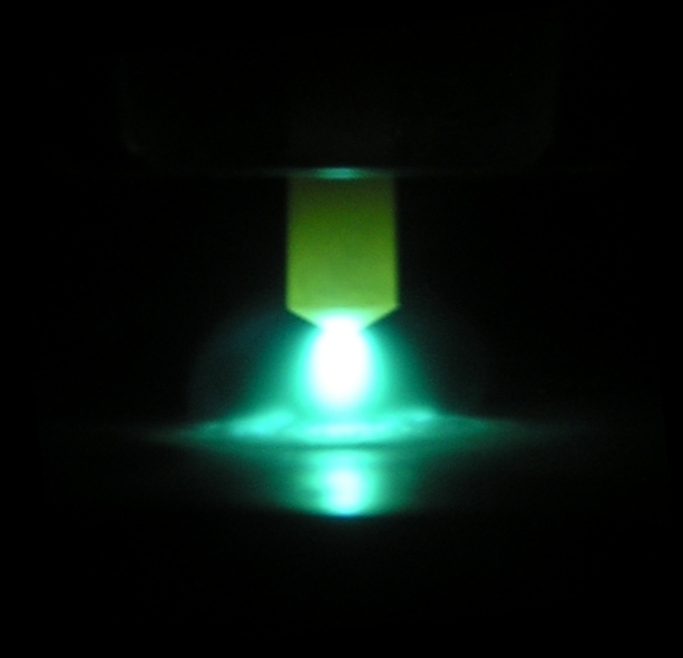

I have made a bit of a breakthrough with my aluminium tig welding, which I thought I’d offer up for your comment and thoughts, and also because possibly it might help others, or at least give suggestions on things to think about. My problem was with the electrode parameters; I hadn’t realised just how important they are.
My aluminium welding has been a bit hit and miss, and the one joint that’s far more miss than hit is the one-inch diameter tube-to-plate. I’m a keen fan of Jody’s aluminium drill but I hit a point where further progress was minimal. So I got some tube and plate and tried to see where I was going wrong. I used 2% lanthanated electrodes and soon realised that arc instability was my problem; I was nearly always fighting to control the arc, especially at lower current settings. Getting a focussed arc was also problematic; increasing the AC frequency helped, but it didn’t solve the problem. So I’d burn through the tube in places, get undercut, and get an inconsistent weld bead.
As arc instability was most evident at low currents, I set current to 25 Amps. My settings were 65% EN, 200 Hz, 25 Amps. I started with a 2.4mm 2% lanthanated electrode. (AC frequency seems to help focus the arc a little, but it’s not like night and day, as Jody would say, so I left it at 200Hz.) I found that:
a. The arc was unstable, and changing the tip angle didn’t help.
b. A 1.6mm electrode was, if anything, worse, and again tip angle made no appreciable difference.
c. A 3.2mm electrode was also unstable until I ground a tip of about 100 degrees - the apex was 2mm from the start of the shoulder of the tip. With this angle I had a rock solid arc at 25 Amps (at 50Hz, too)
lanth 25 amps.JPG (276.42 KiB) Viewed 11204 times

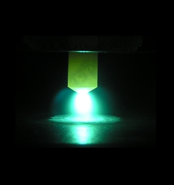

d. Having read that ceriated tungsten is "best at low amperage range", excellent for arc stability and is recommended for aluminium with inverters or transformers, I tried a 3.2 mm ceriated electrode at 25 Amps, but found the arc unstable. It was unstable at 100 degrees tip angle and even more unstable at a sharper angle. (All electrodes were ground longitudinally with diamond wheels.)
ceriated 25 Amps.JPG (249.23 KiB) Viewed 11204 times
Having now got control of the arc, my next tube-to-plate weld was easy and professional looking - no undercut, no burn-through, and no battling with the arc. (1.5mm tube to 3mm plate - 3.2mm lanthanated tungsten, 100 degree tip angle.) The results of my aluminium drill are now looking a lot more like the results Jody gets.

Arc photos slightly enlarged
lanth 25 amps large.JPG (57.95 KiB) Viewed 11204 times
ceriated 25 Amps large.JPG (81.22 KiB) Viewed 11204 times

martinr wrote: ↑Thu Sep 02, 2021 10:03 am Image
nice pic, it really shows that the arc comes off the side of the point. a fine taper makes a wider arc, while a steep taper makes a smaller arc.

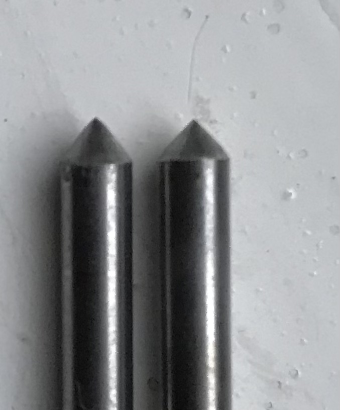

Here’s the 2 electrodes just before yesterday’s tests:
(Lanthanated on the left)

I wish I hadn’t thrown in the observation of the apparent advantage of lanthanated over ceriated at the test parameters: it’s become a distraction from the main observation i.e. the effect of electrode diameter and tip angle.

is it just me or is the ceriated one ground off centre ??
martinr
    Thu Dec 23, 2010 3:45 pm
    Manchester, UK
tweake wrote: ↑Sun Sep 05, 2021 3:54 am is it just me or is the ceriated one ground off centre ??
Done by hand on a “medium” diamond disc and then finished off on a very fine diamond wheel, so it could be, I suppose. How do you grind yours?

Confirms my suspicions. Both are acute, and not identical. One has a smaller included angle. That throws off the data.
