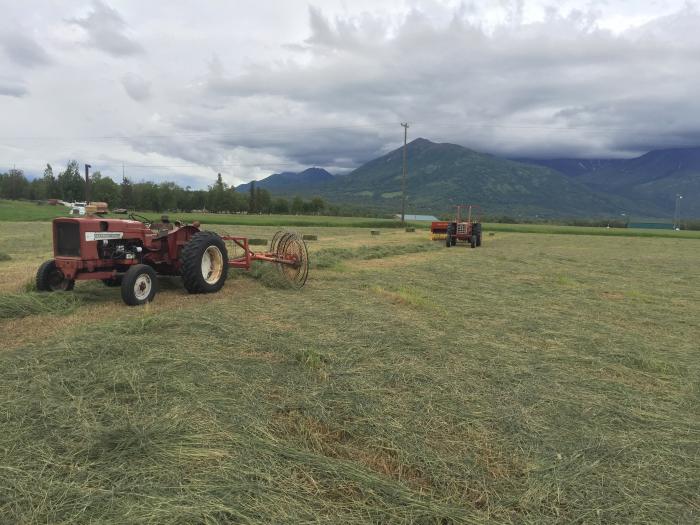

Trying to guess what the little tractor is on the trailer - can't decide - maybe IH 574 ? with nothing to give scale it looks small & the bonnet shape I recall being shared on quite a few models in the 70's - could even be as small as the 354 / 454 though back tyres look too big - & I think the swept back front axle would be just visible - put us sad tractor spotters out of our misery John please ! my memory is getting bad - I should know this era of tractor even allowing for differences in model across the pond.
    Wed Oct 23, 2013 3:30 pm
    Palmer AK
noddybrian wrote:Agree ! Great pics & job as always - though I don't like how low the original hitch is - I might have been tempted to remove it to improve departure angle.
IH 674. 8 speed manual. 4 speed reverse.
Just bought that tractor 2 months ago.
483 original hours.
Love that little tractor.
The low one with the rake is our 544 hydro.

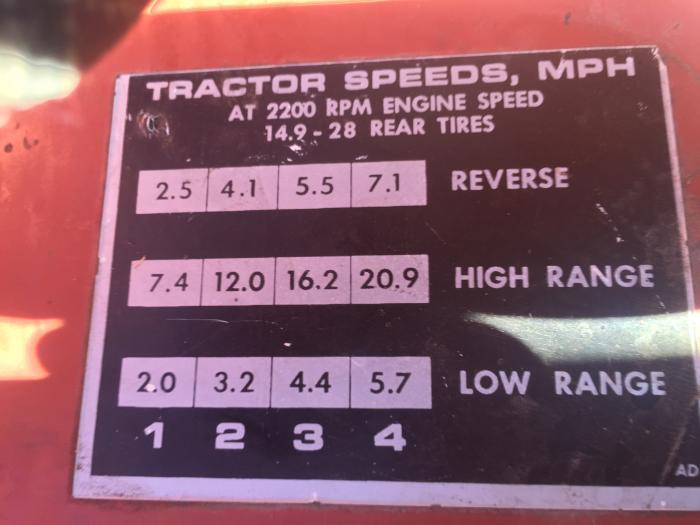

Thanks for the info & more great pictures John - so I was close with my guess - the 574 / 674 are visually identical just 10hp difference in motors (68 / 78 from memory in UK market ) & yes they were great little tractors in their day - actually quite advanced compared with others of the same year - gearbox took some getting used to - yours having such low hours won't but high mileage models suffer from linkage wear & can jam between gears or even select 2 at the same time - then you get to lay under them with a prybar & jump them back into correct place ! never seen the 544 hydro - think it maybe a US market specific model - we had a 354 hydro but they are very rare - idea had it's merit for certain jobs but they never caught on here - to find one now would be make it a valuable collectors model - they had one at the college I went to bought just really to show us about hydrostatic drive as almost nothing used them back then - even combines were still mostly belt drive on variable speed pulleys - I only drove it one time & after demonstrating a near perfect " J " turn was banned !
Slight query - you say 8speed manual box - yes thats my memory but all the UK 674's I've seen have the clutchless 2speed splitter .( like dual power on Fords )
plantwelder
    Tue Jul 16, 2013 5:15 pm
Noddybrian, my Dad drove one of those 544 hydro on a baler. He said it was the best baler tractor that he'd had in 50 years. There wasn't much that it did well apart from that, but that one job it excelled, especially on some of our fen crops where the combines spat the straw out of the back in lumps. You're right on the uk 674's, they all had that splitter. Can't remember what IH called it, but the Ford system on the 7000's was called Dual Power. Masseys had something similar as well on the 165/185/188 tractors.
