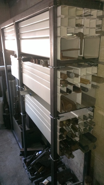

You could also anchor it to the wall depending on what the garage is made out of... If you can keep it off the floor it is easier to clean around and under.
Here is a rack I built for my garage that would fit between the wall and the garage door track. It is only 14" deep 60" wide and 60" high
I made it so I could adjust the shelves up or down if I needed to add more space, I used pvc fence rails for separation of stock not the most cost effective but did maximize material storage separation space. The area under the shelves allows me to store large stock vertically and I am adding drawers under the smaller shelf (where you see the trays now) for small stock storage. I'm currently working on a rack that will sit on top for longer stock storage based on conventional front loading stock racks.
In the plans now is a small sheet stock rolling rack that will sit on the near end of this rack that will hold a limited amount of flat material that I have on hand.

Very nice!brucepts wrote:Here is a rack I built for my garage that would fit between the wall and the garage door track. It is only 14" deep 60" wide and 60" high
Hey brucepts, I really like your rack idea to help keep small quantities of varied material. Don't know why I didn't think of this before, very practical and perfect for the garage. Consider the idea stolen, mua-ha-ha!!
Mine is just rectangle tubing with angle welded to it.
Think of a ladder - mine sits on the floor, leans against the wall. Bolted to floor and wall.
