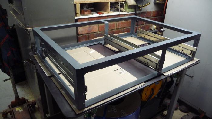

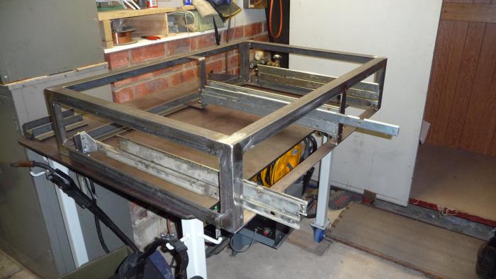

Customer required a custom design rear drawer system for a 4WD, had specific size needs.
I preferred to make it from aluminium, but customer wanted steel, so that they can add brackets to it later, if required

I've built a few. This guy saw one I made for myself and wanted one custom made for his truck. I'd reckon he'll be pretty happy with it.

Hi Craigmotox wrote:Trev
are those draw sides and partitions solid?
nice draw faces does your company make them?
The drawer sides are folded from 0.062" aluminum sheet in a 'U' form, with a 1/2" return at the top for rigidity
I cut and folded everything. There's front and back 'ends' that are folded at the edges and attached to each end of the main drawer body of the drawer by pop rivets (did I just hear everyone scream = "Pop Rivets - Oh No!" ?)
Then there's a larger (overlapped) drawer face plate (also cut from 0.062" sheet) which is riveted to the front face with dress rivets. It has the trim around the edges, and the latch mechanism installed.
There are outside panels that have a diagonal 'X' fold for rigidity. These are screwed to the sides and rear of the angle iron frame.
To hold the partitions, I cut and folded two aluminum 'L' brackets of unequal sizes (a small 'L' and a big 'L'), and overlapped them and riveted them to the sides. This way, the edges of the inside and outside 'L' brackets are all flush but the appropriate gap sits between them for the partitions to slide vertically in between them.

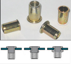

My Uncle worked for United Shoe Machine in Connecticut when they introduced the Pop Rivet. I'm well familiar. What are rivnuts?motox wrote:trev

- TRACKRANGER
Location:Melbourne, Australia
Re: Rivnuts
I'm pretty sure they are the same as what we call Nutserts
