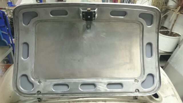

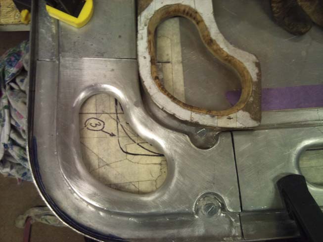

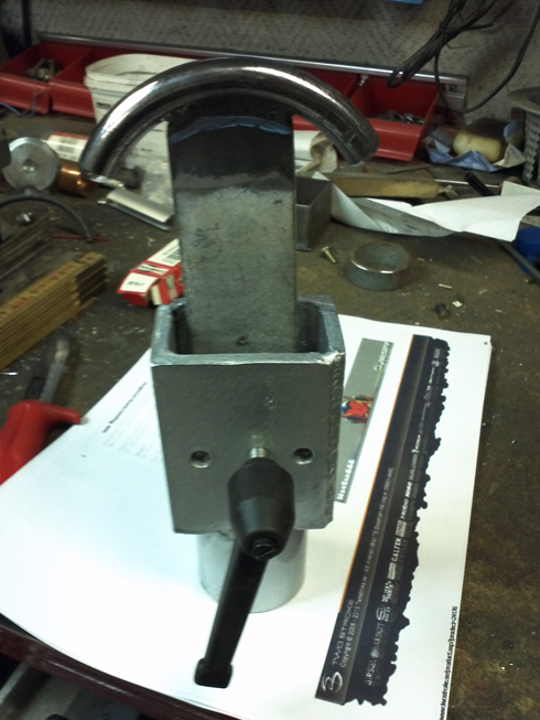

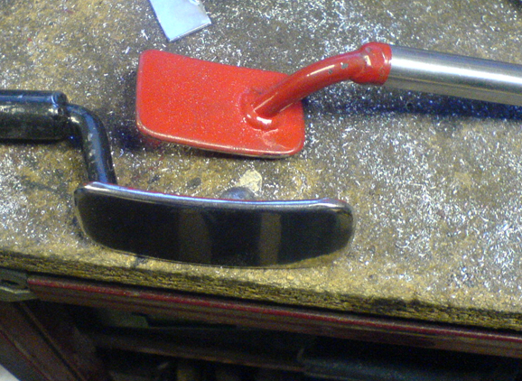

I dug up some pictures of some simple tools I've made

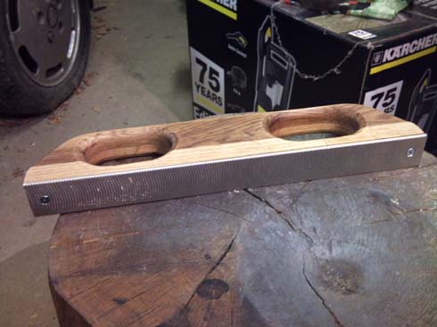

Body file holder, the file lies on a "stump" used to shrink metal on
Some various templates for recesses or dimples.
Some oak, jigsaw, holesaws and a wood router is everything needed
They were used to make this
Wood mallet I made from legs of the kitchen table :mrgreen:
Tool for tipping edges (can be shimmed to take different sheet thickness)
Tipping dies for the bead roller
Some slappers, made of leaf springs

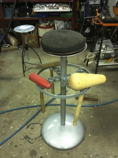

Beater bag stand, made from an old water tank

Continued, 10 attachments maximum...
Holder for stakes, fits the beater bag stand
Some stakes, the smaller curved ones are coils from car springs
Some tools, self made and modified

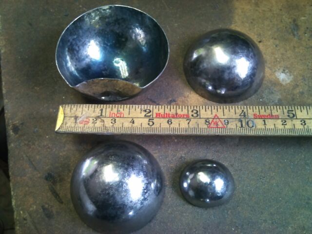

pretty much everything used to make this

That's cool! You doing hot work with them, or is it all done cold?

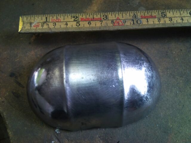

Posted: Thu Apr 30, 2015 5:08 am
by AndersK
Thanks gor the kind comments.
I mainly work cold but sometimes, like with the parts for the dragonfly, I need to anneal when it work hardens.
The size and degree of shaping would make them crack otherwise
