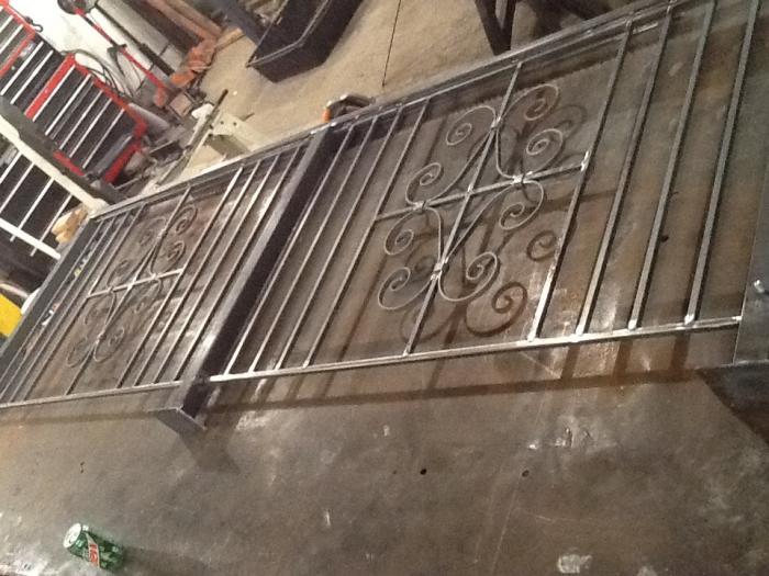

Scrolls were bent in the shop, all cuts with a bandsaw, 1963 Airco did the tig welding, I just watched

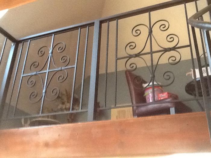

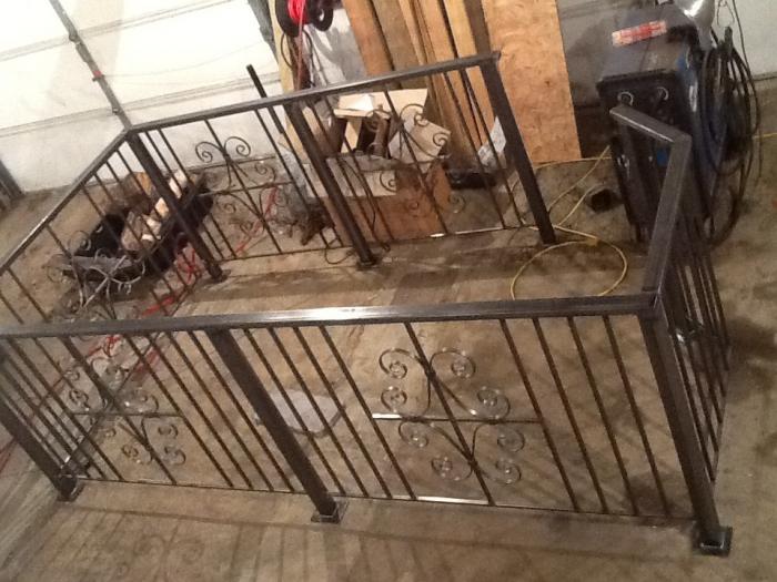

Here is a railing I just finished and installed on Sunday

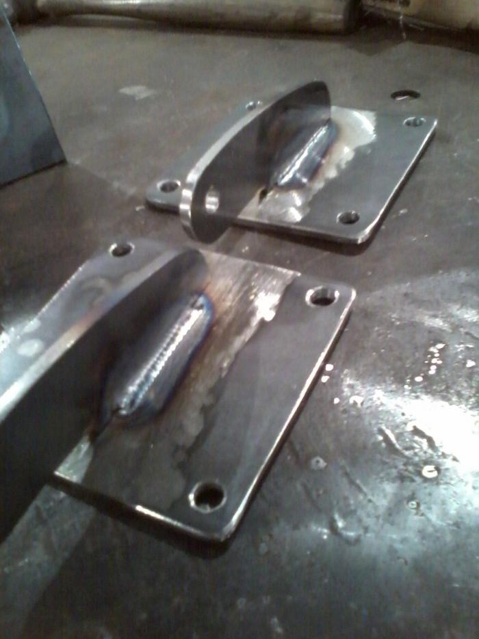

To weld on bolting tabs, and locate the holes in the posts to weld, I use one flat piece of metal to bolt the tabs to for welding, and to lay on the posts to transfer punch.
This way I only have to measure once and they fit perfect

Decent tig weld - not perfect, yet

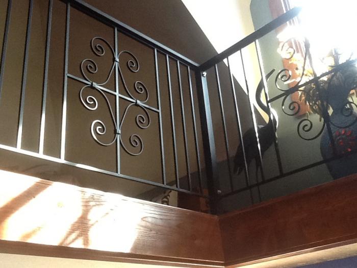

That's fine work!
It's been years since I did any decorative balustrades and banistrades, and mine were rarely so decorative. Maybe a custom gate or two.
It kind-of makes me miss the work; To have the outcome be artistic, rather than merely functional.

Not my usual sort of job, but I like how it all worked out - a little creative "artsy" work is kind of nice
....wait, is there such a thing as a "usual" anything?
Having to make it fit within about 1/8" all around was a little stressful though I have to admit.

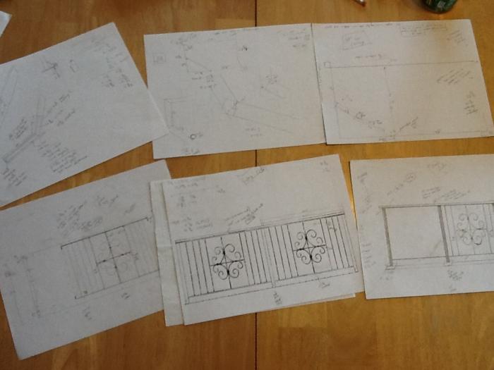

Check out my sweet "CAD" drawings...
And my carbon neutral "CAD" program - it runs on Mt.Dew and coffee.
- image.jpg (34.99 KiB) Viewed 2893 times
- image.jpg (37.38 KiB) Viewed 2893 times
I thought CAD stood for "crayons and desks", and I have a light-powered calculator like you show in the last image.

Yes, the top is rectangle tubing, square tubing for the posts, 1/2" solid square for pickets and such, 3/16" x 1/2" flat stock scrolls.
