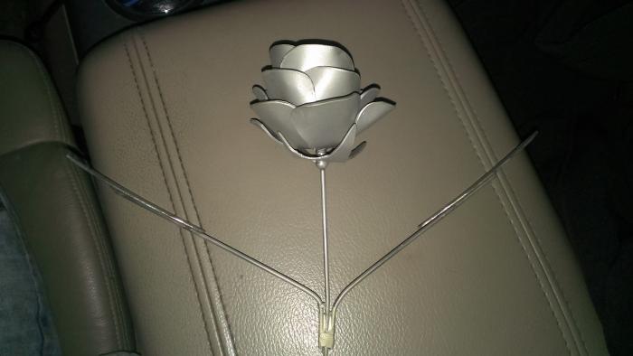

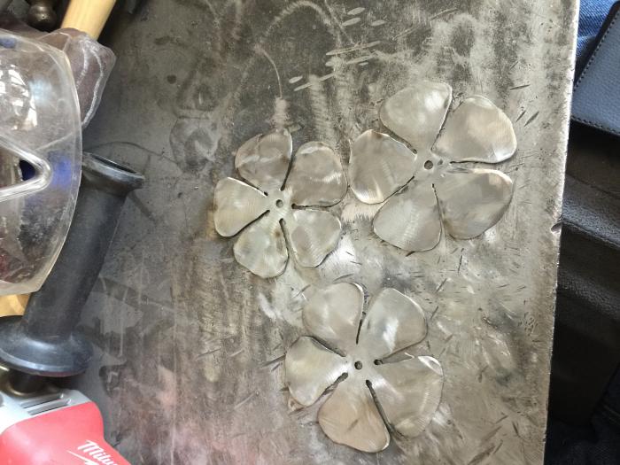

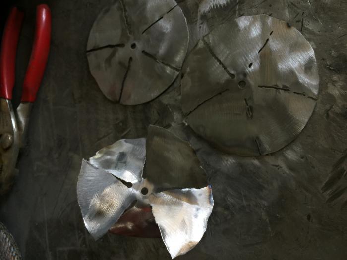

To make roses, I first cut three circles about 3.25" from thin sheet metal. I'm using an old fender. I clean up the circles with a flap disk. They don't need to be perfect. Then I mark an approx 3/4" circle in the center of each and five equally spaced lines around the outer edge. I find just eyeballing these is close enough. Center punch and drill a hole in the center of each circle for the stem. I use defluxed and polished 1/8" rod for the stem.

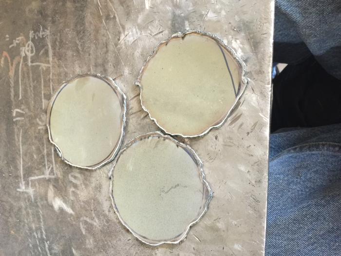

Cut from the five marks on the circumference to the edge of the 3/4" circle in the center. Then fold the petals so that you can round the edges on a flap disk.

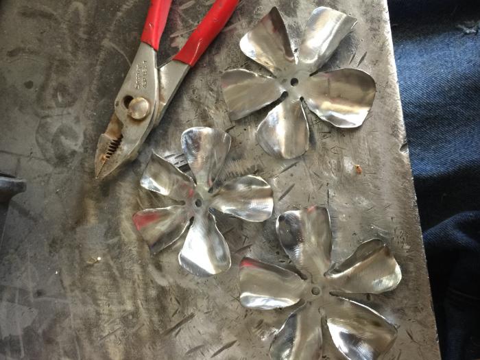

Using pliers, carefully bend the petals into a sort of U shape. For the innermost row of petals, bend the U a little tighter and for the outer, a bit less.
Fold the petals in with one edge overlapping the petal next to it. The center row will, of course, need to be folded the tightest and the outer, the least. I then weld each ring of petals to the stem starting with the center ring. I twist each ring around and experiment with the position until I like how it looks.

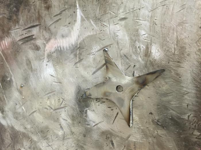

I don't know what to call the piece that goes just below the flower but I make it from a four pointed star with a hole in the center. weld it to the stem then bend the arms down and curl the tips up.

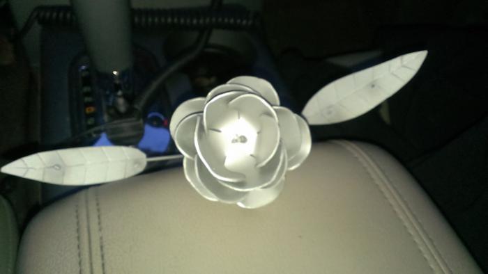

The leaves are cut from the same thickness as the flower but I use 3/32 rod for their stems. The pattern on the leaves is simply stamped with a chisel. Once it is all welded together, I look it over and give it little tweaks here and there, bending the petals out a little on the edges. Don't worry about being symmetrical, it's the little imperfections that give it character :lol:
I usually heat-blue and clear coat mine but I'm sure any finish could be used.

Also I usually tig these together but my argon is empty so I used mig. Sort of burned thru the leaves but I don't recommend that step. :lol:

I couldn't understand after picture number 4 how did you cut the steel in the shape of petals?

AlexG wrote:I couldn't understand after picture number 4 how did you cut the steel in the shape of petals?
It looks like he plasma cuts them and them slips a cutoff wheel in the slot to clean them up.
In pic 4 one of the circles I cut out is shown bent so that the corners can be rounded on a flap disk. Then I flatten it back out. I should have made that clearer. Hope this helps.
Eldon
Now i got it thumbs up.
