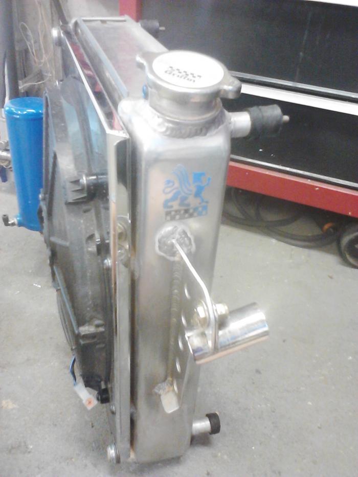

Dragster Guy
- Dragster Guy
Joined:Wed Jun 11, 2014 7:19 am
Location:Pasadena MD
A little Rad repair. Had a crack in the tank at this mount.
- IMG_20140623_165813.jpg (62.09 KiB) Viewed 1358 times
- IMG_20140623_165742.jpg (42.89 KiB) Viewed 1358 times
