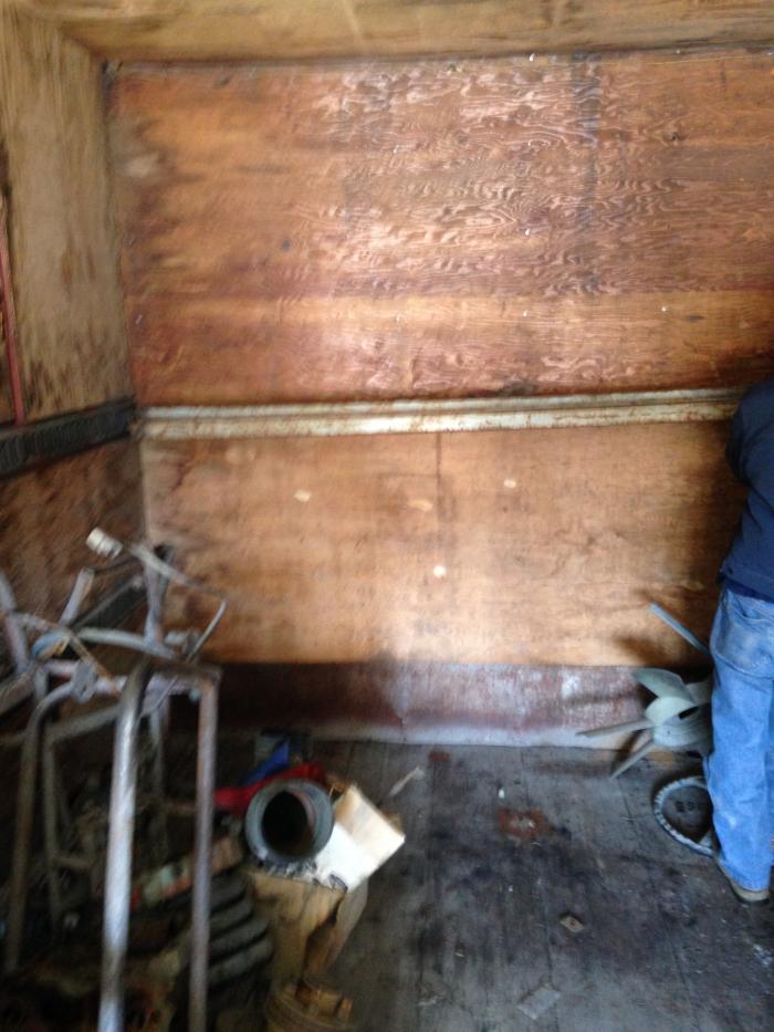

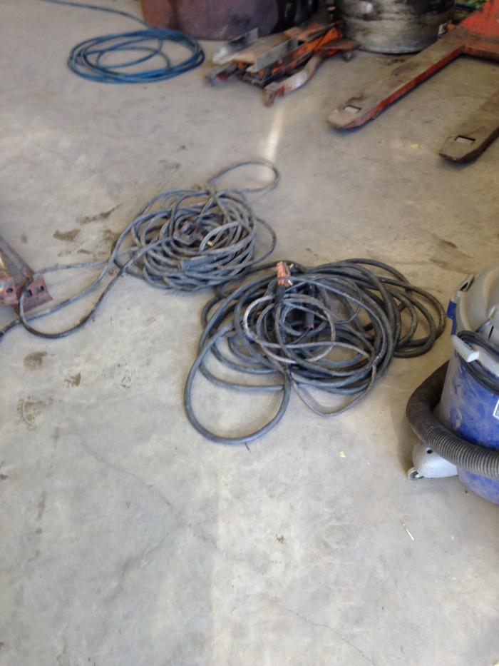

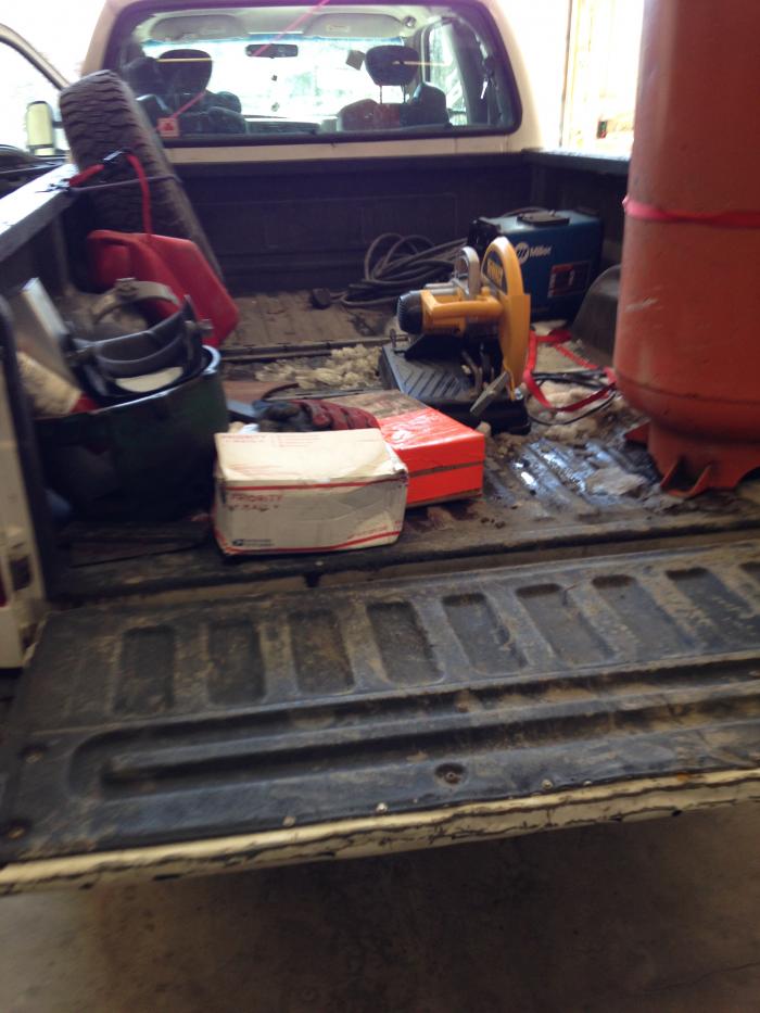

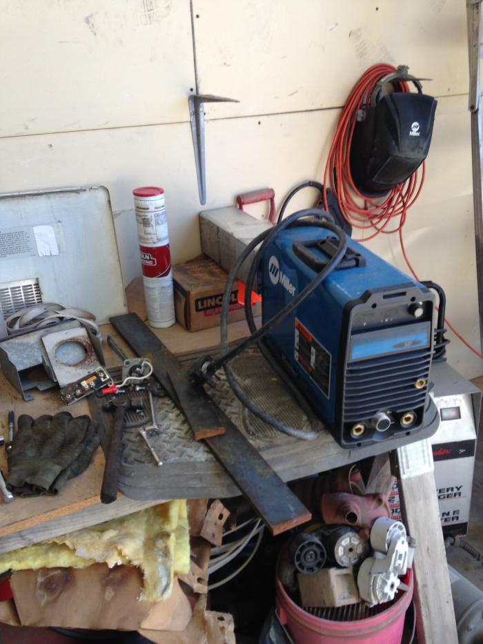

Loaded up the welder, leads, extension cord, helmet, rods, and chopsaw....
Going to be putting shelves and racks in truck boxes....
Gonna be a little while, lots of fabbin and fittin.
Enjoy,
~John

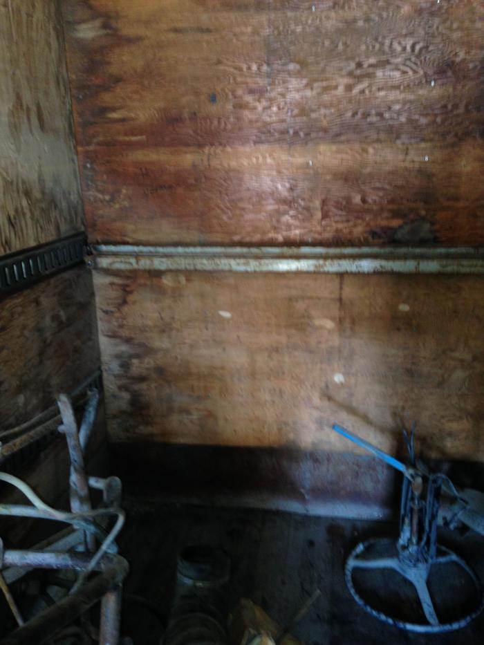

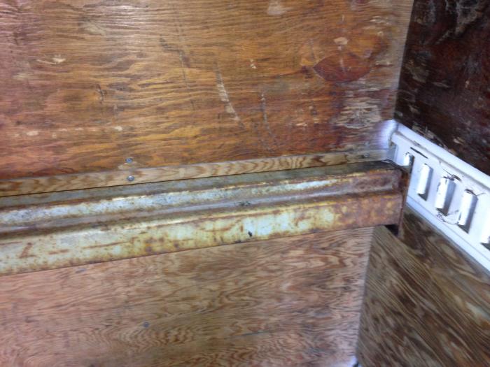

I work on most anything....
But the shop I went to, used to be a heavy equipment shop, and there's lots of parts around.
That's why I was hired to put shelves in these connexs....
More pics tonight.

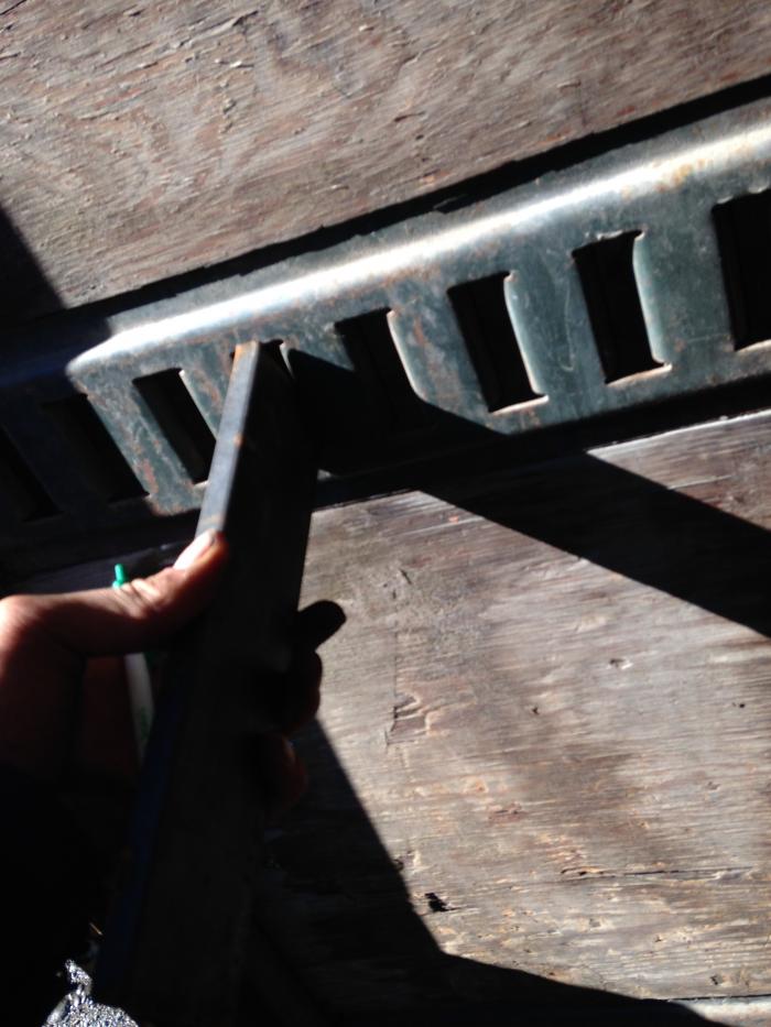

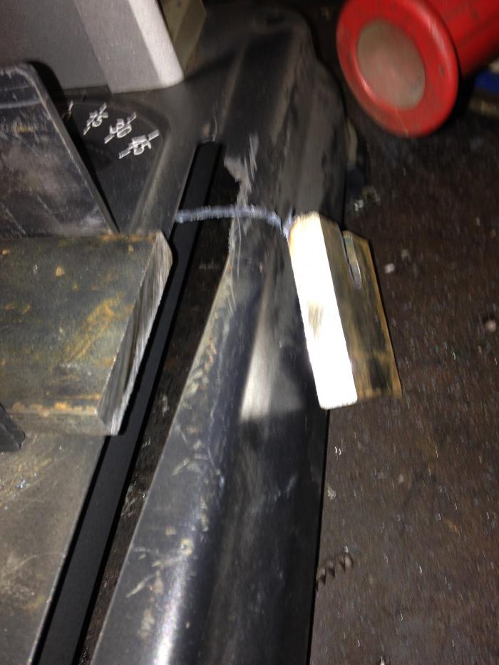

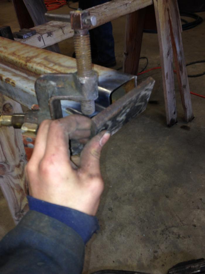

Making some of these little "pad eye-hooks"....
Dirty way of doing.
Why rush me??? I get paid by the hour.
Dirty way of doing.

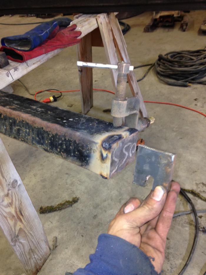

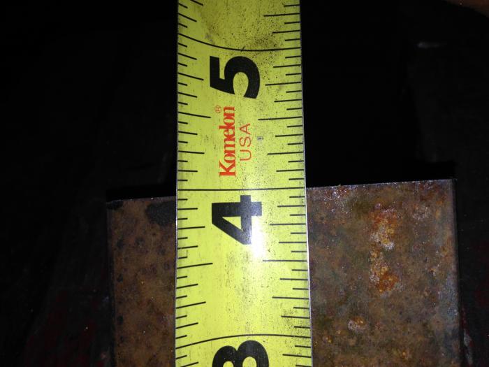

4inch by 3inch, 1/16 wall tubing.
Used what was around.
It'll work.
This pic is 3inch by 3/8 thick flat bar, used to cap the ends of the tubing.
I'm telling you, It'll work.
It'll work.

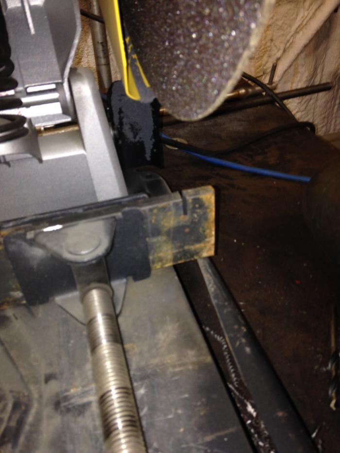

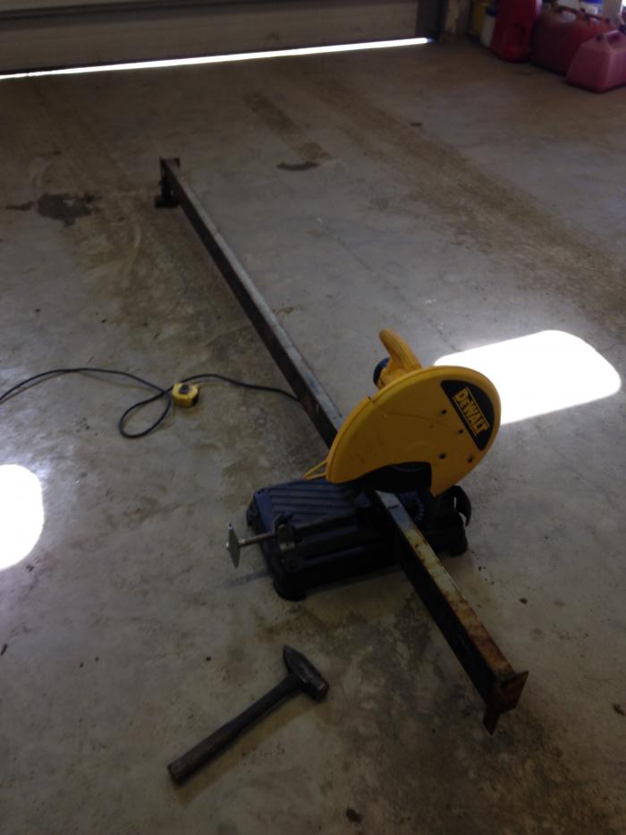

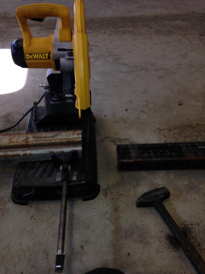

Got them pretty close, 4x3.
Cutting the tubing to make it fit in the truck box....
87 and 3/4 inches.
Love that saw.

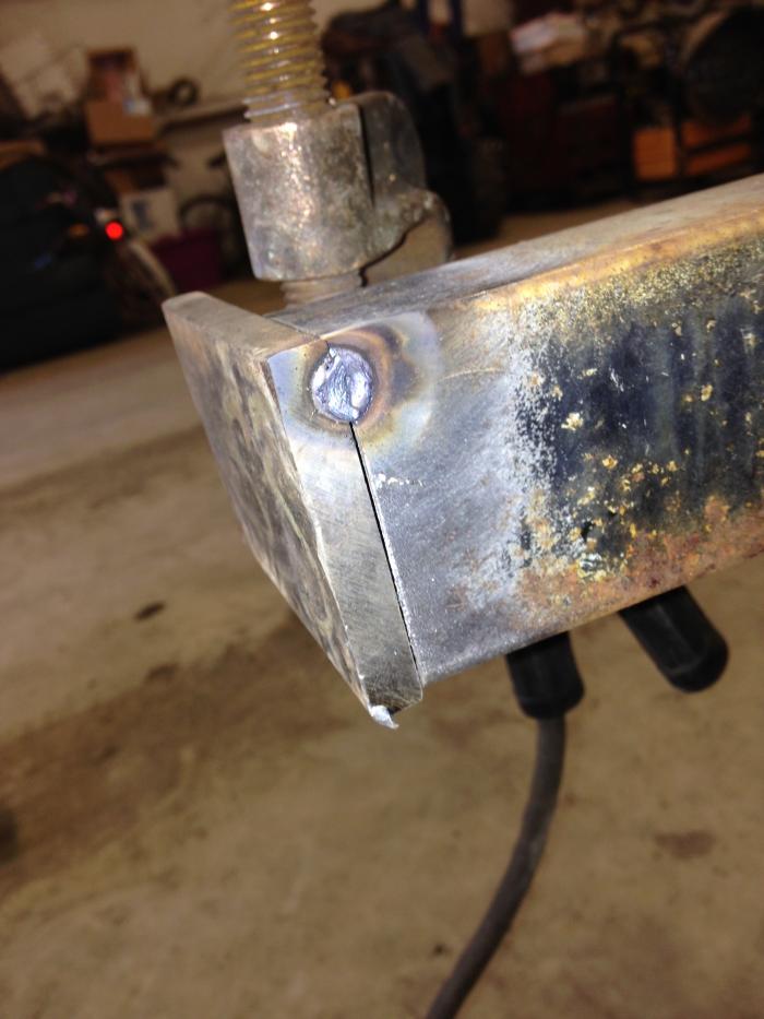

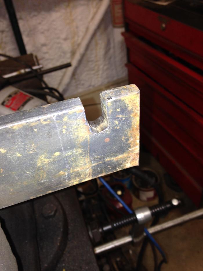

Capping the ends of the tubing.
1/16 wall tubing, to 3/8 flat bar.
1/8 8010 @ 70amps.
Then I'll weld the little "pad-eye-hooks" to the cap plate.
1/8 8010 @ 70amps.

Dead nuts square!!!
I mean square.
Now the hard part, welding.
Are you sure you want to see this???
Tacked the hooks on, and checked it for fit....
I mean square.

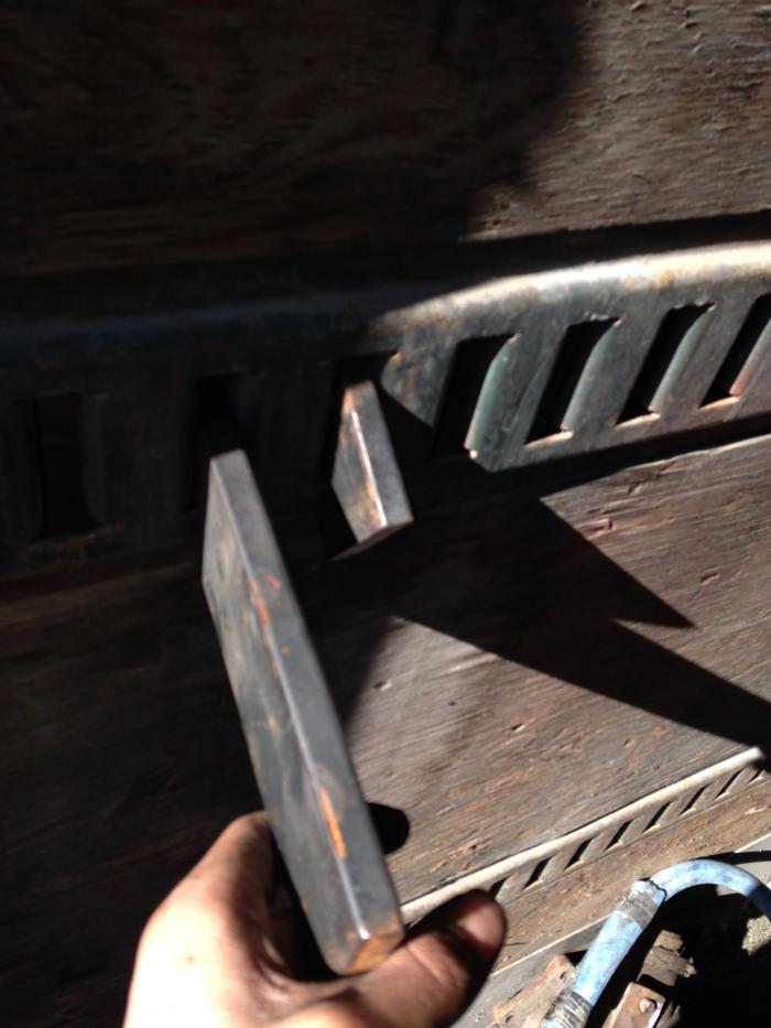

The shelf in the tubing is for the plywood, when I get the other one in.
This box is 20ft.
I have 3 other 40ft ones to do, little bit different....
These connex's are full of engine parts ETC!!!!!
It is begging for shelves, lots of wasted space.
Gonna be taking a while, its a part time job, I work on it when I have time.

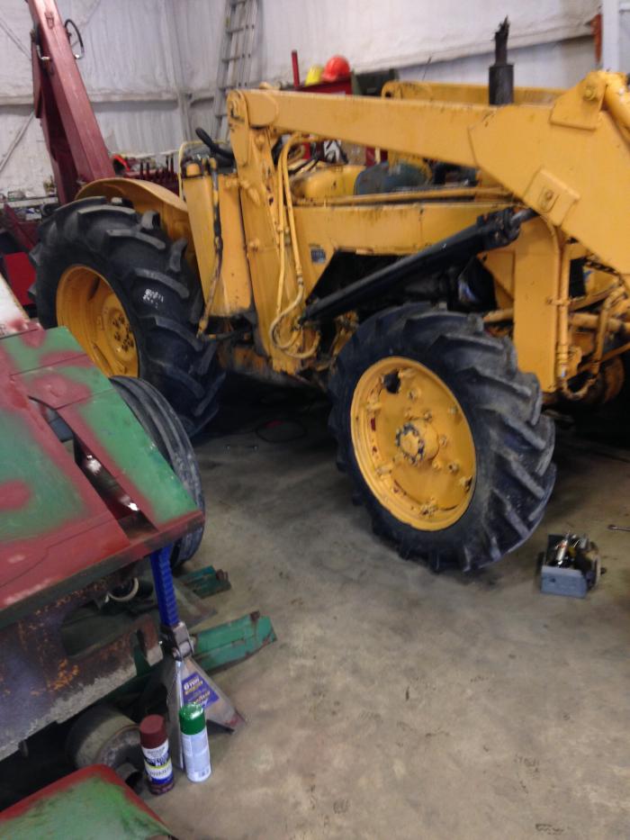

It's a 50s Ford Major....ejpoter wrote:IH or ford?
Sent from my DROID RAZR HD using Tapatalk
It has some problems.
I'll get some pics of them.
~John
Unusual to have 4wd - is that a conversion or a factory fit by whoever built the loader - not seen one quite like it - " Roadless " amongst others sold a 4wd kit here - fairly rare now as most were exported to " bongo" land many years ago - they fetch good money now if you can find one & a clean 5000 or 7000 makes silly money - first tractor I drove regularly was a super Major - real luxury with electric start after the petrol / TVO high major ( E27N )
It's a special model.
Got a Shawnee loader system on it.
Had a bad knock, I never heard, but the guy said it so bad, we shouldn't start it.
So, took the oil pan off....took a whole day to get it off.... Nothing...
Two bolts, and the valve cover was off.
Look and behold!!! One of the valve springs was compressed and stuck down.
So.....
I'll be working on it tomorrow.
-John
